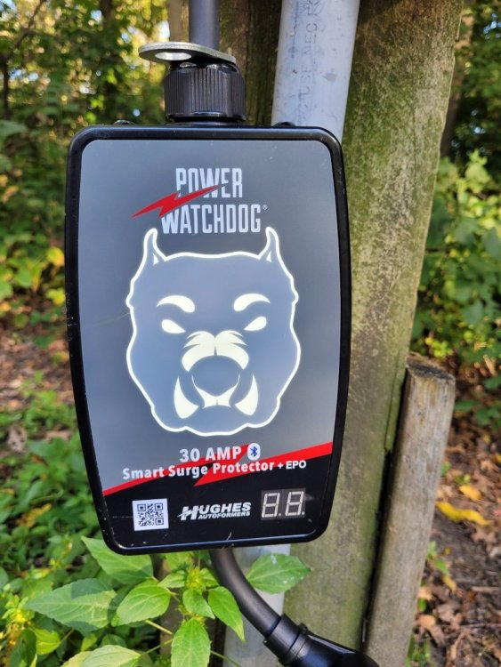

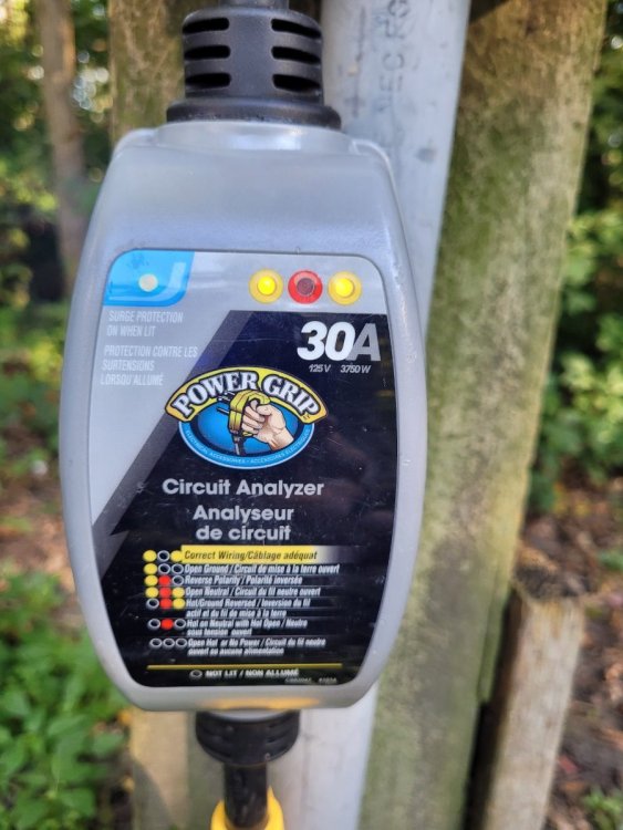

 Update on no 120v.
Stopped at a different State Park that did not have GFCI breakers and the 120v to the Oliver worked fine. This is good.
But drove on to another State Park for the night and it had a GFCI breaker and again the breaker would trip; so no 120v to the Oliver tonight.
I used both of my surge protecters to test the campsite electric for bad wiring and both showed good wiring. (See attached photos.)
So...there is something wrong with the Oliver. Disappointing to say the least; will talk tomorrow.
Thanks for your help.
