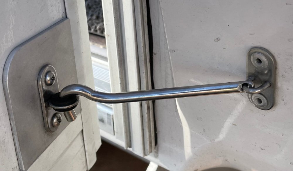

Replaced grommets in door hooks.
Found at Ace HW and Lowes in the nut bins sector he store.
Specs:
Hook itself is 1/4” dia
Bracket Hole size 1/2”
Grommet hole 5/16”
grommet is 1/4” thick
D1DB10A3-70B1-43B4-B6AD-4CF2EC321680.thumb.jpeg.289504edb9739ec086661c97c69d0c6c.jpeg3653F005-9314-4609-96C9-2FE48ABC77E4.thumb.jpeg.70f9a41a0896c1c0c94cd7ced2d84be9.jpeg

On my 2016 Ollie the grommet located on the body of the Ollie is a different size versus the one on the door.
I always carry a couple of spares in both sizes with me as they seem to need replacement about every other year.

Great to know, I just received 2 grommets from Oliver. I’m still in warranty .  The one on the door split
