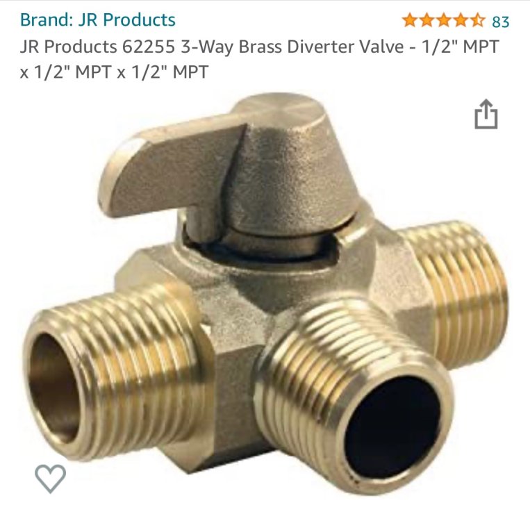

SNY SD UP Posted December 4, 2022 Posted December 4, 2022 It is a brass angle stop knob. Because it is brass, I believe it may have something to do with a "Gas valve". It was on the (curb-side/under bed) floor next to the fresh water drain valve. I looked/felt around the WH and the HTR but did not see where it might go. Has anyone seen this before and do you know where it should be located? Thank You, B Out Maggie & Bryan | Arnegard, ND | 2020 LE II "Twins" Hull #665 | 2021 RAM 2500 6.4L HEMI Gasser 4dr 6.5' bed
Frank C Posted December 4, 2022 Posted December 4, 2022 It’s the lever from your hot water heater bypass valve. Normally located on the back side of the hot water heater. JR Products 62255 3-Way Brass Diverter Valve - 1/2" MPT x 1/2" MPT x 1/2" MPT https://a.co/d/01O5kMI 1 4
SNY SD UP Posted December 4, 2022 Author Posted December 4, 2022 Great & Thank You. I will go and try to re-attach it ASAP. needs an allen wrench to snug it up. 1 Maggie & Bryan | Arnegard, ND | 2020 LE II "Twins" Hull #665 | 2021 RAM 2500 6.4L HEMI Gasser 4dr 6.5' bed
Rivernerd Posted December 5, 2022 Posted December 5, 2022 2 hours ago, SNY SD UP said: I will go and try to re-attach it ASAP. needs an allen wrench to snug it up. Torque the set screw as tightly as you can. Mine was not properly torqued at the factory, and so came off during our 2000+ mile drive home to Idaho a couple of weeks ago. 1 Hull #1291 Central Idaho 2022 Elite II Tow Vehicle: 2019 Tundra Double Cab 4x4, 5.7L with tow package
