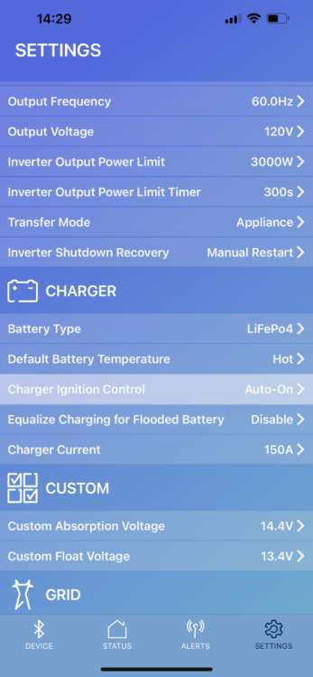

Hello,
I have an LE2 with lithium batteries. I use a Honda EU2200i to run everything the Dometic AC, HW, and anything else.....but not all at once.
One method I use is the Xantrex iphone app to change the battery charging rate to 10 amps or so...any low value that does not exceed the total amps of the generator plus the AC. It's all about understanding the amp load vs the amps available (from the generator or from any other power source...house plug in, etc).
You can also go into the xantrax app and turn the charger ignition control to "auto on" which will effectively disable the charger.  Doing this is also good for the health of your lithium batteries as they really don't like to sit on a float charge for extended periods.
John
John and Kim
Thanks for all that replied.  I was able to download the Xantrex app and set the "charger current" to 10 amps and was able to power up the AC using the Honda 2000 watt generator.  This is a big deal since I don't have to carry the heavy Honda 3000 on trips anymore.
