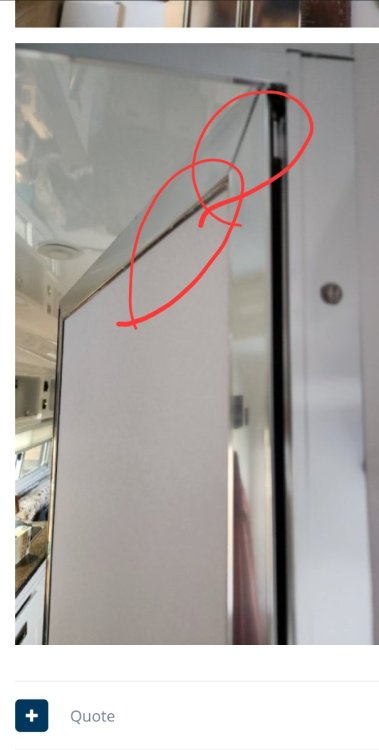

Thanks all. The trailer is as level as it's going to get and we're parked for a while.  The hinge seems to be a single pin that runs the length of the door.  Pics attached

That's more than just a little bit of sag......
You may want to check in with the Mother Ship Service Guru (Jason).  I suspect he has seen it before.

 That's a big sag. Also appears to be a gap in the frame corners of the door. Have you measured the diagonals? On frame, door, raw opening?
And, some sag in the frame/glass.
You're obviously way out of square. That long hinge is called a piano hinge. How did you reattach the door? The right upper looks square from your first photo, but what about the others? And the door?
I would measure everything,  also check with a little speed square, and , def, open a service ticket.
