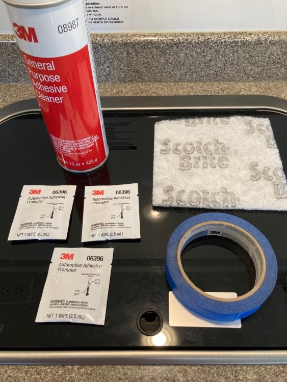

For fiberglass  preparation, ordered  3M adhesive cleaner, 3M White Scotch-Brite pad, and 3M adhesion promoter from Amazon as mentioned by JD & Dave Phelps.
  • 3 weeks later...
Used ideas from previous post in this thread, Thanks!
Removed old adhesive with 3M adhesive cleaner. Placed blue painter’s tape along top line to guide where new belly band will be placed. Rubbed 3M White Scotch-Brite pad over areas where belly band 3M adhesive strips will contact. Applied 3M adhesion promoter with outside air temperature between 60F and 80F as per 3M instructions. Wore a respirator while using adhesive remover and adhesion promoter.
The new belly band is shipped rolled with chrome on outside of roll in an opposite bend direction when applied to the two corners of an Oliver. The day before installation, rolled the belly band with adhesive strips outward in a 3’ diameter roll for overnight at 70 to 80F to get rid of opposite band bend memory to make it adhere better in the corners.
The installation went well and should  not have any  future “Belly Band Sadness”! 🙂
IMG_1885.thumb.jpeg.d4e876b720843769f53162edb928e6cd.jpegIMG_1888.thumb.jpeg.35e8ce58322201dde9b854dd68b6fd4e.jpeg
