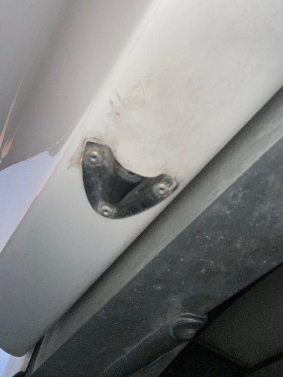

Frank C Posted June 4, 2023 Posted June 4, 2023 Your outer hull should have multiple small metal scupper drains on the underside (see photo) at each lower corner of the hull. These will allow water from leaks or condensation to drain, but it’s better to avoid any water getting in between the hulls in the first place. A seal under the compost toilet would be a good idea. 1
nrvale0 Posted June 4, 2023 Author Posted June 4, 2023 I didn't realize that's what those were! I did find a little drain -- I guess that's the other side of the "scupper" you mention -- under the North dinette seat but that whole area doesn't really look like its designed to be handle any sort of *real* moisture. To your point. Sort of a surprising design honestly. I guess I'll check to see if the hardware store has some sort of plug that might fight in that hole without making it really hard to remount the composter. Thx!
nrvale0 Posted June 4, 2023 Author Posted June 4, 2023 I have some left-over silicon mat from another project and I'm going to cut a piece to cover that hole for when I reinstall the composter.
