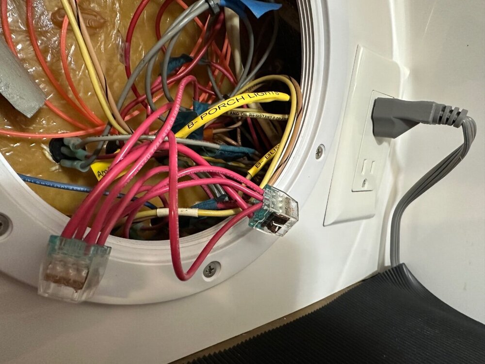

11 hours ago, Snackchaser said:
The load side wire from the porch switch disappears into the wall behind the switch panel in a tightly tangled mass of wires and junctions that are stuffed into a space too small.
FYI
IMG_4570.thumb.jpeg.6ad00f17236df884d3a83c218db808c4.jpegMossey

Solved!  I did some more extensive probing and found the elusive street side porch wire.  This thread was pretty long so I decided to start a new one for how to add a second porch light switch, please see the new post titled “How to add a second switch for the street side porch lights. . . finally”
Thanks Mossey for that photo of the porch ground wire.  I love the collective wisdom and ideas in this forum, and that picture it’s what started me on the right path!
