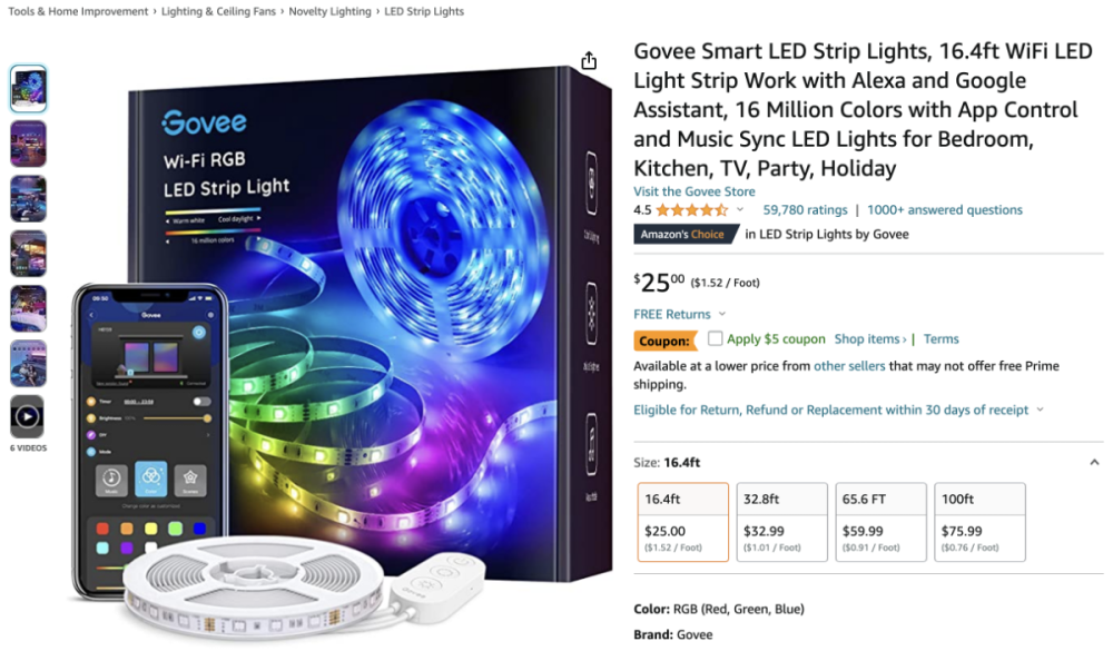

I've found a solution that's made her very happy and add's color and both manual and bluetooth control.
Here's the we've been using.  (See Link near bottom of this article for Amazon item.)
The strip of LED lights are controlled either by the switches in the cord or via the bluetooth connected phone app.
The flat ribbon is a perfect fit on the back side of the Oliver window frames, and don't interfere with attaching or detaching the window frames.
I would suggest getting the phone app, and then testing the light string before installation.
Once you see that the lights are working then prep for the install by unplugging the controls from the light string.
