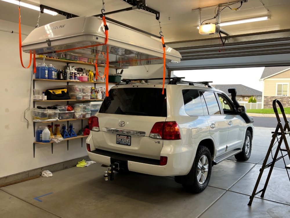

John E Davies Posted September 13, 2023 Share Posted September 13, 2023 13 hours ago, Wandering Sagebrush said: The kayak lift was also 4 point, with straps under the kayak. It was a strap that let go. Hardware was all Harken (sailboat rigging). I use a Hobie 16 main sheet tackle (Harken) to suspend a 50 pound Yakima box, no worries at all and it looks cool with blue line, but I would not trust any rope setup with a 250 pound canopy. This works great for 170 pounds of Maggiolina RTT plus steel crossbars. It is rated for 250 pounds. https://www.amazon.com/Racor-PHL-1R-HeavyLift-4-Foot-Cable-Lifted/dp/B0009I8AO6/ref=sr_1_1?m=A2EJCTH67GJMT3&s=merchant-items&ie=UTF8&qid=1542837300 It is discontinued but still available for a while. Buy 2! $49! I have no idea about shipping, the box is not big but it is pretty heavy. I bought mine new in box on Craigslist for $120… https://www.classicdiscountstore.shop/products/racor-ceiling-storage-lift-phl-1r I used the two spreader bars but not the actual platform. I also tossed the ceiling attach hardware ( tiny screws), drilled out the 8 holes, and used 1/4” lag bolts going directly into studs. Once lifted for the off season, criss cross the cargo with 1” nylon straps. Those go into FORGED closed eye 3/8” eyebolts in studs. Open eyed bolts could, well, open if a heavy load is dropped onto them suddenly. Probably overkill, but I sleep a lot better knowing a $5k tent is not going to drop onto a $40 k Land Cruiser…. This is temporary strapping for short term, I was reworking the attach hardware… and needed the truck bars out of the way. Normally the bars will stay attached all the time. John Davies Spokane WA 1 1 SOLD 07/23 "Mouse": 2017 Legacy Elite II Two Beds, Hull Number 218, See my HOW TO threads: Tow Vehicle: 2013 Land Cruiser 200, 32” LT tires, airbags, Safari snorkel, Maggiolina Grand Tour 360 Carbon RTT. Link to comment Share on other sites More sharing options...
