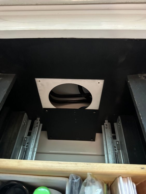

All of the cigarette and USB ports that I have seen have a nylon retaining nut which match’s the threaded body of the device.  You can remove the drawer and locate an access panel.  Remove 4 screws and you should be able to put the retaining nut back in place.

The panel that closes off the back ~3" of the drawer cavity in my Ollie has a black access panel that covers a 6"hole.  The attached picture shows the access panel resting upright on the deck above the basement area.  It also shows the access hole which I can reach through and touch the back of the 120V receptacle as well as both of the 12v ports.
