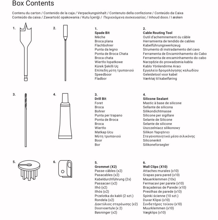

That’s a Starlink Short Wall Mount that you have to buy extra ($60) via the “SHOP” button on the Starlink app, As is the Cable Routing Kit ($32 — which I incorrectly called the House Mounting Kit) which includes two grommets (which I incorrectly called the Starlink Plug) and the correct size paddle bit as well as some other stuff.
You can also buy a 150 foot cable ($130) through the “SHOP” button on the app instead of using the 75’ cable that comes with the Starlink. You will have plenty of room to coil up 150’ of cable inside the spare tire. When I get the fiberglass work done making a cable holder  on the inside of the tire cover my plan is for it to be large enough to accommodate the longer cable just in case I decide I want to use one in the future

Here’s a picture of what’s included in the Cable Routing Kit
