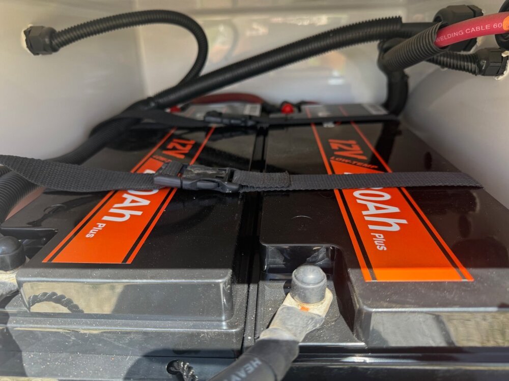

Hi all and thank you all for the good advice in getting a professional to put them in for me. I could easily have dropped a battery. Yiks and then got burned with battery acid ! I just picked my Ollie up from my local trailer place (it is actually a horse trailer repair place I use but same principles) and got the new 2X 230Ah batteries installed. They fit perfectly in the battery tray. Very pleased! -

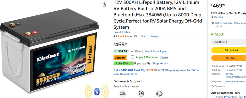

Yip this seems to be a good option. Amazon has them on Spring sale.. JD and all how many of these batteries did you get to in the Olly battery storage compartment? It loos like I can only fit 2 batteries It seems like a lot of batteries come with a Blu tooth options. How would this be useful? -

or there is the one that JD recommends. Too many choices. I think I could 4 of these in the battery compartmne to replace the 4X6V oned that are there. I amy need to buy some new connector cables. -

I beleive I have the right XC Xantrex Freedom Inverter 2000 watts. Amazon has this lithium ion on sale. I dont believe living in Texas I need a heated battery -

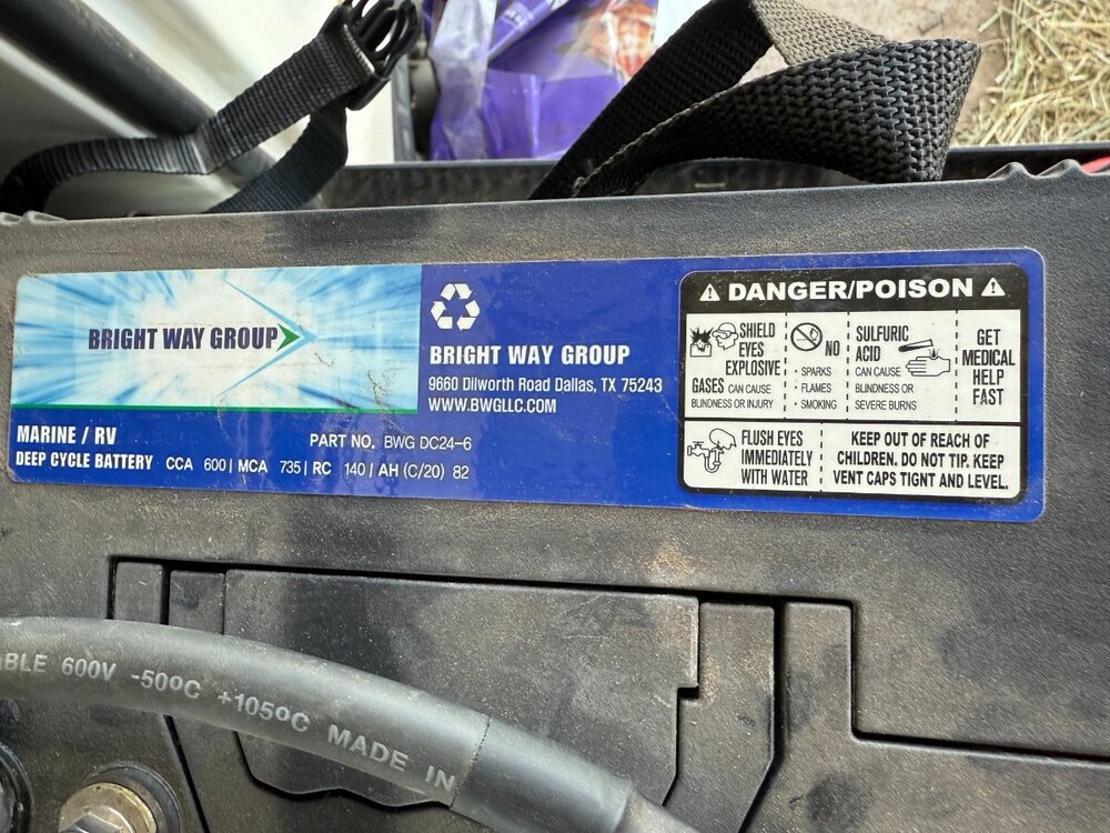

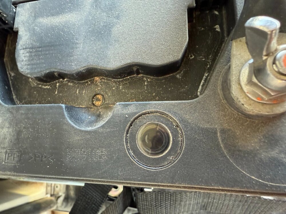

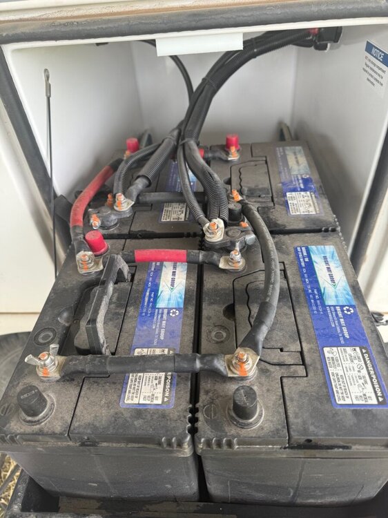

Hi all, Imelda (Hull 642 elite2) again. I need some advice on my 6V battery (see pics below) . They are about 5 years old and not holding charge over night. For some reason I though these were maintance free batteries but I now thinking I should have been topping them up with DI water and pouring the water through the clear plastic round plug. One question how do I top the batteries up if it is not too late and they are already damaged and how do I remove this plug? Second question is: does anyone have 6V battery replacement rcommendations if I have to replace these batteries? I called the Bright Way Group and these batteries are discontinued.
Thank you all. I am going to try these suggestions and I will keep you posted. Imelda

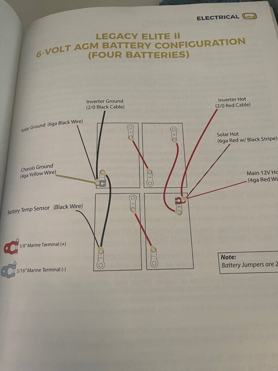

Update to my battery situation. I was having a hard time getting batteries to charge and hold a charge. The previous night I was hooked up to shore power and now the batteries are doing great. holding 12.9V off shore (boon docking), refrigerator is doing great running on propane and no C (low battery error). The batteries seemed to have healed themselves. The batteries are the 6 Volt AGM batteries, four of them. see diagram below I have no experience with batteries but is it possible they got down so low that they could not fully charge with solar or hooked to the truck charge and they needed full up 120V 30A charge to remedy them? Anyone have similar experience? My 2000W inverter has a shut off set about 12.1V so I need to figure how to set it to a lower voltage. It would-be nice to run the microwave for a minute or two to reheat my coffee. I have purchased a Jackery 1500 that I love that can run the microwave, air fryer etc. but it would be nice to use the inverter that I paid for. jd1923 or anyone how do I change the battery shut of voltage lower than 12.1V? Right now I can 30 secs of microwave before it shuts off. Is there a youtube somewhere?
