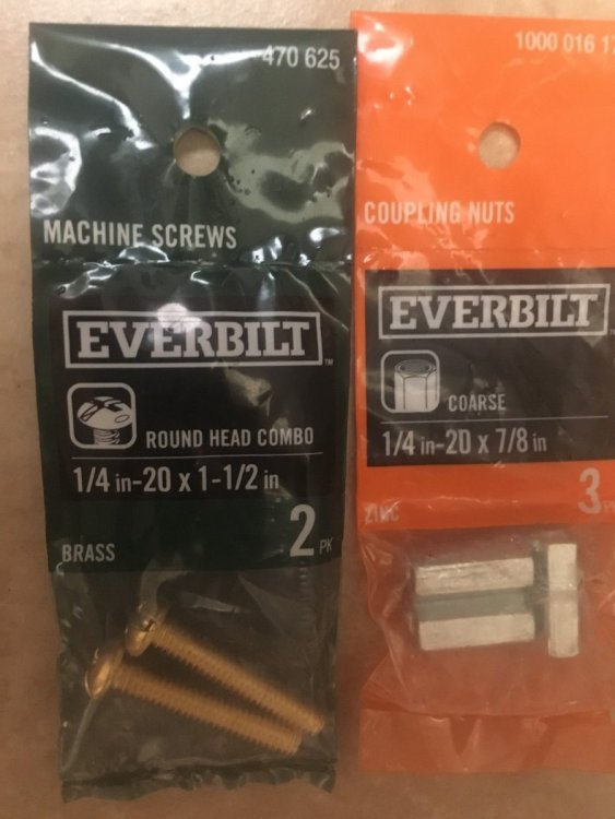

All I did to the brass screw was drill it hollow, I didn't grind or taper the end of it. I tried to video myself doing it, but I ended up needing both hands, so only got 20 seconds of footage. As you can see, I just put it in a coupling nut and slowly drilled it out. I ruined the first bolt when I attempted it, but got it right on the second bolt. The only reason I used brass is because it's a soft metal and was very easy for a drill bit to cut through. If I remember correctly, my drill bit wasn't long enough to go through from one side, so after bottoming out the drill bit, I flipped the screw and drilled from the bottom, and I got lucky and the two holes met decently well. I bought 4 brass bolts because I anticipated screwing a few up.

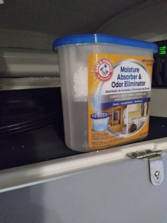

I meant to give an update sooner, but life got crazy like usual. Leaving the cabinets open seemed to stop condensation inside the light fixture; however, it should be noted that was without anyone sleeping inside the trailer. We also had some rain recently, and I did not observe any leaks either. To confirm there were no leaks, I left out paper towels and I also removed the rear driver's side speaker. This allowed me to access the area between the attic and my troublesome storage area; no moisture detected. I'm therefore pretty confident there are no leaks, at least from the rear Oliver light. I won't get a chance to camp in the trailer until the end of February, so till then I won't know of my condensation problem is completely resolved, but till then, it's looking promising! Thanks everyone for your help! I'll update again after we go camping next month.

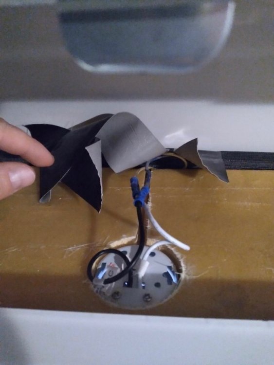

Will do on the blue shop towel below the third tail light in the attic, its definitely worth checking.

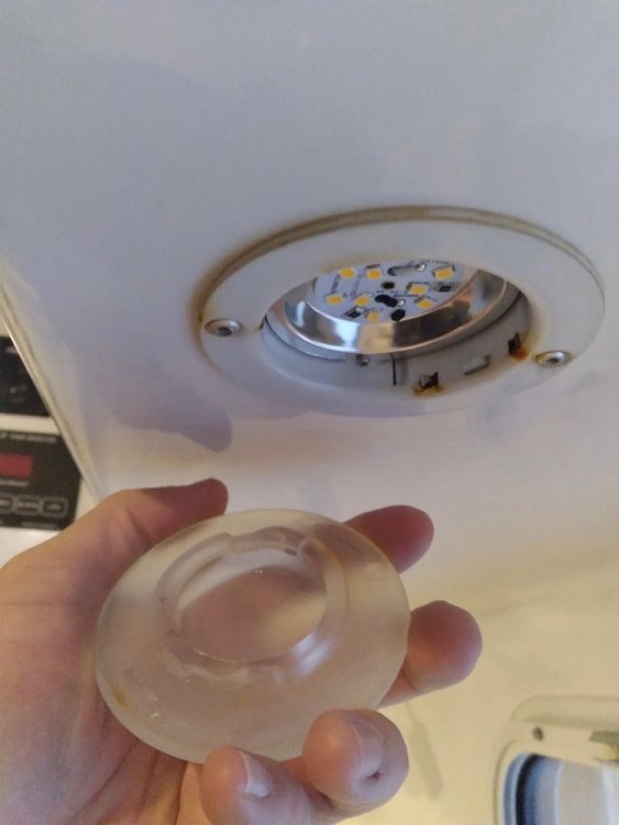

This problem only started near the beginning of 2022, and a year later, I still can't figure it out. I get condensation build up inside of the driver's rear light fixture; right above my head when I sleep. You can see the rust spots inside of the light. The glass dish/cover will fill with water/condensation and then drip out. At first I thought it was because that's right where my head was breathing towards; however, I haven't slept in my trailer in a few months, but everytime I hang out in it, I get the same condensation in the same light fixture. I put a plastic container of Arm & Hammer Moisture Absorber, but after a couple of weeks, it's dry. I altered the placement of the moisture absorber to different locations, but all condensation still goes to the same light fixture. I know it's not a leak because it occurs in dry weather and rainy, and because I inspected the cabinet with the wires that feeds the electricity to that light fixture. The channel the wires run through in the fiberglass is bone dry. I put multiple q-tips in there but don't show any moisture indicative of a leak coming from anywhere else, or condensation following a path to that location. In short, I'm stumped why condensation is only attracted to that particular light fixture.
