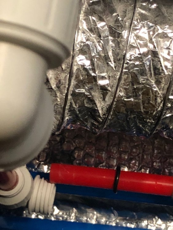

Hi Everyone! In the past, I've seen talk in the threads regarding the low flow from the furnace to the bath vent, well, I experienced that too. Here's what I found after a little detective work... Well no wonder! It helps when you connect the duct together. Yes, it was never connected, no wonder I only felt a very faint breeze from the bath vent. This shot was taken looking toward the kitchen sink, directly under the galley sink. The only way I could access this was to remove the plastic vent cover under the galley sink to connect the duct together. If this had not been possible, then the ONLY way would be to destroy the cabinetry to gain access to it. This was my first view, not touching anything and snapping this photo after I gained access. As you can see in this shot, there is no duct sealant or sheet metal screws, only a lone zip-tie that could not have possibly held this together properly. Notice, I put a plastic bag underneath to get ready to apply duct sealant. This blue tape was on the duct in two locations, possibly to note that this needed to be corrected before this area was closed up? Prepping the floor so I don't get duct sealant all over the place. Here's a look inside through the vent access directly looking at the disconnected furnace vent. The proper solution... three (3) sheet metal screws to follow. Keeping it neat and clean and getting a good bond. All dry, ready for the sheet metal screws... Due to the extreme limited space and only able to work with one hand, I had to tape the screws to the vent and use a hand driver to get the three sheet metal screws in the vent. It was impossible to access the other side however this is more than sufficient, especially with a generous application of the duct sealant and what is to follow... Ah yes, after the duct sealant completely dried and three sheet metal screws, I wrapped the joint with real duct tape and finished it with a fresh zip-tie to complete the surgery. And there you have it ladies and gentlemen... mission accomplished! I later purchased some inserts for the vent ducts that allow me to open and close the amount of flow that I want from the furnace in the bath. I simply adjust the two in the galley to my desired comfort and I'm a warm, happy camper! BTW, the awesome folks at Oliver Travel Trailers were very kind and reimbursed me for the materials, so we're both delighted with the result! For anyone experiencing low/no flow to their bath, this is the very first place I would look. Simply remove the vent cover under the galley sink, carefully disconnect the duct and see if your distribution tee is properly connected. If it is, I would strongly recommend the adjustable registers that can be purchased for these vents, my Ollie did not come with them. You only need two (2) for the sink vent and the bed vent. They are approx. $10 ea. When I run my furnace, I adjust them and can get a good flow of warm air in the bath. Problem solved!

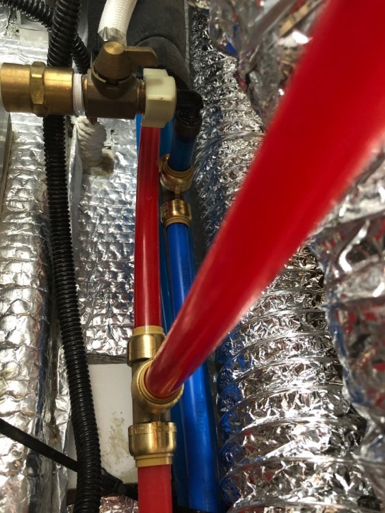

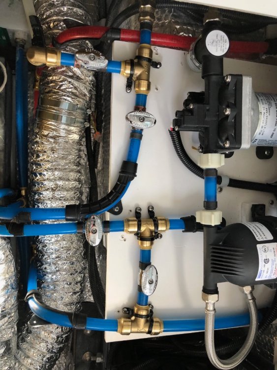

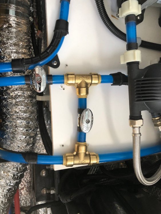

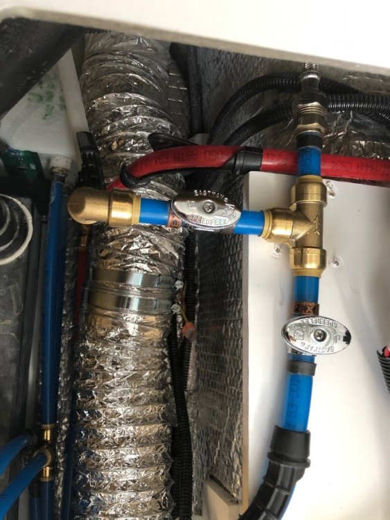

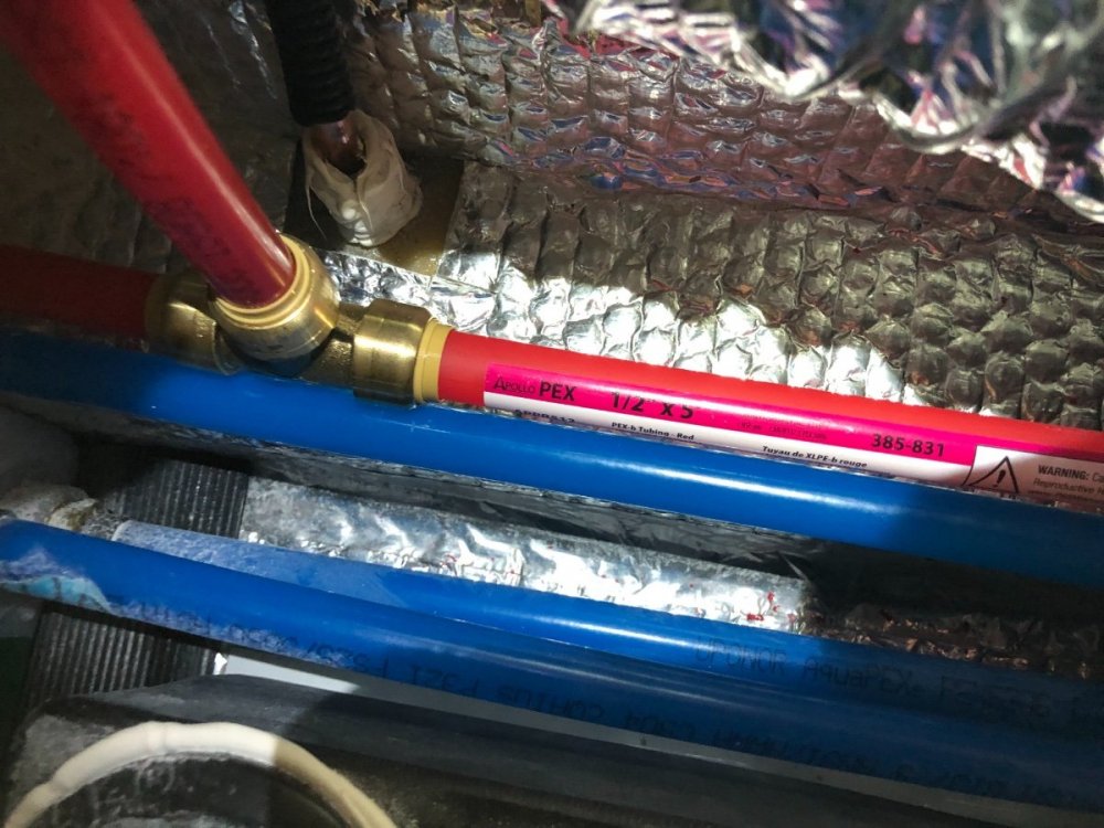

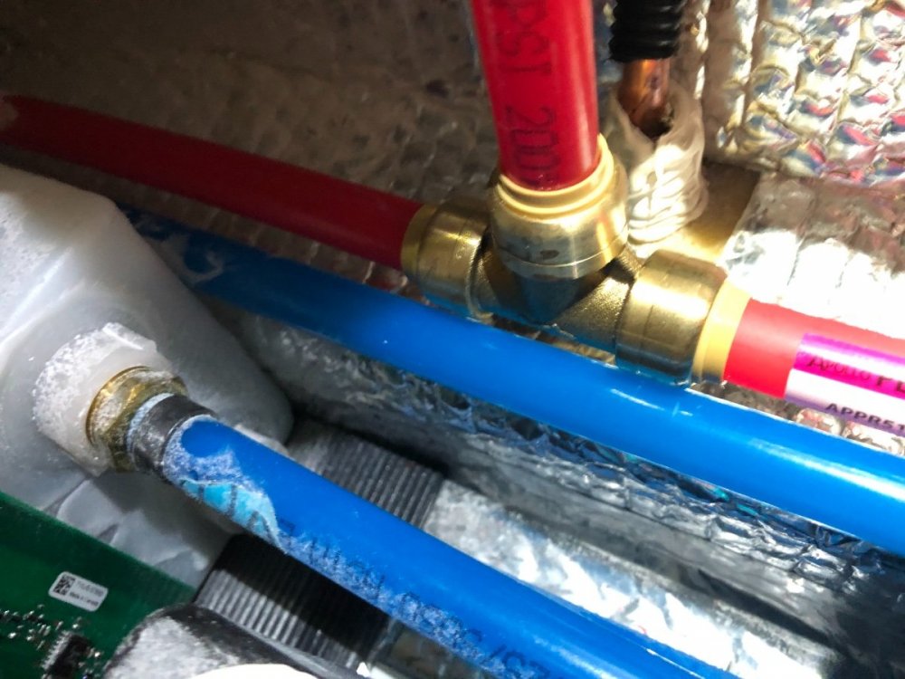

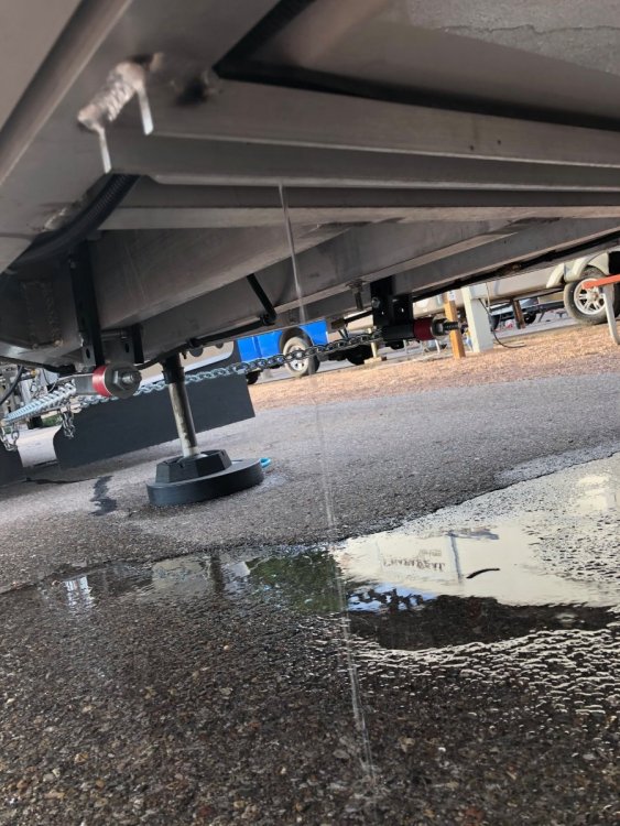

Hi everyone! I wanted to share a plumbing episode that I experienced in Albuquerque, NM last year (6/2020) after getting it serviced in TN. After two (2) days of driving, I hooked up my WPS (water/power/sewer) connections at a KOA and had a major plumbing issue, or so I thought... After shutting the water off and inspecting under my curbside bed, I found the culprit. It seems that, the offending hot water line to this tee fitting was cut about a half-inch too short when installed at the factory. Mind you, this happened after a few thousand miles on the road and after a few bad miles on I-40 in Oklahoma before this manifested. After understanding just exactly why this happened, I contacted our good friends in the service department and Jason was able to offer some very helpful assistance. Luckily, there was a Home Depot just a few miles down the road and I was able to purchase a longer length of the same hot water line installed on the Ollie and Jason recommended the "SharkBite" brass fittings as a permanent replacement for the plastic ones installed at the factory. This was a quick and easy fix and I have had no problems or worries since. The SharkBite fittings are the best and I decided I didn't ever want an episode like this to happen again, so I later replaced every elbow and tee fitting in my Ollie with the SharkBite brass fittings. The Team at Oliver was great and reimbursed me for all materials for the tee that caused this problem. I came out-of-pocket and did the rest on my own. I highly recommend these fittings and wish they would have used these in the first place. Below are photos of my experience... Nicky Ray
