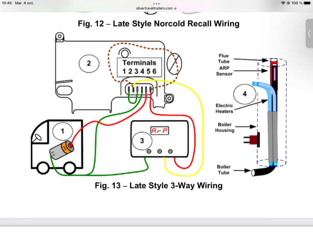

  10. Hi, I would like to know where the 12 volts power source is coming from to power the Norcold fridge. When i take the voltage, outside from the back of the fridge on the main 12 volts source wires ( red and yellow ) i read 12 volts with my voltmeter even if the ac power cord is not connected, the 110v main breaker is open (off), the 110 ac connection on the back of the fridge is disconnected, the 12 v, 20 amp fuse for the fridge is pull out and the switch for the solar is at off position????? i just received my ARP fridge Defend so before starting the installation, i was looking to shut down the 12 volts power for the fridge….. Thanks for yours advices.
  11. Hi, I’m installing the ARP fridge Defend and i need help for the wiring. i’m not connected to short power, i opened (off) the 110 v main breaker and also the fridge breaker and get the 12 v 20 amp fridge fuse out and the switch for the solar charging is opened to (off). When i took the voltage from 12 v source at the fridge control ( outside ) i’m still having 12 volts on my volt meter? Where does the 12 v sources from the black and yellow wires coming from? All my connections are like the electric diagram that i joint in below but when i connected the green wire (ground) from the controler, there is a sound coming from the ARP control? I installed a 5 amp fuse to the red wire and also a 3 amp fuse for the fans wires…… is it possible to get a closer picture of the connections from NCEagle? thanks a lot!
