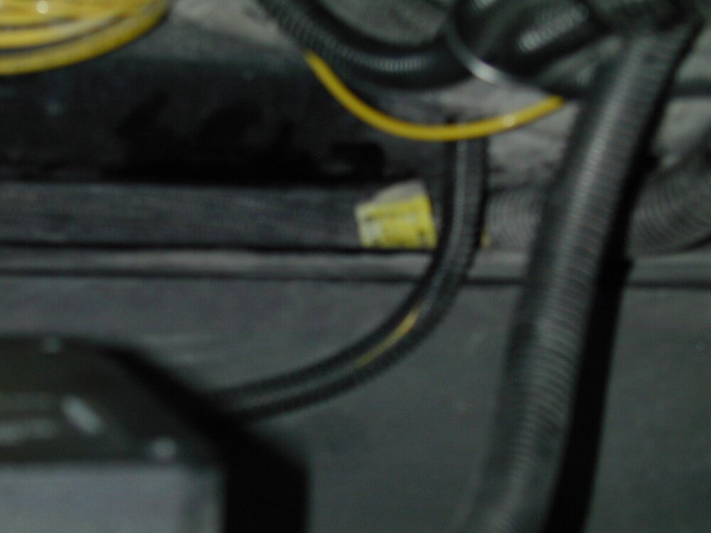

  4. This fuse is under the street side bed and half way up the right side among other wiring hardware. What does this Fuse Protect? What is it called? I am trying to hunt down an obscure reason why my Trailer Brakes are not recognized, when my 2019 Oliver Elite II to my 2016 F350 Diesel. I plug in and when press the F350 Brakes... disconnected. My 2019 Airstream has no issue with the Brake Controller. So it is the Oliver and some wiring issue? Pull the Trailer Disconnect when spinning wheels on either side... they immediately lock up firmly. Insert the Pin and power is disconnected and free wheeling with no effort. Have a Post on Oliver #448 and trying to find the... obscure... problem, but following wiring using a flashlight is the best I can do at the moment.
  5. New 7 Pin Plug, wiring solid, no change. Snug fit and everything worked, but back to hunting down a wire from... the Original Wire Bundle under the Street Side?
  6. At this point... I have run out of WIRES to investigate. Common Sense tells me this could be the Rosetta Stone. If not, a truly Dead End... no Fairy to help after this. (Got a second opinion with Wife, upside down, and noticed that it is attached to a long metal boxy 'container'. Even with the Black and Blue wires... Our combined detective work: Level Meter for one of the tanks: 'GREY' water tank. Even with the wire colors... I am back where I started. )

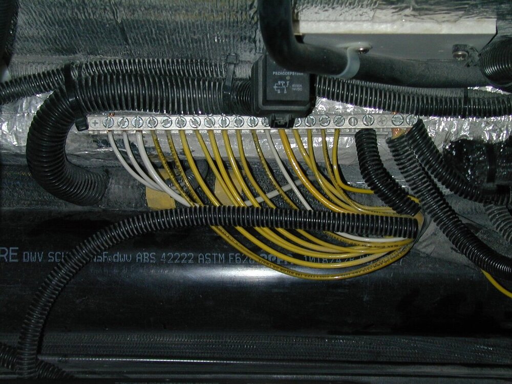

  7. Using the color illustration of the Legacy Elite II Trailer Harness Electrical... the only item up for discussion seems to be the 'Ground Bar'. Is that the bar under the seat with a dozen or so wires? None are labeled. Lots of Yellow Wires. Is this the source for the Brake Grounding attachment? The Brakes have Power when the Break Away Switch is engaged. They lock up immediately. We spin each side and those passed the Rewire... just finished. Someone may have some advice. The connections all seem tight and secure. It there another location once the power leaves the Ground Bar to Brakes? 13 Yellow wires & 4 White wires... from a quick glance. All screws have a wire. One has no screw, but looks threaded on the Right Side of the bar. There are 3 bundles? with the plastic around the wire(s) on the Right side. I did not look if they had one or more wires... any suggestions? The wiring diagram is missing all of this.
