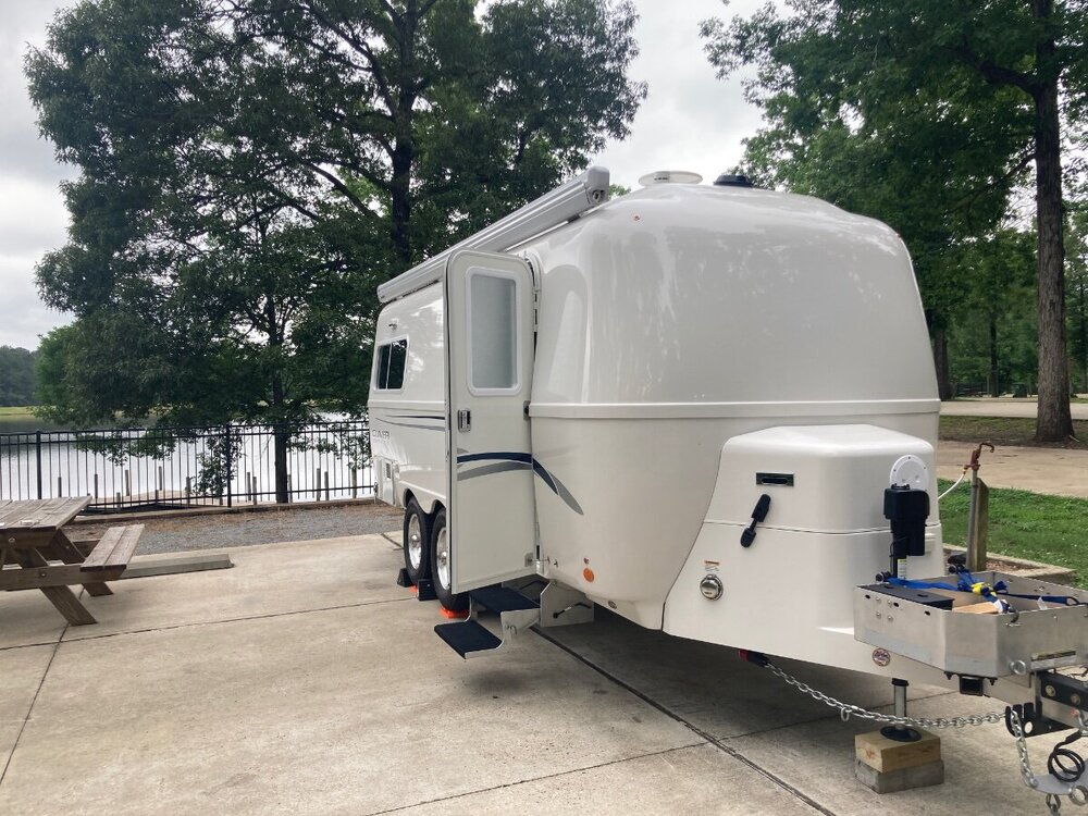

  19. Thank you for the welcomes. Here are a couple pics. First was when we got it home and second it’s a little shinier now after a good polishing. It was stored indoors by 2 previous owners so did not take much to bring out the shine. 2 mods on my list for down the road. Install solar. (All wiring was installed by OTT during build) and replace the Dometic AC.
