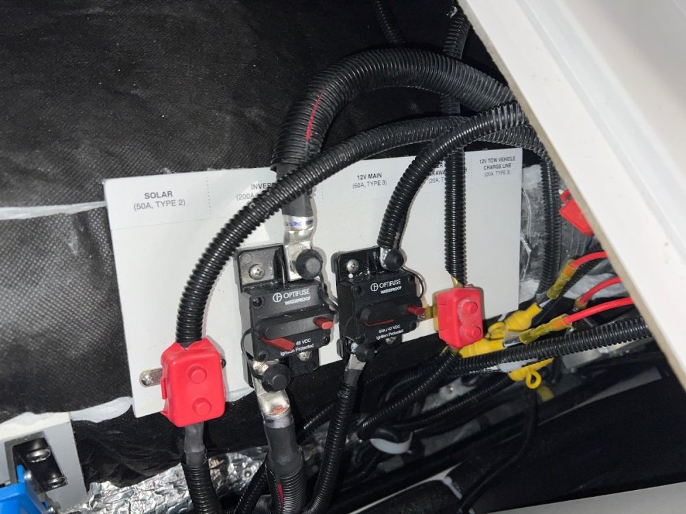

rich.dev Posted April 23, 2024 Posted April 23, 2024 Yes looks like they changed the Inverter disconnect switch from an Optifuse breaker to the same cut off switch you have for the solar panels above the steet side bed. Here’s a pic of the Inverter Optifuse breaker on our 2023 LEII 4 **Sold😞** 2023 Elite II, Hull# 1386, Lithium Platinum Package (640AH, 400W Roof Solar, 3000W Xantrex Inverter), added 400W Renogy Solar suitcase with Victron MPPT 100/30 CC, Truma water heater & AC TV: 2024 Silverado 2500HD 6.6L 10-Speed Allison
SAR Posted April 24, 2024 Author Posted April 24, 2024 Thanks for the pic 2024 E2 | Hull # 1527 |Truma | Lithionics (390Ah) |Compost |2024 Tundra| Airstream | Casita | Escape
