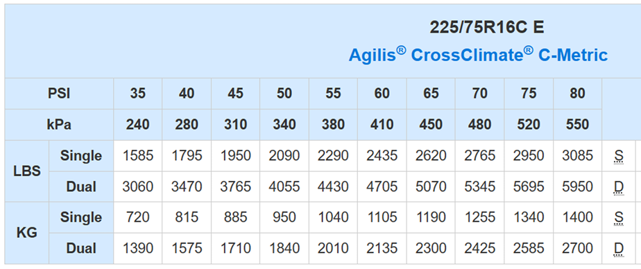

Problem is too many company policies are created by lawyers. OTT is likely worried some of us will load our trailer up to 10K LBS, so they likely factored in a 50% margin in their number.
The rating on the tire is MAX. Tire companies do not suggest running at MAX unless you are running MAX weight. This chart is for the OEM tire brand/model and you can look for a Cooper table, but for the same size tire, Load Range E, they will all be about the same. Notice at 50 PSI on the table the rating is 2090 LBS. We have four (4) single tires (The rows marked "Dual" are for dually TVs and Class-C RVs). Four times 2090 = 8,360 LBS and nobody should load that much stuff into their Ollies! 65 PSI on these tires is for a dual-axle trailer with two 5200 LB axles.
At 40 PSI, 4 of these tires will carry 4 x 1795 = 7180 LBS and the Oliver Elite II has a GTRW of 7,000 LBS. Therefore, if you are not exceeding the GTRW you can run as low as 40 PSI. Most of us add a little margin, but regardless of the OTT company position 60 PSI is WAY too much. In prepping for our last trip, when I check pressures, all 4 tires were between 46 and 48 PSI, so I made them all 46 and did not have to extend the air line from my compressor. The all had just the right amount of bulge at this pressure.
