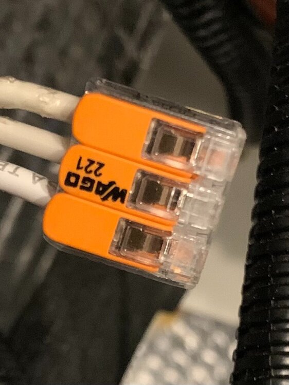

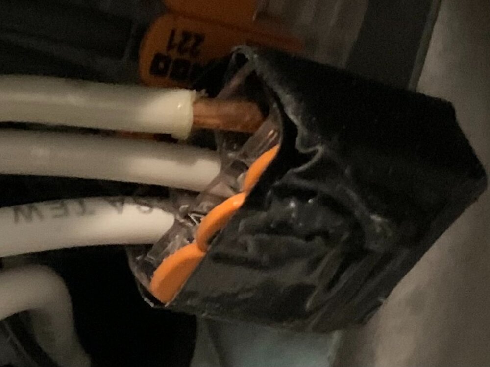

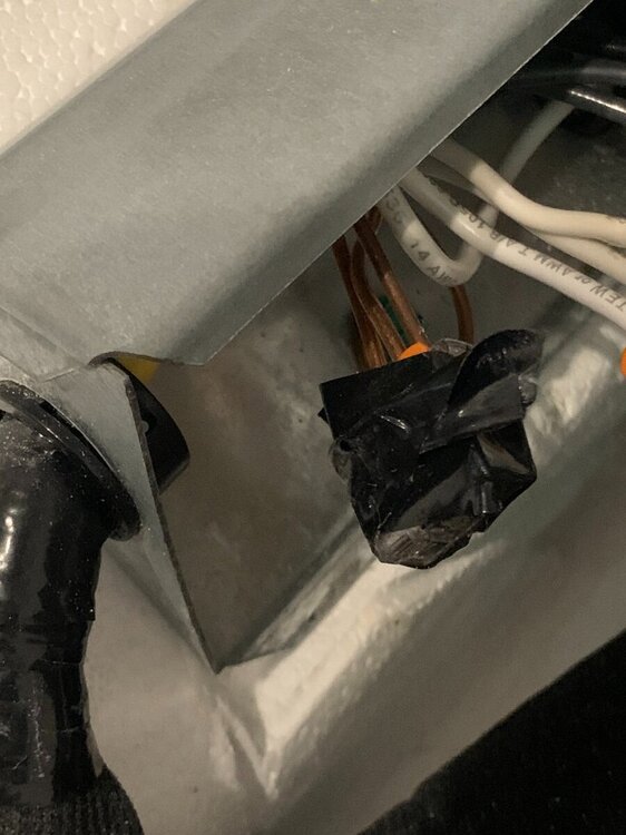

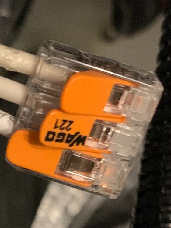

Ron and Phyllis Posted June 20, 2024 Author Posted June 20, 2024 Thanks so much to everyone! Dave and Steph and Dud B particularly. The cause of the dead refrigerator outlet was at the next junction down the circuit at the hot water heater. The Wago lever nuts were rather carelessly taped and a neutral wire had slipped out. I retaped them for now and power was restored. I may very well try a better solution. I see so many positive comments on these Wago connectors, but the levers on these seem so easily opened. I'm very disappointed in the help I received from Oliver technical support. When on a trip I was told to check the breaker wires and then that the outlet might be bad. After these proved to be ok, on my second call I asked where I should check next and were there any junctions in the circuit. I was told, " if it's a 120V problem, you'll have to take it to a service center". That was it, no suggestion. I just don't understand why he didn't tell me to check the next junction that was at the water heater. You guys guided me to the next easy solution. I attached a few photos. Hopefully, it might help someone else. Thanks again! Ron 4

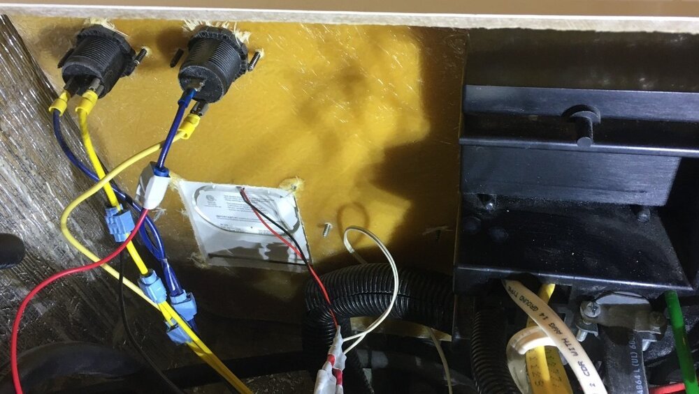

jd1923 Posted June 21, 2024 Posted June 21, 2024 (edited) These Wago connectors and OTT also uses SkotchLok connectors which are both substandard re SAE automotive electrical work. Yes, I tape my household connections too, but many electricians do not. Your house ain't bouncing down the road either. There should be NO connections that require electrical tape to stay closed over time. Whenever I run across inferior connections, I will replace with hard crimps or a simple bus with bolted connections, and solder light gauge wires. Check out this photo. I would have already changed these but bigger fish to fry and there's nothing critical in a hardly used USB outlet. Just shows poor installation/lack of design (although in this case, the SkotchLoks could be from a replacement CO sensor). I have seen these connectors elsewhere and they have no business in critical automotive or RV systems. Been working on many repairs and upgrades this summer, so give me 20 minutes and I will fix this too! I hope ours is not like the others here since we have separate fridge and HWH breaker circuits. Thank you for bringing this to our attention! Edited June 21, 2024 by jd1923 added pic Chris & John in Prescott, AZ | 2016 EII #113 | '01 Ram 2500 Cummins!
