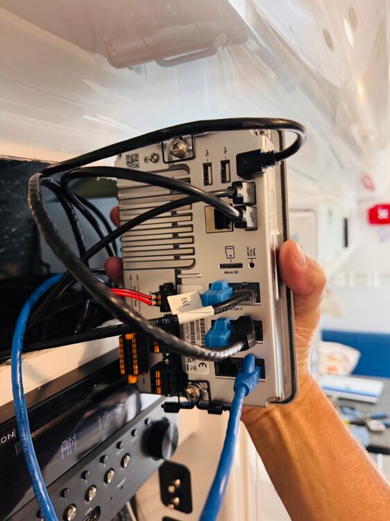

rideadeuce Posted June 25, 2024 Posted June 25, 2024 Pretty simple setup if you have a Victron system. I got the new SeeLevel display that has extra 4 pin connection for sending information to the Ekrano/Cerbo from https://www.vanlifeoutfitters.com/store/seelevel-709-n2k-pm-tank-monitor-kit-for-cerbo-gx/ You do not need new tank sensors. 2 4 - Mike Brentwood, TN - 2018 Elite II - Spirit of Adventure Hull #308 - 2016 Toyota Tundra Limited 5.7L Class IV hitch with 12k lb coupler, Weigh safe adjustable trailer hitch, Dobinsons HD 2in Leaf springs, Timbren bump stops, Dobinsons 3in coilovers and UCAs, Mechman 370 amp HO alternator. Oliver upgrades: Starlink, Cradlepoint cellular modem, Victron Multiplus II 12V 3000W, Ekrano display, Orion XS 50amp DC/DC charger with Anderson connections, Toshiba 6-in-1 Microwave oven - air fryer combo, Atmos 4.4 15k AC/12K Heat pump, Nova Kool 5810 fridge, Epoch 460aH x2, 520 watts solar on top, Custom aluminum bicycle rack, Alcan Springs, Bulldog shocks, Falken H/T02 tires, Seabiscuit Metal Designs front storage box and moose rack.

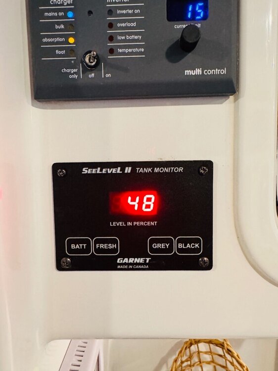

katanapilot Posted Monday at 08:27 PM Posted Monday at 08:27 PM Reviving a bit of an older thread as I am installing this same panel now. Does anyone have the part number of the three way switch located in the bath that operates the water pump? As this newer SeeLevel panel does not have a pump switch, I need to replace the one in the current SeeLevel panel that I am removing. 2020 Elite II Hull #628, Houghton Heat Pump, Victron MP2, SmartSolar, Orion, Cerbo, Lynx install in progress... TV - 2011 Toyota Tundra Crew Max Platinum 4WD, Magnuson Supercharger, OME suspension, Wilwood front and rear brakes
Snackchaser Posted Monday at 09:08 PM Posted Monday at 09:08 PM That would be a "Single Pole Double Throw" (SPDT) switch. I buy my switches from DigiKey company, PN CH876-ND. If you message me privately, I can send you an extra one I have. 1 1
katanapilot Posted 16 hours ago Posted 16 hours ago 16 hours ago, Snackchaser said: That would be a "Single Pole Double Throw" (SPDT) switch. I buy my switches from DigiKey company, PN CH876-ND. If you message me privately, I can send you an extra one I have. Thanks so much. Private message sent. 2020 Elite II Hull #628, Houghton Heat Pump, Victron MP2, SmartSolar, Orion, Cerbo, Lynx install in progress... TV - 2011 Toyota Tundra Crew Max Platinum 4WD, Magnuson Supercharger, OME suspension, Wilwood front and rear brakes
