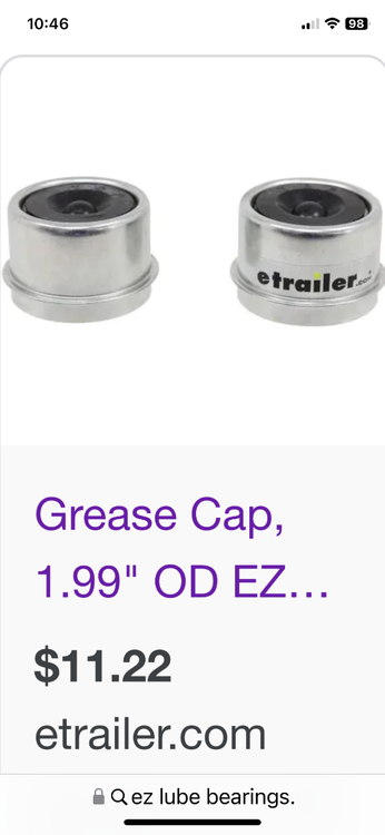

Thanks! Someone looked at the camper today and asked me why I do not have a cover for the wheel bearings that has a grease fitting on it so that you could grease the bearings without taking anything apart.  That is why I was asking on this forum.  Have you ever heard of such a thing and would it work??
If you have the grease fittings (Zerks) then you are equipped with Dexter’s E-Z Lube spindles on your axles, which are subject to routine maintenance and inspection of the hub bearings and seals. The hub components can be greased periodically based on usage via the Zerks; but at some point the hub bearings and seals will require inspection for wear, at which point the hubs are completely removed to service. The end of the spindle should have a grease cap to which a rubber lube plug is fitted, and will look like this:
