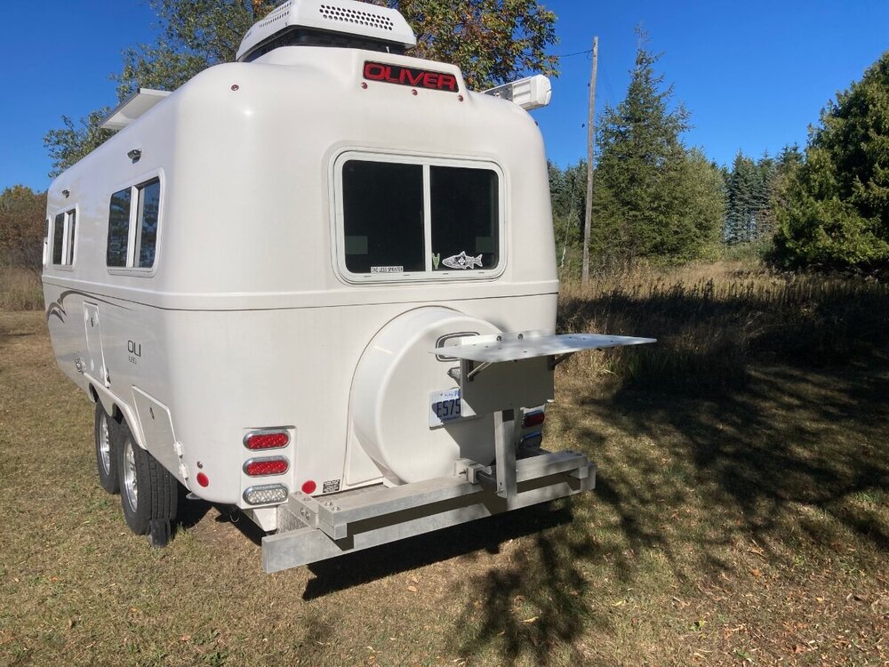

Mountainman198 Posted September 26, 2024 Posted September 26, 2024 (edited) Ever since Oliver went to the compressor fridge I have been envious of the integrated table where the lower fridge vent used to be. Here is what I came up with for when I dont drag a bike along. It was built with what I had on hand, including a old bike rack, fishing cutting board, boat stern transducer mounting board and a broken dock leg. Plan is to add a lagun mount on the lower rear so I have additional counter space. Since the propane quick connect is in the rear this will be where I set-up the outdoor kitchen. Will circle back to provide update on how it works out. Edited September 27, 2024 by Mountainman198 6 2021 Elite II, Hull# 898 2018 Toyota Tundra, 2003 Dodge Ram 3500 5.9l SRW

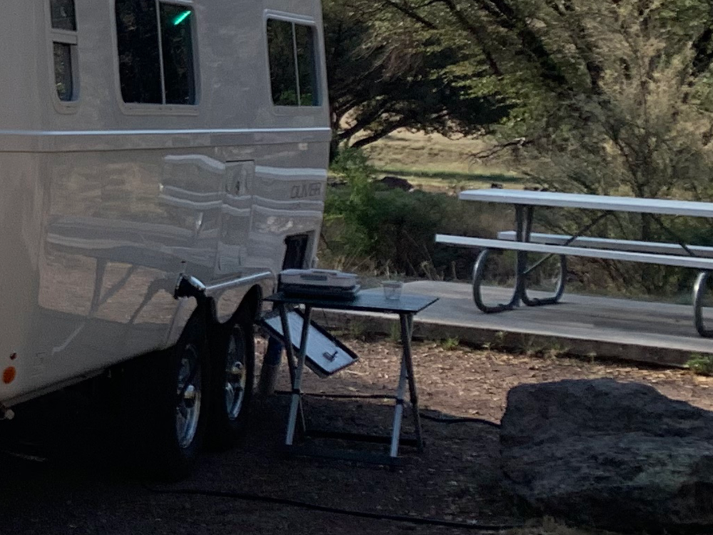

Moderator+ ScubaRx Posted September 26, 2024 Moderator+ Posted September 26, 2024 (edited) Does this mean you'll be doing all the cooking at Quartzsite? Also, are you now calling the trailer Oli Leg? Edited September 26, 2024 by ScubaRx 1 2 Steve, Tali and our dog Rocky plus our beloved dogs Storm, Lucy, Maggie and Reacher (all waiting at the Rainbow Bridge) 2008 Legacy Elite I - Outlaw Oliver, Hull #026 | 2014 Legacy Elite II - Outlaw Oliver, Hull #050 | 2022 Silverado High Country 3500HD SRW Diesel 4x4

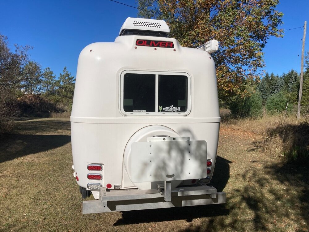

Mountainman198 Posted September 26, 2024 Author Posted September 26, 2024 15 minutes ago, ScubaRx said: Also, are you now calling the trailer Oli Leg? This Spring some of my graphics and the trailer decided to part ways. Some of the graphics just stopped adhering to the hull. This is what is left. Its like the adhesive just evaporated underneath the vinyl. 1 2021 Elite II, Hull# 898 2018 Toyota Tundra, 2003 Dodge Ram 3500 5.9l SRW

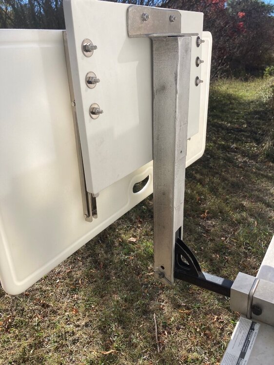

Mountainman198 Posted September 30, 2024 Author Posted September 30, 2024 Progress today. Got the water jug mount bolted on. Likely will not be used to transport full jugs, rather as a spot to place my Dometic Go water jug and usb faucet for washing dishes. Jug rack has been moved farther rearward to gain additional clearance since taking this picture. 1 2021 Elite II, Hull# 898 2018 Toyota Tundra, 2003 Dodge Ram 3500 5.9l SRW
