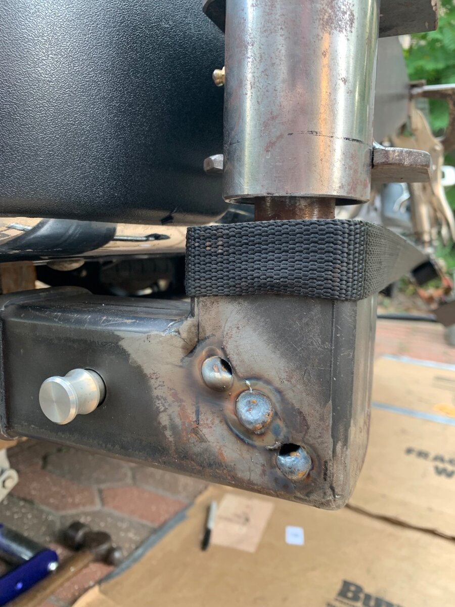

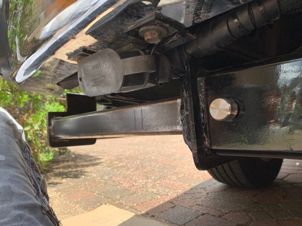

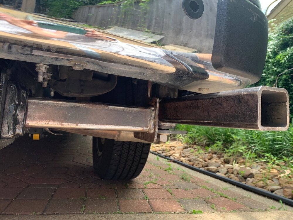

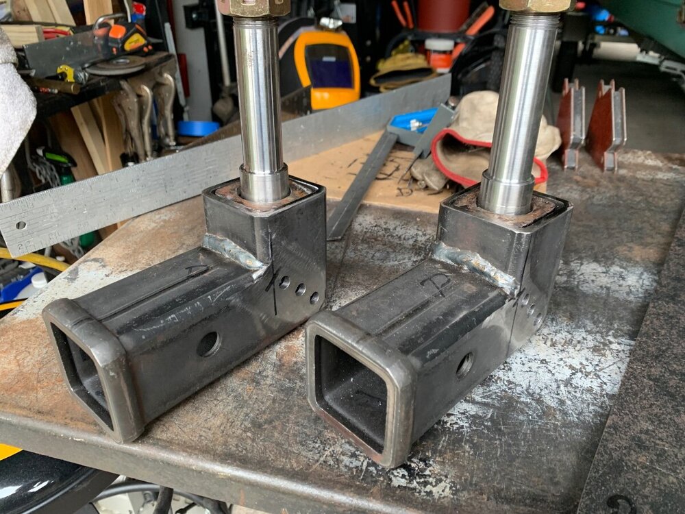

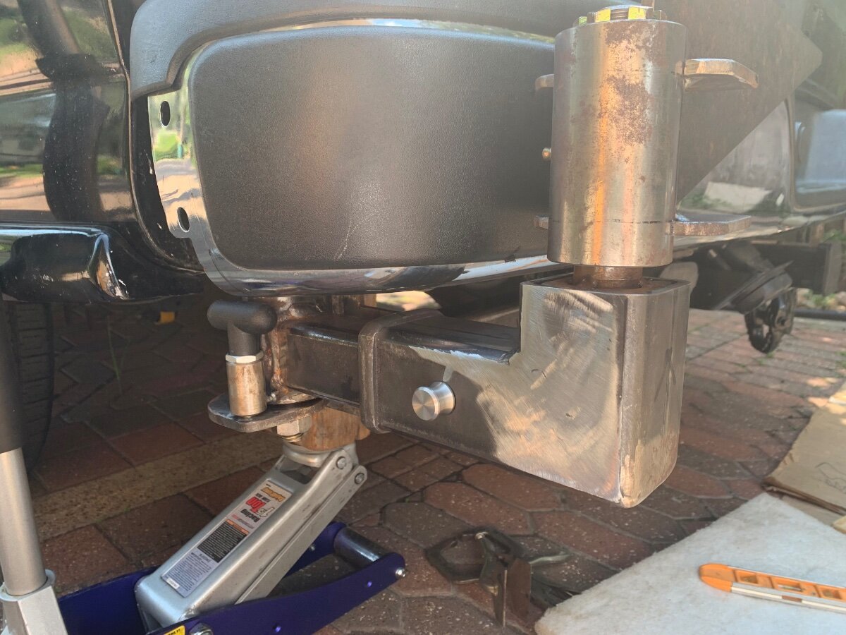

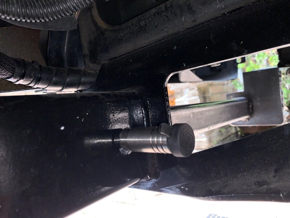

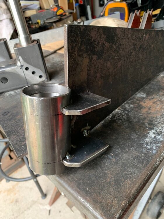

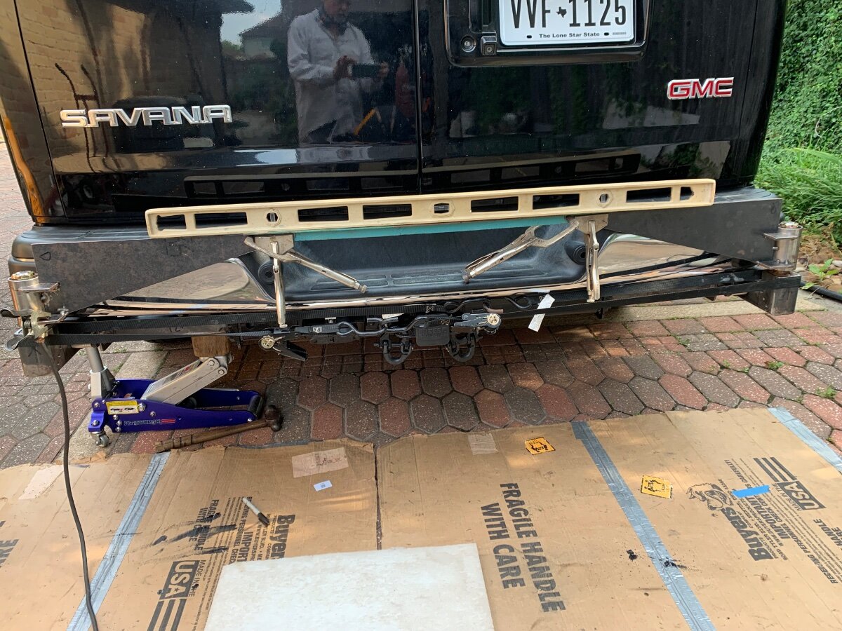

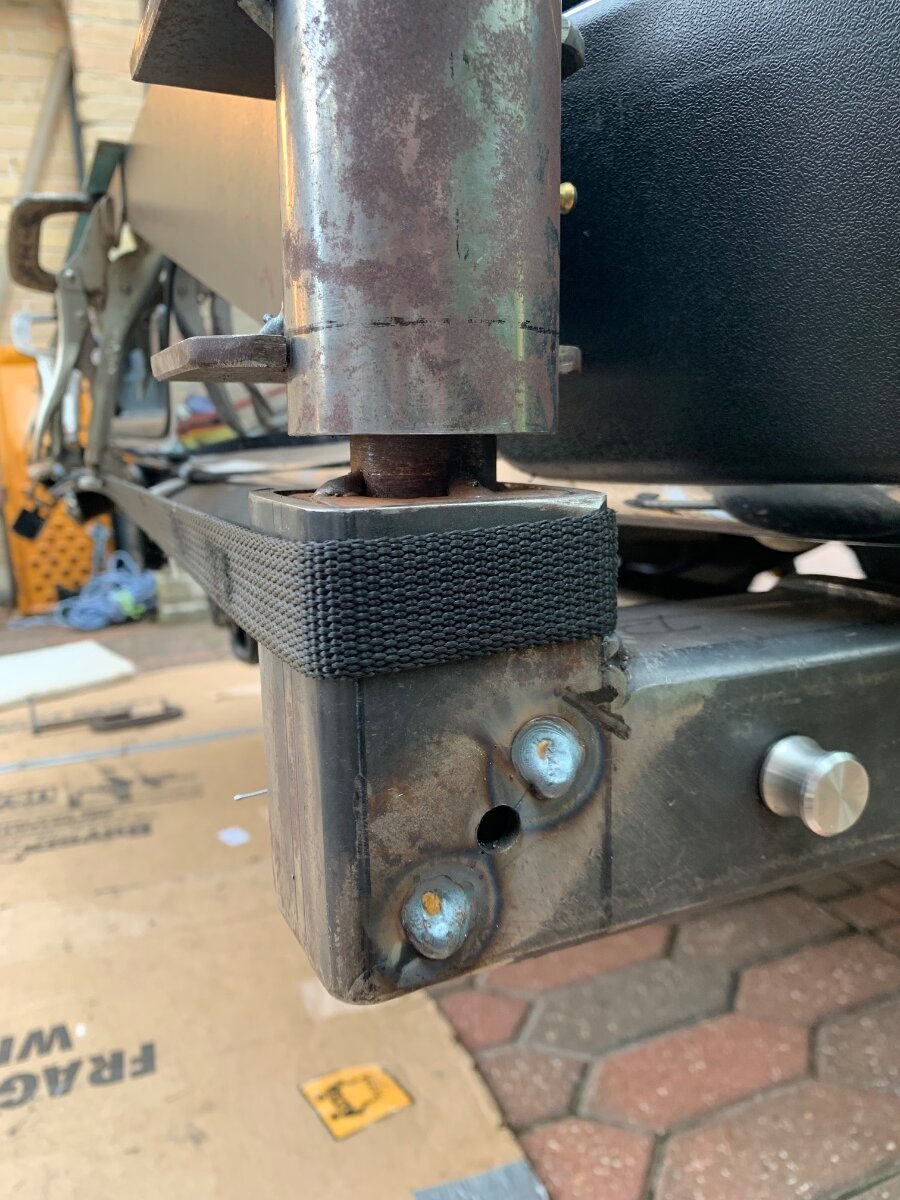

Ronbrink Posted June 23 Author Posted June 23 Yesterday I finished welding on the two primary swing out carrier hinges and fitment of the locking pins to secure them. Carrier hinge assemblies mocked up on the previously modified receiver hitch. Locking pin fitment for securement, underside view. Locking pin, rear view. 1 1 Ron and Brooxie | Clear Lake (Houston), Texas 2020 OLEll, Twin, 579: No installed solar, dual 30# propane tanks w/GasStop safety devices, Renogy 40A DC-DC charger, 460Ah LFP battery bank/Victron SmartShunt, auxiliary Cerbo-S GX/Victron 30A Blue Smart IP22 Charger combo, interior mounted Hughes Autoformer, twin independent sliding Lagun mount tables, extended dinette table and pantry landing, tongue-mounted hoist, Beech Lane refrigerator Ventilation/Evaporate Coil fans, metal valve stems with TST cap sensors and signal repeater, Waste Master sewer hose management system, Dreiha Atmos 4.4 A/C upgrade/Ceilo Breez Max thermostat, FlagpoleBuddy Starlink Mini suction mount kit. 2019 GMC Savana 2500 Cargo Work Van: Explorer Limited SE, Low-Top 7 Passenger van conversion, 6.0L V8 Vortec, 6-Speed Automatic, RWD; Air-Lift LoadLifter air suspension/WirelessAir compressor; Bilstein B6 4600 Series shocks; metal valve stems for TST tire pressure monitoring system; Buyers Products cargo containment boxes/DC Cargo securement system; rear bumper DC-DC Anderson power cable outlet; 100Ah 12V portable power station/Dometic CFX 75L Dual Zone cooler; front 2” receiver hitch/QuikrStuff Mach2 double bike rack; Mechman 320A high output alternator; Starlink Mini/Veritas Vans magnetic mount.

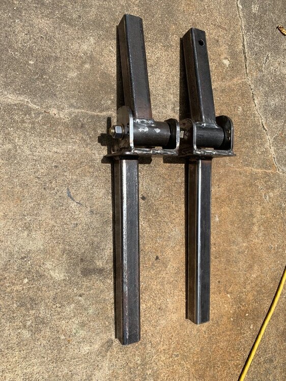

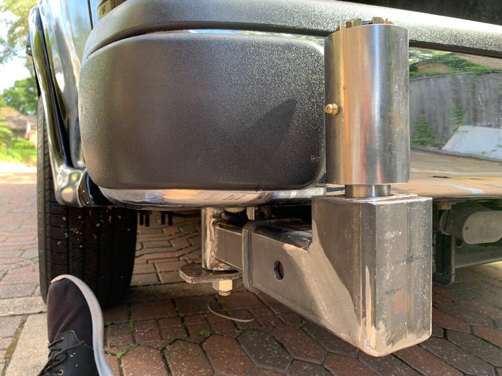

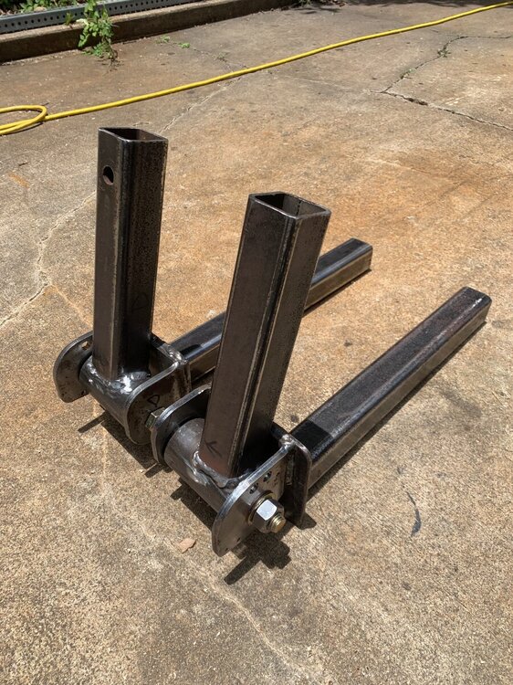

Ronbrink Posted July 6 Author Posted July 6 (edited) This is a slow progression, but my design-as-I-go method of doing things usually works to my favor. Each of the swing racks will have dual articulation to provide adequate clearance to enable the rear cargo doors to fully open. Here are some pics of the two primary pivot and arm assemblies. Awaiting delivery of additional supplies to further fabrication of secondary components. Standby! To anybody having the patience or curiosity to continue tracking this build, you are appreciated. I’m aware this may be beyond scope of the forum, and even though such tow vehicle mods are oftentimes of personal and individual importance, they should be shared in interest of others. Edited July 6 by Ronbrink 1 Ron and Brooxie | Clear Lake (Houston), Texas 2020 OLEll, Twin, 579: No installed solar, dual 30# propane tanks w/GasStop safety devices, Renogy 40A DC-DC charger, 460Ah LFP battery bank/Victron SmartShunt, auxiliary Cerbo-S GX/Victron 30A Blue Smart IP22 Charger combo, interior mounted Hughes Autoformer, twin independent sliding Lagun mount tables, extended dinette table and pantry landing, tongue-mounted hoist, Beech Lane refrigerator Ventilation/Evaporate Coil fans, metal valve stems with TST cap sensors and signal repeater, Waste Master sewer hose management system, Dreiha Atmos 4.4 A/C upgrade/Ceilo Breez Max thermostat, FlagpoleBuddy Starlink Mini suction mount kit. 2019 GMC Savana 2500 Cargo Work Van: Explorer Limited SE, Low-Top 7 Passenger van conversion, 6.0L V8 Vortec, 6-Speed Automatic, RWD; Air-Lift LoadLifter air suspension/WirelessAir compressor; Bilstein B6 4600 Series shocks; metal valve stems for TST tire pressure monitoring system; Buyers Products cargo containment boxes/DC Cargo securement system; rear bumper DC-DC Anderson power cable outlet; 100Ah 12V portable power station/Dometic CFX 75L Dual Zone cooler; front 2” receiver hitch/QuikrStuff Mach2 double bike rack; Mechman 320A high output alternator; Starlink Mini/Veritas Vans magnetic mount.

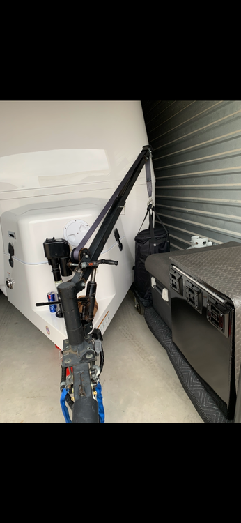

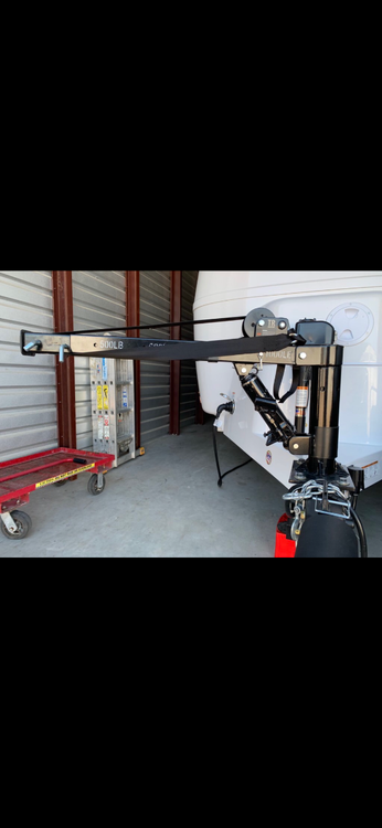

jd1923 Posted July 7 Posted July 7 (edited) 9 hours ago, Ronbrink said: ... my design-as-I-go method of doing things usually works to my favor. Very well said, my friend Ron. Me too, that's our style! It creates the best final outcomes when doing a personal one-off design. You have laid out so much great information in this thread to which many of us can learn. I had a Dodge Van 2500 Series back in the 90s. No way the Van-life thing, but we took it on great family trips to Florida and Colorado (from IL). We had so much fun and a 2500 series van drives well down the road! When we met at the Texas Rally, I looked at your hoist and I didn't see that I would not need one. Not anymore! I'm thinking of a truck mounted crane-hoist, mine got to be 12VDC vs. the piston hand crank. Mounted in the back of the truck bed, I would use it to lift the 30# LP tanks and also the HD fire ring I have constructed. First I added 10# of egg-shaped lava rocks that truly hold heat, not the cr@p that comes with these products. Then I added a fire-rated surround that focuses the heat and protects again the Winds of the West. Love this great campsite tool (see pic) and with the low grate pictured, and a taller stand for slow-cooking, using skillet or Lodge Dutch Oven, you can cook almost anything that does not splatter grease. Needless to say, this thing is heavy! On our recent 5-week trip, it was a bee-ach to lift out of the basket! Looking for your advice. Looking at products on Amazon which seem to be overkill, but maybe not. Perhaps this is right product as-is or with some modification in height and arm length. Let me know what you think. 😂 https://www.amazon.com/Folding-Truck-Mounted-Wireless-Electric-Painted/dp/B0899QCBP7/?th=1 Edited July 7 by jd1923 2 Chris & John in Prescott, AZ | 2016 EII #113 | '01 Ram 2500 Cummins!

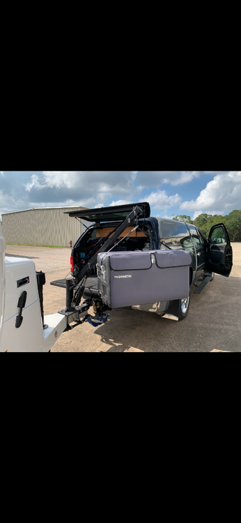

Ronbrink Posted July 7 Author Posted July 7 (edited) On 7/6/2025 at 8:08 PM, jd1923 said: Looking for your advice. Looking at products on Amazon which seem to be overkill, but maybe not. Perhaps this is right product as-is or with some modification in height and arm length. Let me know what you think. 😂 My hoist is a basic Ultra-Tow 1000# capacity hydraulic truck crane from Northern Tool, to which I added a strap hand crank winch and modified the arm end with rollers for ease of lifting. I think a strap, rather than wire rope, would serve you better; less abrasive and more user friendly. Whether looping around the handles on my 75L Dometic DZ cooler fully loaded, frames of our expensive ebikes, handle/valve guards on 30# propane tanks or the plastic molded generator handles; worry of marring is completely eliminated. However, lifting straps could be used in conjunction with a wire rope setup, and that product you linked may meet needs you have other than just camping. Proper reach from the truck bed to a point directly over the propane tank housing is important, but the post height could definitely be reduced, as you eluded. No regrets installing my hoist within months after Oliver ownership, its been a real back saver! And now it is proving to be even more useful in lifting the cargo boxes in and out of the Savana van. Here’s a few pics to ponder: Edited July 8 by Ronbrink 1 1 Ron and Brooxie | Clear Lake (Houston), Texas 2020 OLEll, Twin, 579: No installed solar, dual 30# propane tanks w/GasStop safety devices, Renogy 40A DC-DC charger, 460Ah LFP battery bank/Victron SmartShunt, auxiliary Cerbo-S GX/Victron 30A Blue Smart IP22 Charger combo, interior mounted Hughes Autoformer, twin independent sliding Lagun mount tables, extended dinette table and pantry landing, tongue-mounted hoist, Beech Lane refrigerator Ventilation/Evaporate Coil fans, metal valve stems with TST cap sensors and signal repeater, Waste Master sewer hose management system, Dreiha Atmos 4.4 A/C upgrade/Ceilo Breez Max thermostat, FlagpoleBuddy Starlink Mini suction mount kit. 2019 GMC Savana 2500 Cargo Work Van: Explorer Limited SE, Low-Top 7 Passenger van conversion, 6.0L V8 Vortec, 6-Speed Automatic, RWD; Air-Lift LoadLifter air suspension/WirelessAir compressor; Bilstein B6 4600 Series shocks; metal valve stems for TST tire pressure monitoring system; Buyers Products cargo containment boxes/DC Cargo securement system; rear bumper DC-DC Anderson power cable outlet; 100Ah 12V portable power station/Dometic CFX 75L Dual Zone cooler; front 2” receiver hitch/QuikrStuff Mach2 double bike rack; Mechman 320A high output alternator; Starlink Mini/Veritas Vans magnetic mount.
jd1923 Posted July 7 Posted July 7 10 hours ago, Ronbrink said: Proper reach from the truck bed to a point directly over the propane tank housing is important, but the post height could definitely be reduced, as you eluded. I would need to mount it in the bed over a frame segment so it can be properly secured. Agreed, thinking of distance to the LP tanks, it would require good arm reach which this product has. Yes, truck mounted I can use this for other needs and the strap you suggested would help for some cargo. Got this on my later this summer list (I got D52 axles and Alcan springs coming soon which is a first priority)! 1 Chris & John in Prescott, AZ | 2016 EII #113 | '01 Ram 2500 Cummins!

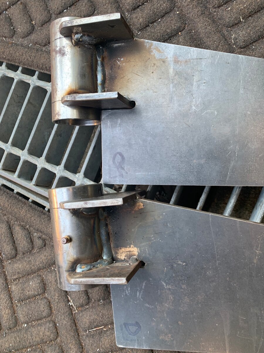

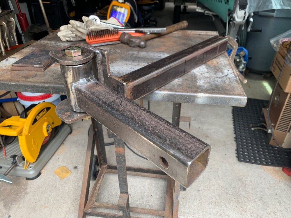

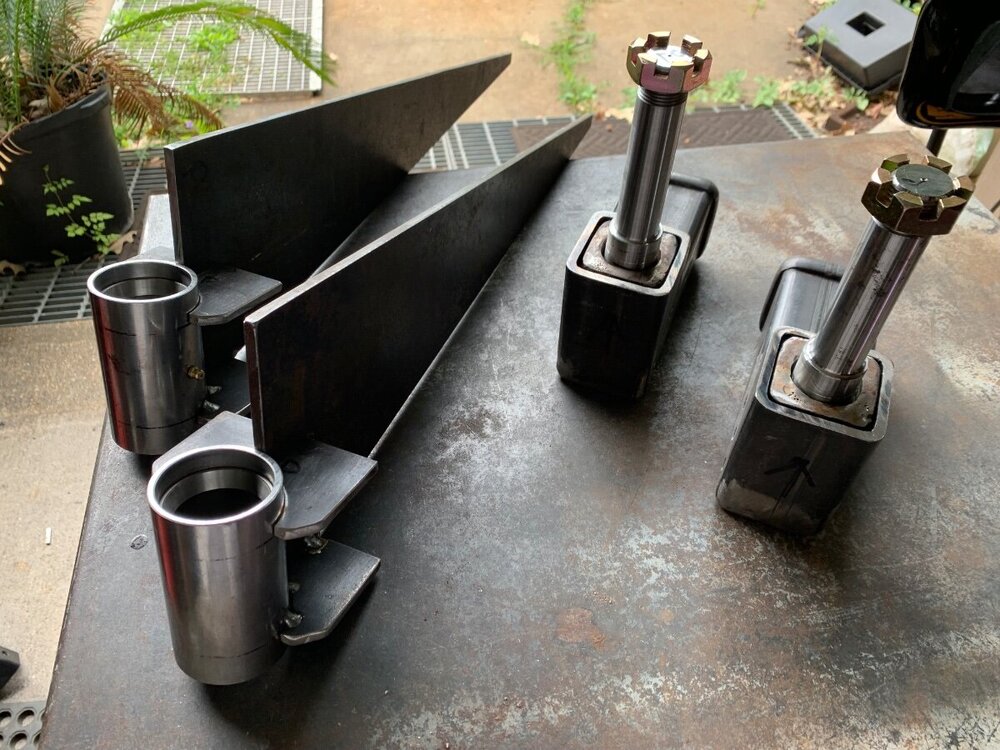

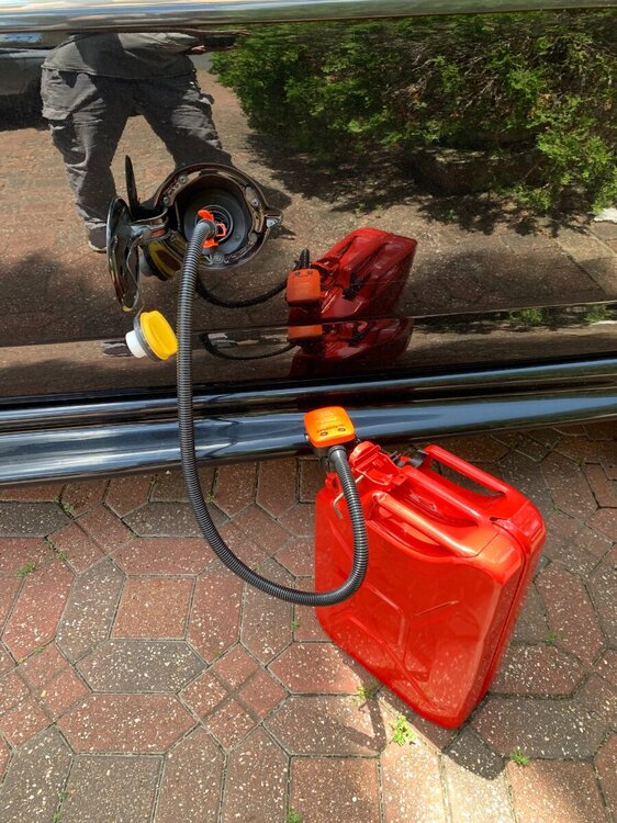

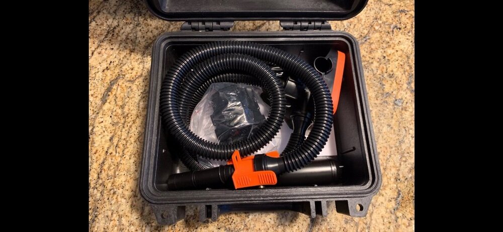

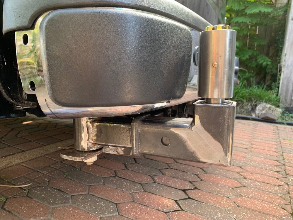

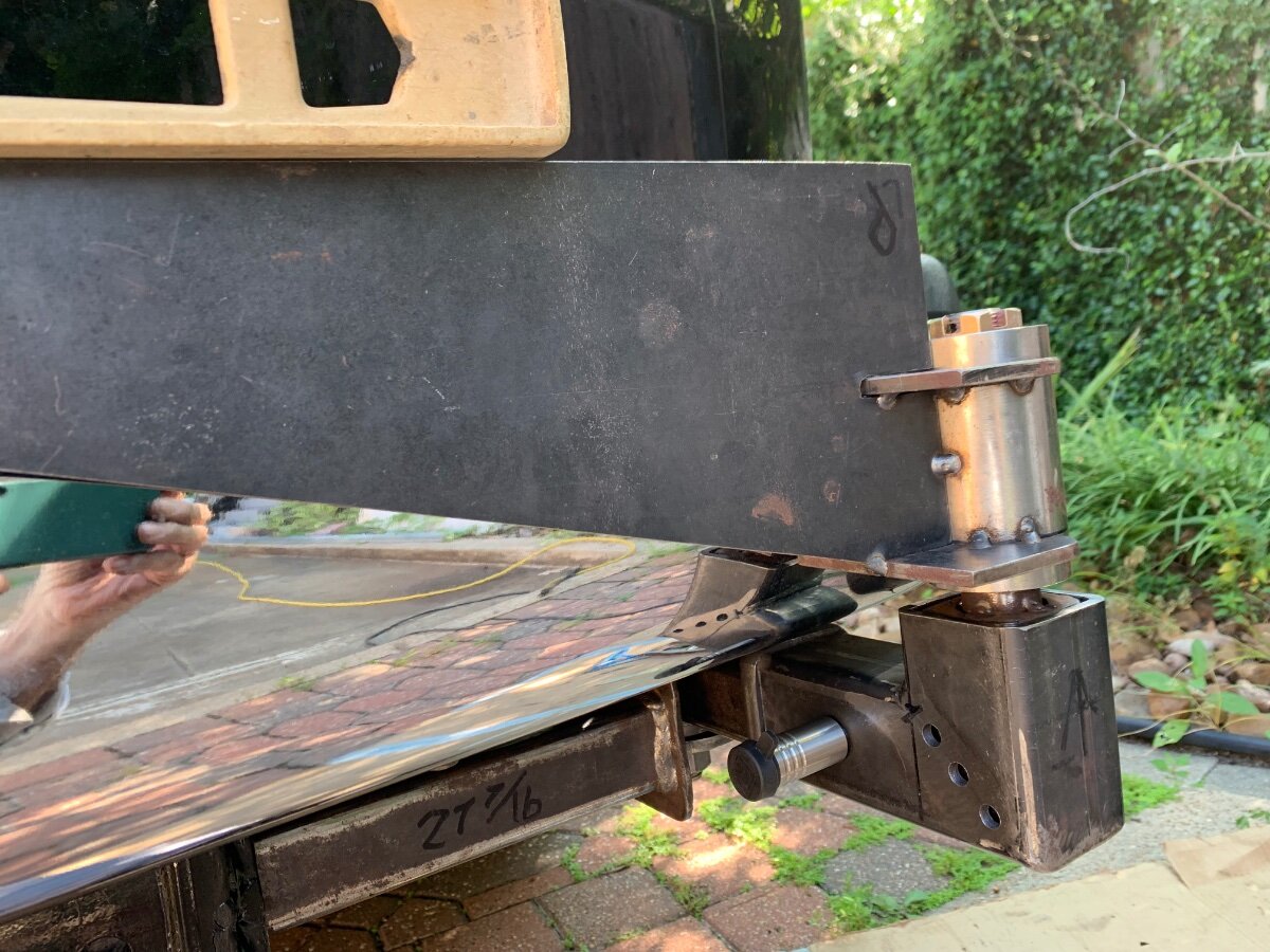

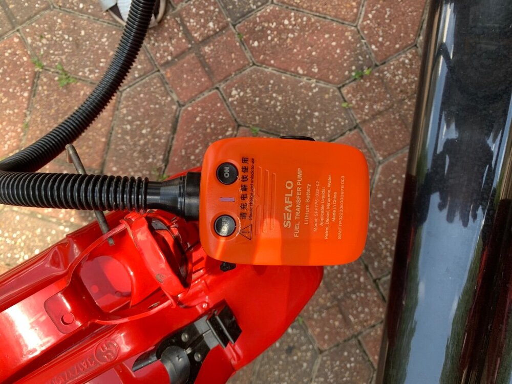

Ronbrink Posted July 22 Author Posted July 22 Mock up of secondary pivot components using a modified receiver hitch and spindle bearing hinge. A swing out carrier arm will be welded to these sleeves and span the width of each rear door. Drivers side shown where the jerry can carrier rack will be mounted. As a side note, electric fuel transport pump; stowed in a small Pelican case. I should be able to swing the mounted jerry cans completely out and refuel without removing them from the carrier rack. However, the fill hose would need to be extended a couple feet. Ron and Brooxie | Clear Lake (Houston), Texas 2020 OLEll, Twin, 579: No installed solar, dual 30# propane tanks w/GasStop safety devices, Renogy 40A DC-DC charger, 460Ah LFP battery bank/Victron SmartShunt, auxiliary Cerbo-S GX/Victron 30A Blue Smart IP22 Charger combo, interior mounted Hughes Autoformer, twin independent sliding Lagun mount tables, extended dinette table and pantry landing, tongue-mounted hoist, Beech Lane refrigerator Ventilation/Evaporate Coil fans, metal valve stems with TST cap sensors and signal repeater, Waste Master sewer hose management system, Dreiha Atmos 4.4 A/C upgrade/Ceilo Breez Max thermostat, FlagpoleBuddy Starlink Mini suction mount kit. 2019 GMC Savana 2500 Cargo Work Van: Explorer Limited SE, Low-Top 7 Passenger van conversion, 6.0L V8 Vortec, 6-Speed Automatic, RWD; Air-Lift LoadLifter air suspension/WirelessAir compressor; Bilstein B6 4600 Series shocks; metal valve stems for TST tire pressure monitoring system; Buyers Products cargo containment boxes/DC Cargo securement system; rear bumper DC-DC Anderson power cable outlet; 100Ah 12V portable power station/Dometic CFX 75L Dual Zone cooler; front 2” receiver hitch/QuikrStuff Mach2 double bike rack; Mechman 320A high output alternator; Starlink Mini/Veritas Vans magnetic mount.

Ronbrink Posted August 31 Author Posted August 31 Slow progress, but progress none the less! Secondary receiver hitch/spindle bearing hinge assemblies furthered by addition of gussets for strength and support. Once welded out, a square tube will top each gusset to complete the swing out carrier arms. Custom racks will then be fabricated to hold and secure respective jerry cans and spare propane tank. Ron and Brooxie | Clear Lake (Houston), Texas 2020 OLEll, Twin, 579: No installed solar, dual 30# propane tanks w/GasStop safety devices, Renogy 40A DC-DC charger, 460Ah LFP battery bank/Victron SmartShunt, auxiliary Cerbo-S GX/Victron 30A Blue Smart IP22 Charger combo, interior mounted Hughes Autoformer, twin independent sliding Lagun mount tables, extended dinette table and pantry landing, tongue-mounted hoist, Beech Lane refrigerator Ventilation/Evaporate Coil fans, metal valve stems with TST cap sensors and signal repeater, Waste Master sewer hose management system, Dreiha Atmos 4.4 A/C upgrade/Ceilo Breez Max thermostat, FlagpoleBuddy Starlink Mini suction mount kit. 2019 GMC Savana 2500 Cargo Work Van: Explorer Limited SE, Low-Top 7 Passenger van conversion, 6.0L V8 Vortec, 6-Speed Automatic, RWD; Air-Lift LoadLifter air suspension/WirelessAir compressor; Bilstein B6 4600 Series shocks; metal valve stems for TST tire pressure monitoring system; Buyers Products cargo containment boxes/DC Cargo securement system; rear bumper DC-DC Anderson power cable outlet; 100Ah 12V portable power station/Dometic CFX 75L Dual Zone cooler; front 2” receiver hitch/QuikrStuff Mach2 double bike rack; Mechman 320A high output alternator; Starlink Mini/Veritas Vans magnetic mount.
