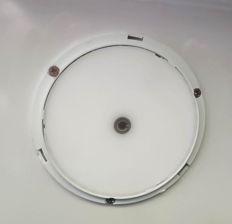

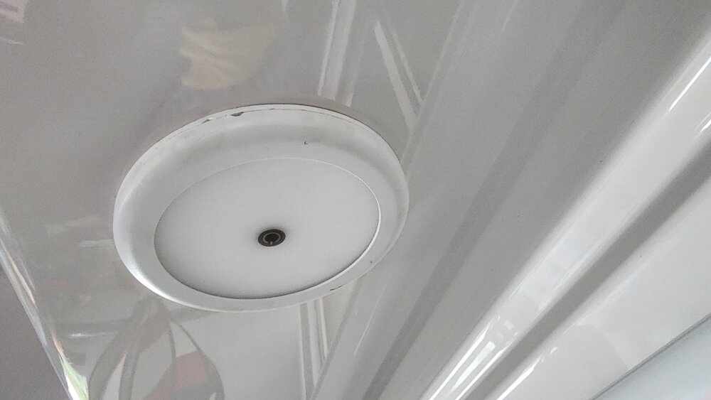

Not sure this will help...I just experienced a failure of the light as well.  I do not like the rivets either.  I talked to Jason (Jason in parts department) and he informed me they discontinued the line of lights they were using and went to a new style that uses screws.  It's the same diameter but the hole pattern is slightly different.  I used one existing hole and had to drill the other 2 to mount it.  The profile is different as the lens doesn't bow down like the old one did (see photos)  I like it better as it's easier on the eyes because the lens is flat and not bowl shaped.  Good luck!
John
It is still a touch light.

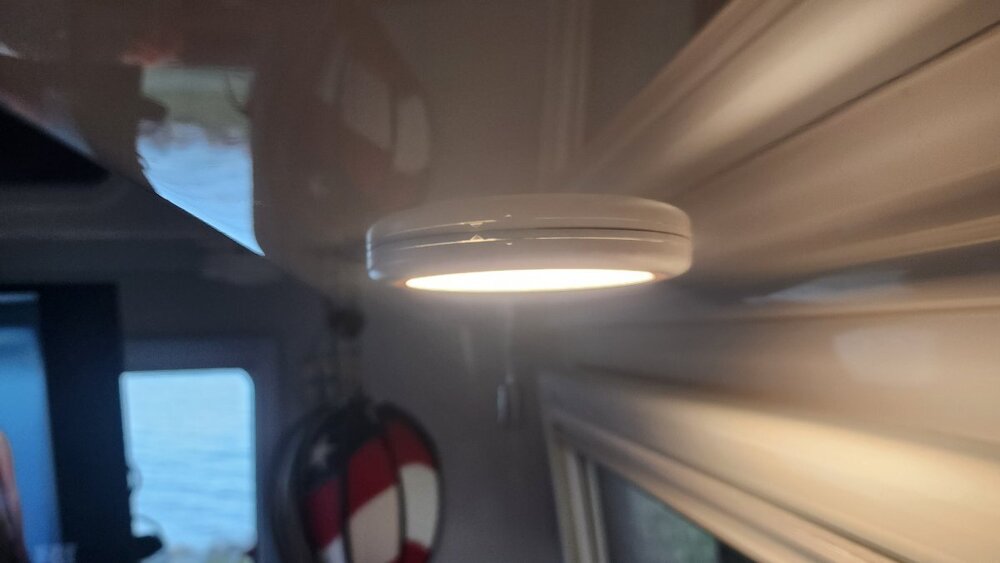

I had mine replaced last year when I went to the mothership for regular service. This is what I purchased.
I had Oliver do the mounting since I was there anyway because I'm not super comfortable with drilling and screwing into fiberglass. They have a central mechanical button that is part of the cover. They are dimmable, have 3000K/4000K/5000K (selectable at purchase) temperature,  and they have a blue mode for night lighting. When installing, the screw holes must be drilled perpendicular to the surface, or the cover mounting will not be perfectly flat, in which case the switch button will not reliably make proper contact with the switch itself. I did have to repair the screw installation since the Oliver tech didn't know this (neither did I), but now all five of them work properly first time every time.
They're cheap enough that I bought a spare set, but their life is very long so a replacement will probably not be required during my time with the trailer.
Mobilejoy, i looked at those lights to..  I replaced mine with the switch along the side they are dimmable too.. If any one wants to see my lights. Stop by if your at the rally G17..  mine do not sit flush , does not bother me.. i just want them to work.. i replaced two touch lights under warrenty..  stay safe out there..
