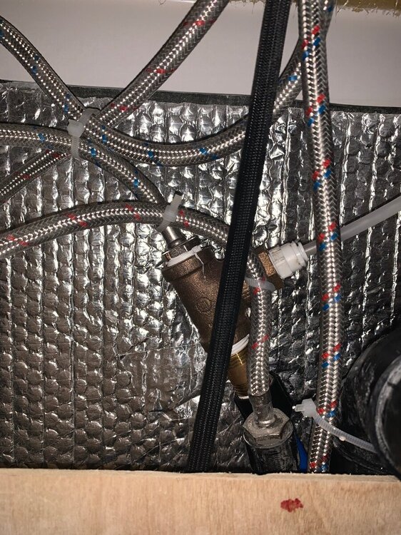

The install in our Oliver was very easy. It does require drilling a hole in the countertop, but the Blu Tech UVC faucet looks like it belongs there. The kit came with a 120 volt AC adapter that supplies the UVC faucet with 12 volts DC at 2 amps. We don't always run the inverter and we're not always on shore power. For our install we ditched the AC adapter and purchased a DC5521 connector so we could wire directly to a 12 volt circuit.  The Norcold refrigerator is on a 20 amp fuse, so we tapped into its power supply and added a 3 amp fuse at the splice.  Blu Tech doesn't supply a separate DC5521 connector for direct wiring, and we didn't want to cut it off from the supplied ac adapter in case we need to send it back.  Besides the DC connector, we also had to purchase the parts to tie it into our freshwater line. The faucet requires 1/4 inch PEX. We inserted a threaded t-connector with a 1/4 inch PEX fitting in-between the existing cold water PEX to braided stainless faucet fitting under the sink.
After installation I saw that the counterweight for the kitchen faucet hose bumped against the new t-connector.  We used zip ties to hold the water lines away from the counterweight when it goes up/down.

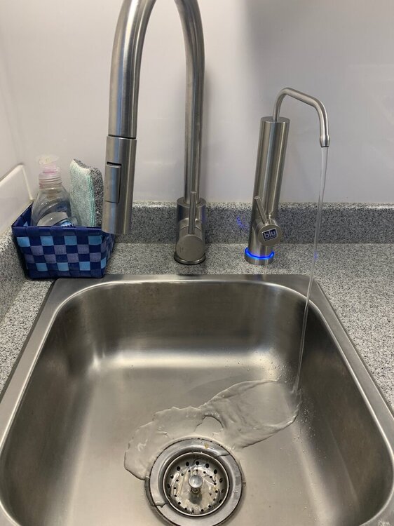

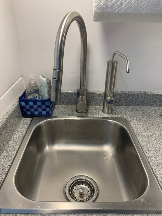

So far so good. A blue light glows at the faucet base when the water is running.  The style of the faucet is a close match to the original.
