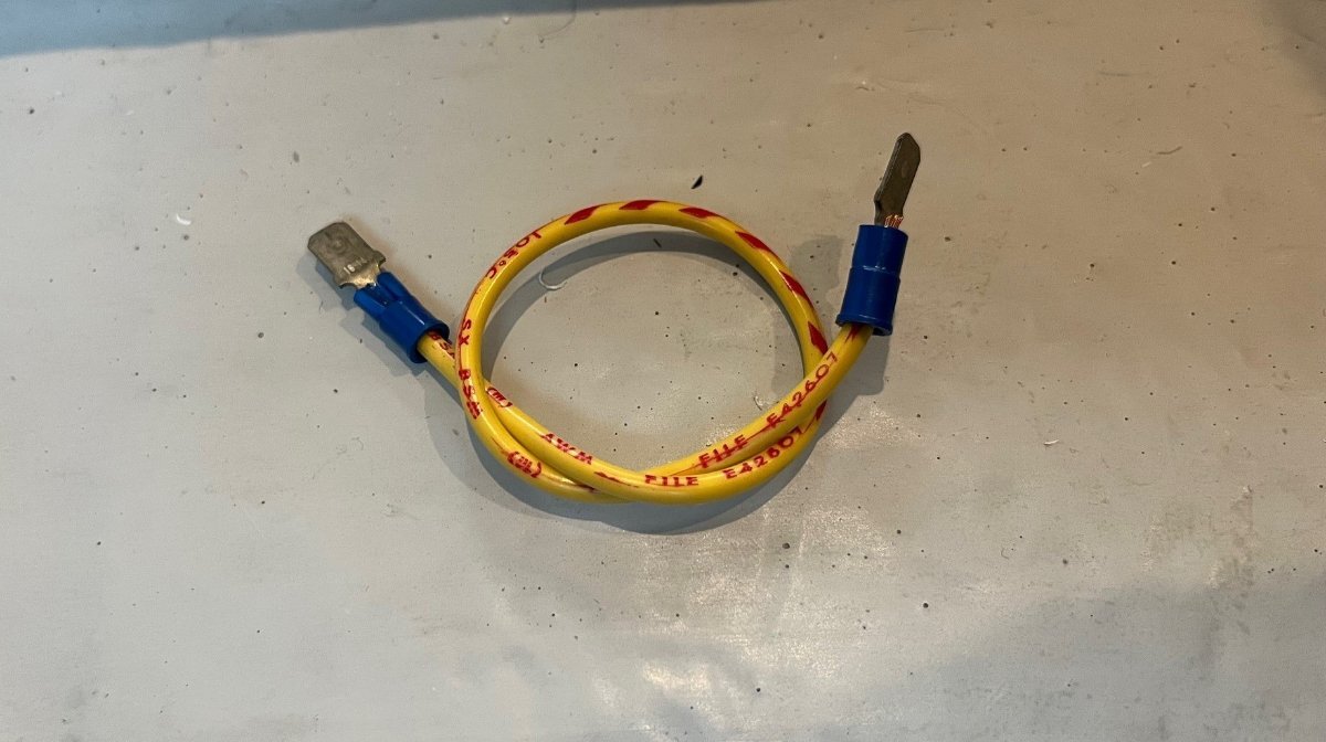

Also, everybody should carry a simple spade jumper like pictured below. The Oliver has many toggle switches installed and this simple jumper can be used as a temporary override. I had a brake pedal switch go bad on a Class-C which would not allow me to move the auto trans gear selector out of park. We were stuck right were we had parked.
I used a jumper like this to bypass the switch which allowed us to drive an hour or two into the next town to get this common replacement switch at Napa. They also would likely have a replacement toggle switch for the jack. Nice little tool to have handy. I made one when we had the brake switch failure and have carried it with ever since. Used it once when the Oliver had a bad water pump switch under the pantry which allowed the switch under the bath vanity to work.
