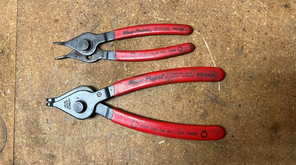

Any suggestions for the size of the snap ring pliers?
Sorry for not posting this sooner. An Oliver friend was at Harbor Freight today asking me the same question, so I went out to my garage and measured.
The large snap ring has holes 0.11" ID and they are 1 1/4" apart. The snap-ring pliers I used for this has pins 0.07" OD and has a reach of about 1 1/2".
The very small snap ring has holes about 0.05" and are only 1/4" apart. The snap-ring pliers I used for this has pins 0.04" OD.
These are the tools I used. Zoom in to see tool part numbers.
