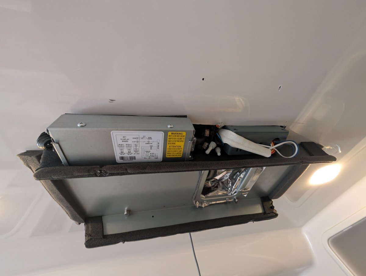

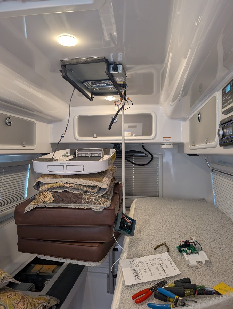

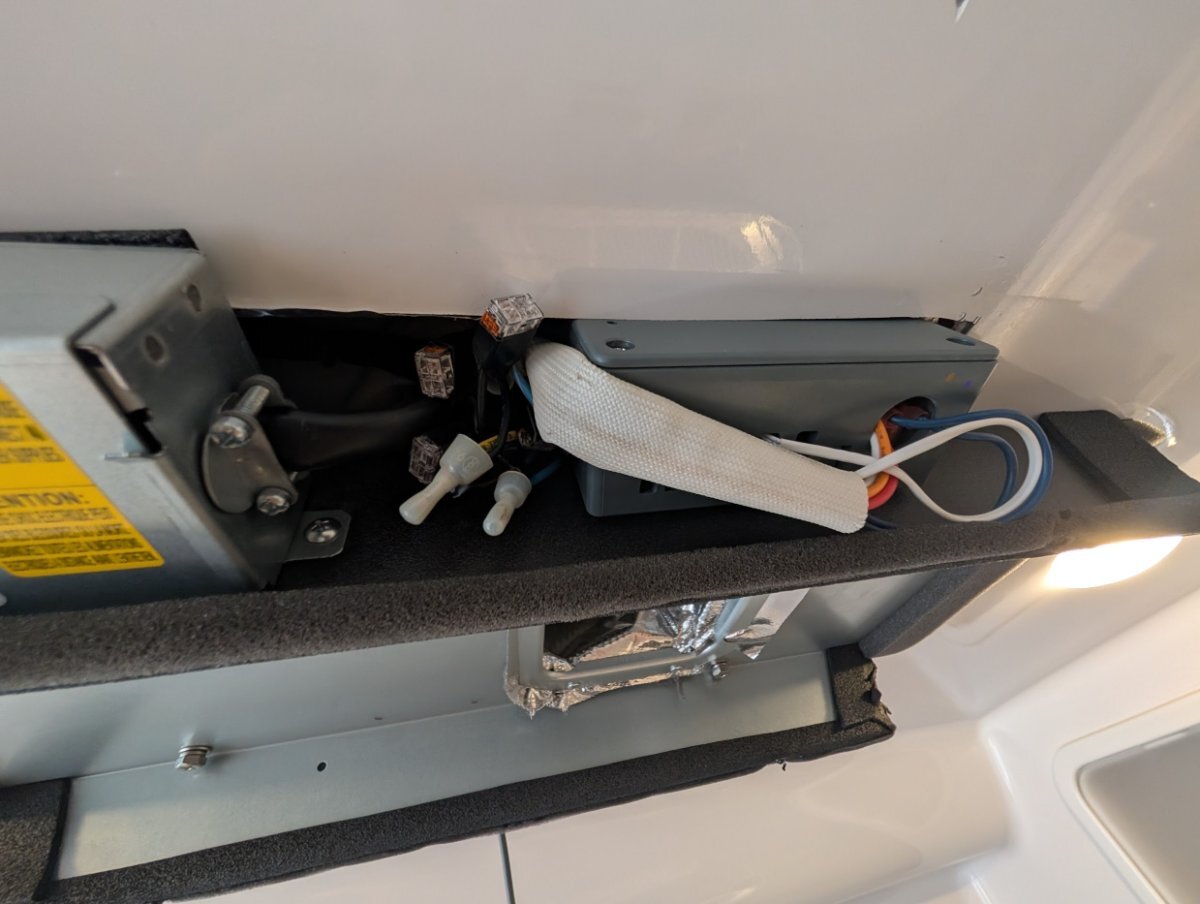

ChristianD Posted October 26 Author Posted October 26 (edited) I started the install, but have a question about the DC thermostat wire bundle loom, if anyone knows or has done this? I'm assuming I cut these wires and wrap them since they won't be used for the new AC unit, but I wasn't sure if that would affect the Suburban furnace control from the thermostat? From reading the Atmos install from @Ronbrink, it looks like he had a Dometic furnace and a control box. I ordered the Tosot with the Turbro soft start and got that installed. I followed this install video Here's the pictures from my wiring of the soft start: After I figure out these thermostat wires, then I'll attempt to get the Dometic down and the Tosot up onto the RV. I'm doing this solo, but think I have a method with a winch, some straps and using a beam from my garage barn to hoist them up and down. Should be good, but will take some maneuvering. Planning a trip to Death Valley and Yosemite soon. Last weekend, we went up to Prescott, AZ for my our first trip together. It was great! Edited October 26 by ChristianD Christian, Katie and Benny (our Maltese) | Cave Creek, AZ | 2019 LE II #448 | '25 GMC Yukon
ChristianD Posted October 26 Author Posted October 26 I asked ChatGPT. Seems I will need a separate thermostat for the furnace now since I'm removing the Dometic control board. ------------------------------------ 🧩 What You Have Now That wiring harness under your Dometic Penguin II is the thermostat communication/control loom for your Dometic wall thermostat. It’s a 12 V DC control system (not 120 V). The loom carries low-voltage signals for both the A/C and the Suburban furnace (via the Dometic control board). The Dometic system acted as a “hub” — your thermostat told the A/C control box what to do, and that box sent the furnace signal out on the blue wire when “heat” was called for. When you remove the Penguin II and its control box, you break that communication path. The Suburban furnace won’t get its 12 V heat-call signal anymore unless you rewire it to a simple independent thermostat. 🧰 What You Need To Do So the Furnace Still Works Since your new Tosot A/C runs entirely off its own remote, you can leave those Dometic control wires disconnected and instead wire the furnace directly to a standard 12 V RV thermostat (or reuse your existing wall thermostat if it supports direct furnace control). Option 1 – Add a small 12 V mechanical/electronic thermostat just for the furnace Find the two furnace control wires coming from the Suburban unit (typically blue and white, sometimes blue/white stripe). Those are the “thermostat loop.” When connected together, the furnace runs. Route those two wires to a simple RV thermostat (like the Honeywell TH1100DV or Dometic single-stage heat only). Connect them to the “R” and “W” (or “+” and “–”) terminals — polarity doesn’t matter on a basic furnace circuit. Cap or tape off all the old Dometic A/C control wires safely; they’ll be unused. Option 2 – Reuse the existing Dometic wall thermostat (only if it has a furnace setting and can directly switch 12 V) If your Dometic wall stat is one of the basic analog models with a heat switch, you can bypass the old A/C control box: Connect the furnace’s two thermostat wires directly to the furnace terminals on that thermostat. Ignore all the data-bus or multi-wire cable that went to the A/C. If your wall thermostat is digital and used an RJ-11 phone-type cable, it won’t work standalone — you’ll need a new simple furnace thermostat. 1 Christian, Katie and Benny (our Maltese) | Cave Creek, AZ | 2019 LE II #448 | '25 GMC Yukon
katanapilot Posted October 26 Posted October 26 IIRC, the Dometic thermostat used originally for the Dometic Turbojet Penguin A/C, had a digital communication protocol to the control box located in the Penguin. This box had a couple of relays that were used to control the Suburban furnace. There are a few posts somewhere on this forum on how I (and others) modified that box to continue to work with the Suburban. Others have replaced the Dometic thermostat with a more conventional "analog" style to work when they removed the Penguin. 1 2020 Elite II Hull #628 "Pearl" - Houghton Heat Pump, Victron MP2, SmartSolar, Orion, Cerbo, Lynx distributor and shunt TV - 2011 Toyota Tundra Crew Max Platinum 5.7 V8 4WD, Magnuson Supercharger, OME suspension, Wilwood front and rear brakes

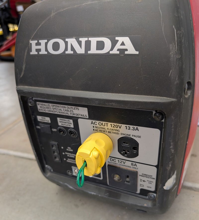

ChristianD Posted October 31 Author Posted October 31 I found the issue with the generators now working. My Honda generators have a "floating neutral" and the Tosot won't power on without the neutral grounded. I made a plug that jumps the neutral (silver side) to ground and plugged in the regular plug, plugged into the rv, fired up the generator and the AC powered on! Both my Honda EU2000 and 3000 work with it like that. Solution: Ground / Bonding Plug Some RV A/C units + soft starts will NOT start from an unbonded generator (floating neutral). They see it as a fault and won't engage the compressor. Honda portables = floating neutral Fix: Use a neutral-ground bonding plug in a spare outlet on the generator. Example DIY bond plug: Standard 3-prong plug Jumper neutral to ground inside 2 Christian, Katie and Benny (our Maltese) | Cave Creek, AZ | 2019 LE II #448 | '25 GMC Yukon
Ronbrink Posted October 31 Posted October 31 32 minutes ago, ChristianD said: Some RV A/C units + soft starts will NOT start from an unbonded generator (floating neutral). This is a thing all Oliver owners using generators deal with, no supplied AC for anything without one! 2 Ron and Brooxie | Clear Lake (Houston), Texas 2020 OLEll, Twin, 579: No installed solar, dual 30# propane tanks w/GasStop safety devices, Renogy 40A DC-DC charger, 460Ah LFP battery bank/Victron SmartShunt, auxiliary Cerbo-S GX/Victron 30A Blue Smart IP22 Charger combo, interior mounted Hughes Autoformer, twin independent sliding Lagun mount tables, extended dinette table and pantry landing, tongue-mounted hoist, Beech Lane refrigerator Ventilation/Evaporate Coil fans, metal valve stems with TST cap sensors and signal repeater, Waste Master sewer hose management system, Dreiha Atmos 4.4 A/C upgrade/Ceilo Breez Max thermostat, FlagpoleBuddy Starlink Mini suction mount kit. 2019 GMC Savana 2500 Cargo Work Van: Explorer Limited SE, Low-Top 7 Passenger van conversion, 6.0L V8 Vortec, 6-Speed Automatic, RWD; Air-Lift LoadLifter air suspension/WirelessAir compressor; Bilstein B6 4600 Series shocks; metal valve stems for TST tire pressure monitoring system; Buyers Products cargo containment boxes/DC Cargo securement system; rear bumper DC-DC Anderson power cable outlet; 100Ah 12V portable power station/Dometic CFX 75L Dual Zone cooler; front 2” receiver hitch/QuikrStuff Mach2 double bike rack; Mechman 320A high output alternator; Starlink Mini/Veritas Vans magnetic mount.

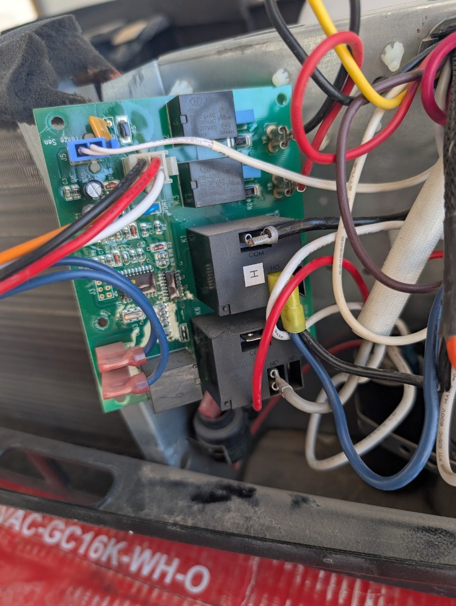

ChristianD Posted November 11 Author Posted November 11 ✅ Successful Furnace + CT Thermostat Integration After A/C Swap (Tosot Unit) Hi all — following up on my earlier post where I mentioned trying the Dometic controller from RV Surplus. Turns out that board was not the correct one for our Oliver furnace setup, and it would not communicate with the Dometic CT thermostat (kept throwing E1 code (no communications with the board). TL;DR: If you replace the factory Dometic A/C (mine is now a Tosot), the only way I found to keep using the Dometic CT thermostat to control the Suburban furnace is to reuse the original Dometic control board from the roof A/C. The CT thermostat did not run the furnace without that board in the circuit. 🚫 The Wrong Part I Initially Ordered I'd edit my previous post about this part, but I don't appear to have edit access to my older post. For clarity, the controller I first tried — which did not work — was: Dometic™ OEM 3316230.700 (9600024570) / 3313199.000 Single Zone CT Thermostat w/ Control Board (Cool/Furnace) – White Even though it says Cool/Furnace, this is a Single-Zone CT control board, not the CCC2-style logic board used in the Oliver. It will not communicate with the Oliver’s Dometic CT thermostat → results in E1 error. This board also lacks the correct communication architecture that the Oliver’s factory wiring uses. So if you're replacing your original Dometic roof A/C with a Tosot and want to keep your CT thermostat to run the Suburban furnace, this part will not solve it. I only had success after re-using the real factory control board pulled from the original rooftop A/C. ❌ What did not work Purchased a Dometic “furnace controller” from RV Surplus Installed and wired it per previous guidance CT thermostat would not see it → E1 comm fault That part was a standalone freeze/temp sensor board and not the actual Dometic furnace logic board the CT needs to handshake with. At least that's my understanding of why it wasn't communicating and turning on the furnace. ✅ What did work Removed the original Dometic control board from the old rooftop A/C unit Installed it in the ceiling cavity where the wiring drops down Connected the original Oliver comm wires (blue/white) and 12V power leads; basically connected all the wires I cut back to the wires on the original control board. Connected the furnace R/W from the Dometic board to the Suburban furnace leads Plugged in the original Dometic freeze sensor (or you can use a 10k resistor) to avoid E5 Thermostat rebooted, initialized properly, and now Heat mode functions just like factory. The Tosot A/C runs stand-alone on its own remote — the CT thermostat now just handles the furnace. 🔧 Mounting Notes There was no enclosure around the board in the original AC, so I repurposed the housing from the incorrect RV Surplus controller. Trimmed two corners of the board to fit and secured all wiring. Everything is clean and protected behind the interior ceiling shroud. 🎉 Result CT thermostat works in Furnace mode No more E1 or E5 errors Oliver interior remains OEM-clean — no separate thermostat needed Tosot A/C runs independently on its own control system 💡 For others doing a swap: If you want to retain your CT thermostat for furnace control: Do not discard the original Dometic A/C control board. It must be reinstalled to act as the furnace interface. The Oliver wiring uses the Dometic bus — not simple furnace contacts — so the board is required for the CT to communicate. Thanks to @RonBrink and others who paved the way on this mod — his wiring was slightly different, so I'm sharing this as a variation in case it helps the next person who uses a Tosot (or any non-Dometic) replacement A/C. Pics attached below. Let me know if anyone wants a wiring diagram or parts notes. 1 3 Christian, Katie and Benny (our Maltese) | Cave Creek, AZ | 2019 LE II #448 | '25 GMC Yukon
Ronbrink Posted November 12 Posted November 12 15 hours ago, ChristianD said: I'm sharing this as a variation in case it helps the next person who uses a Tosot (or any non-Dometic) replacement A/C. Good job on the TOSOT install and workaround on the Suburban furnace operation. Being able to retain the Dometic CT thermostat and utilize the original Dometic control board in said manner is a great accomplishment! Do you plan to replace the control board removed from the DPll in order to sell and recoup replacement costs? One can easily get $500+ for these used units, mine sold very quickly on FB Marketplace for $600. Ron and Brooxie | Clear Lake (Houston), Texas 2020 OLEll, Twin, 579: No installed solar, dual 30# propane tanks w/GasStop safety devices, Renogy 40A DC-DC charger, 460Ah LFP battery bank/Victron SmartShunt, auxiliary Cerbo-S GX/Victron 30A Blue Smart IP22 Charger combo, interior mounted Hughes Autoformer, twin independent sliding Lagun mount tables, extended dinette table and pantry landing, tongue-mounted hoist, Beech Lane refrigerator Ventilation/Evaporate Coil fans, metal valve stems with TST cap sensors and signal repeater, Waste Master sewer hose management system, Dreiha Atmos 4.4 A/C upgrade/Ceilo Breez Max thermostat, FlagpoleBuddy Starlink Mini suction mount kit. 2019 GMC Savana 2500 Cargo Work Van: Explorer Limited SE, Low-Top 7 Passenger van conversion, 6.0L V8 Vortec, 6-Speed Automatic, RWD; Air-Lift LoadLifter air suspension/WirelessAir compressor; Bilstein B6 4600 Series shocks; metal valve stems for TST tire pressure monitoring system; Buyers Products cargo containment boxes/DC Cargo securement system; rear bumper DC-DC Anderson power cable outlet; 100Ah 12V portable power station/Dometic CFX 75L Dual Zone cooler; front 2” receiver hitch/QuikrStuff Mach2 double bike rack; Mechman 320A high output alternator; Starlink Mini/Veritas Vans magnetic mount.
