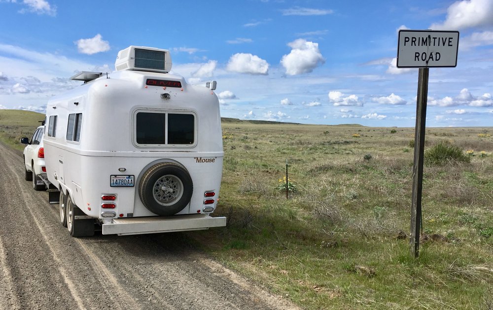

I have been doing more dirt road travel since I installed the Stone Stomper. Today I spent six hours exploring BLM land in Central WA and I covered over 60 miles of gravel ranch roads. To say my fridge coils were dusty would be an understatement.... when I got home I opened the two outside access panels and blew out a vast cloud with my gas powered leaf blower. The dust cannot be good for it, or my using big blasts of air to remove it....
I could make some solid covers and turn off the fridge completely, but I would rather not go to that extreme. Any links or ideas for filtration? The bottom opening is the worst, it is dead center in the main cloud kicked up by the truck.
