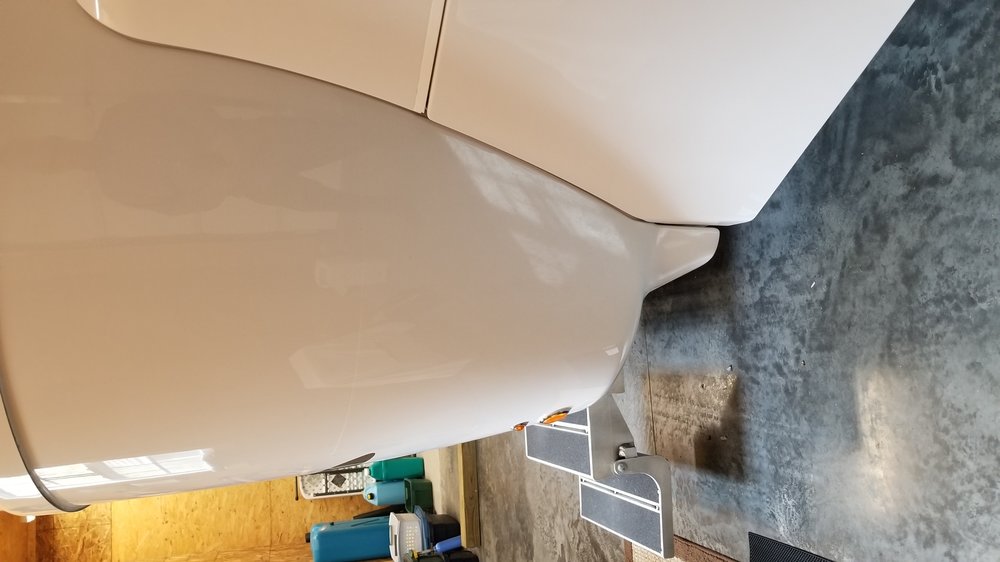

Yes, is very remove easy to remove using a hair drier or a heat gun. Contrary to what John says it is also easy to install and goes around bends very easy. It's made to apply around bumpers and mirrors on cars and you can pull it around almost any curve. The curves on the Oliver are easy to go around. It applies like window tint. I had never installed it before so bought a little extra to experiment with. I made a pattern out of paper for my templates. If you follow the instructions and use the proper soap mixture it just slides around until you squeegee it down. If you look close at the picture I posted above you can see the line in the middle. I used 18" bulk material so it is 18" up from the bottom. I also installed it along the bottom behind the tires. The bulk material can be bought in many widths. Like I said it has been on for a year and still looks great and no road chips. I have no need for something as complicated as John installed as we don't travel the kind of roads he does.

I used the same stuff on my mountain bike...it's a lot cheaper in bulk!   Very forgiving to apply going around the curves of a bike frame.  How much did you end up buying to do the front end of the Ollie?

I used the same stuff on my mountain bike…it’s a lot cheaper in bulk! Very forgiving to apply going around the curves of a bike frame. How much did you end up buying to do the front end of the Ollie?
Also, Which brand?  3M or Suntec?
In the 3M world, I think there are different grades, thicknesses.  Can you touch on that point if you happen to know?  I heard there are some 3M products that don't yellow as much as others.  Thanks
I bought it as part of a kit--3M with paper templates.  Really thin, but kept my bike rack from scuffing the frame (and made mud easier to deal with) .

I used the 3M Scotch guard. Bought it in bulk. Its suppose to not yellow and be easier to apply. Since I have not use anything else I can not verify that.
