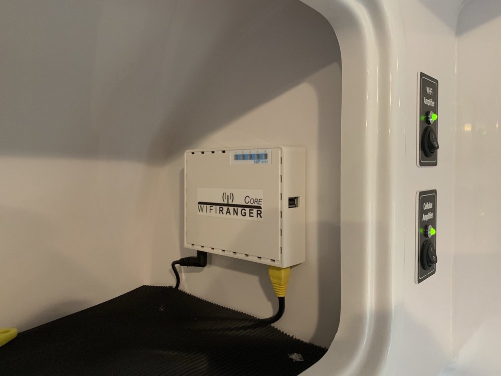

Noticed that we were not picking up a signal from the WiFi ranger that had previously been working fine. Troubleshooting I noticed no lights on the box itself but the switch outside the cabinet (green light for power) seems to be on/working correctly. I have unplugged and replugged the power cord and did not see any power button or on/off switch on the box itself.
Any ideas from the community? Anyone else experienced this?

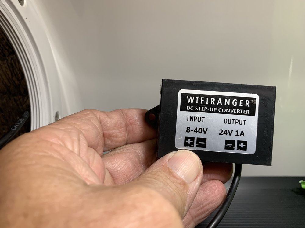

Thanks Overland - I was already in the process of exploring that area and testing. Looks like the switch (outside the cabinet wall) is okay - it is providing power to a step up converter (photo) I discovered in that access compartment, however there is no power reaching the wifi ranger box itself. Based on what I've learned I'd say that converter is the problem? At this point I have sent an email to Jason Esray and I also plan to reach out to the WiFi Ranger tech support team during their normal business hours this week.

It is likely the 24v step up transformer that has failed. The router uses a common 5.5x2.1mm DC connector and can run on anything between 10v and 50v. The step up transformer is used in RVs to reduce router performance issues that sometimes occur when the house dc voltage drops below 12v.

edit.... they do fail, they have a $30 version.  “The V2 model is more reliable and robust than the original 24V Step-up Converter.”
https://wifiranger.com/shop/product/66-24v-step-up-converter
Jason confirmed that it is most likely the step up converter and is going to send us a replacement - will be interesting to see if it is the V2 that John Davies inserted a link for???? BTW - this failure is NOT the result of house batteries falling below 12 volts!!

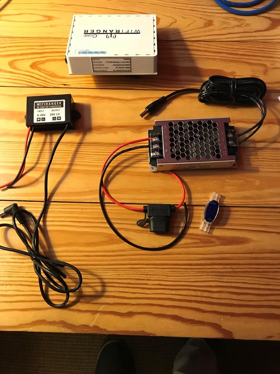

We also just had the DC Step-up Converter stop working which supplies power to the WiFi Ranger. Now there is a WiFi Ranger Company Technical Service Bulletin regarding the issue. The Tech Bulletin will allow you to enter your WiFi Ranger ID, found on the unit, to determine if your Step-Up Converter needs to be replaced. It also indicates that it is possible to damage the WiFi ranger if the Converter overheats. I haven't installed my new converter yet to test if mine was "toasted". As you can see in the pic the V2 is much more robust. I plan on using heavy duty velco or 3M adhesive to secure it.
https://wifiranger.com/tech-bulletins
[attachment file=Wifi Ranger pic 2.jpg]
