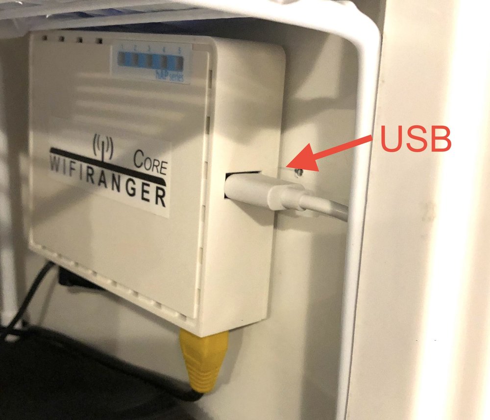

To tether my Jetpack to the WiFi Ranger, I bought a white 10-foot USB-A to USB-C cable from Amazon. USB-A is the common USB connection that has been around for years. USB-C is a newer type connector, and I need that because my Jetpack has a USB-C port for both data transfer and for charging. Your hotspot or phone could have a different connection port, and you would need a different cable.
I plugged the USB-A end into the side of theWiFi Ranger Go2 router, which is in the cabinet above the dinette. I ran the cable along the back of the cupboard until the center of the cabinet, then under the rubber mat in the cabinet and out the grommet that has the cable for the WeBoost interior antenna. I then wrapped the cable around the window, behind the frame that holds the window shades. The 10-foot cable was the perfect length to reach the center of the dinette table.
