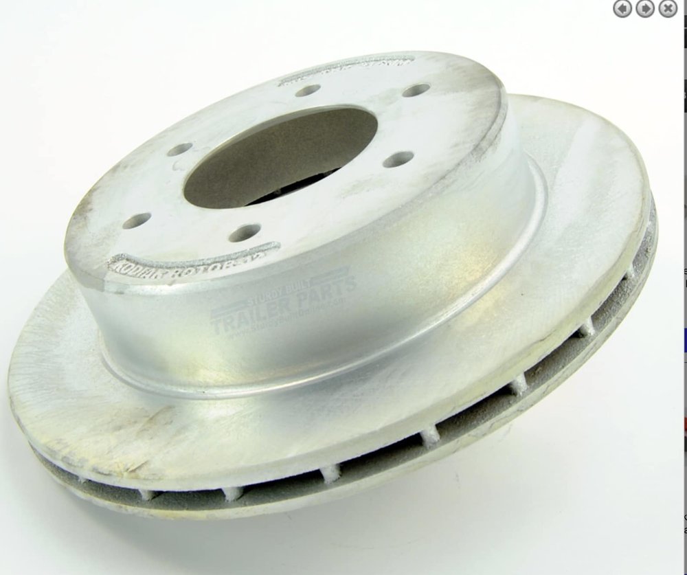

In your shoes I would be thinking hard about new 5200 pound axles with bigger bearings and IDLER hubs, and Kodiak disk brakes with slip-over-hub rotors. You can easily carry a spare conventional idler hub assembly since they are so very compact and cheap. Dexter parts are idiotically expensive and you should consider aftermarket marine (boat trailer) parts.
