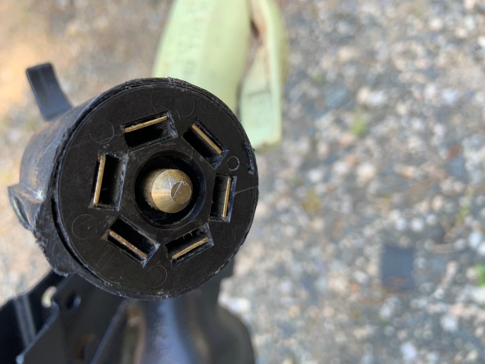

Dave and Cindy Posted April 30, 2019 Author Share Posted April 30, 2019 Well that did not work unless I did not do it sufficiently. It appears clean and dry. I am attaching photo. Any other suggestions as to a cause or how I might clean this better? Appreciate any help. Dave & Cindy #076 Photographer * Traveler www.twolanetouring.com Posting Daily - National Parks, Camping and more. Link to comment Share on other sites More sharing options...
John E Davies Posted April 30, 2019 Share Posted April 30, 2019 You need to take the center part out of the housing to check for corrosion where the wires hook up inside. Usually there is a clamp where the cable enters in back, and also a small set screw that goes in from the side to anchor the inside part. I don’t have any pics, but I am pretty sure the Ollie one is built that way. Those little lights are called running lights, the ones up top are clearance lights. John Davies Spokane WA SOLD 07/23 "Mouse": 2017 Legacy Elite II Two Beds, Hull Number 218, See my HOW TO threads: Tow Vehicle: 2013 Land Cruiser 200, 32” LT tires, airbags, Safari snorkel, Maggiolina Grand Tour 360 Carbon RTT. Link to comment Share on other sites More sharing options...

Dave and Cindy Posted April 30, 2019 Author Share Posted April 30, 2019 Super, thanks, that fixed the light problem (and thanks for the terminology). My last question is this something that is ok to just thoroughly clean or should I replace this part. Also, when I put it back together can I seal it with a gel that I can break loose but that ought to keep out dirt and water? 1 Dave & Cindy #076 Photographer * Traveler www.twolanetouring.com Posting Daily - National Parks, Camping and more. Link to comment Share on other sites More sharing options...
John E Davies Posted April 30, 2019 Share Posted April 30, 2019 That is pretty gross, but I guess you found your problem. That blue-green glop is corrosion and it is conductive, so current is flowing where it should not. You can clean it up with isopropyl alcohol or electric contact cleaner (not a harsh one like brake cleaner) and an old toothbrush. That will probably keep you on the road for a few months. As bad as that looks, I would consider putting a complete new harness on the trailer. The inside of the wires, the copper conductors, are also corroded and you can't clean that.... There is really no way to stop moisture from entering, but it is OK to seal the back where the cable enters to keep out water, using silicone sealer, and always leave the plug hanging downward when not hooked to your truck. That way any moisture will hopefully drain out. You should spray some cleaner inside annually at least, to just flush out the crud. If you have compressed air, blast it afterwards, watch your eyes! This might help.... http://olivertraveltrailers.com/topic/how-to-junction-box-for-trailer-harness-repair-or-extend-the-harness/ Good luck, John Davies Spokane WA SOLD 07/23 "Mouse": 2017 Legacy Elite II Two Beds, Hull Number 218, See my HOW TO threads: Tow Vehicle: 2013 Land Cruiser 200, 32” LT tires, airbags, Safari snorkel, Maggiolina Grand Tour 360 Carbon RTT. Link to comment Share on other sites More sharing options...
Moderator+ ScubaRx Posted April 30, 2019 Moderator+ Share Posted April 30, 2019 Those plugs tend to get moisture inside when it rains. Try to store it somewhere it can stay relatively dry. What happens is the moisture will short the positive (connected to the batteries) to the wire going to the clearance lights and make them come on. I wouldn’t seal it up too tightly. If moisture does get in it will just make it harder to remove. Steve, Tali and our dog Rocky plus our beloved Storm, Lucy, Maggie and Reacher (all waiting at the Rainbow Bridge) 2008 Legacy Elite I - Outlaw Oliver, Hull #026 | 2014 Legacy Elite II - Outlaw Oliver, Hull #050 | 2022 Silverado High Country 3500HD SRW Diesel 4x4 Link to comment Share on other sites More sharing options...
