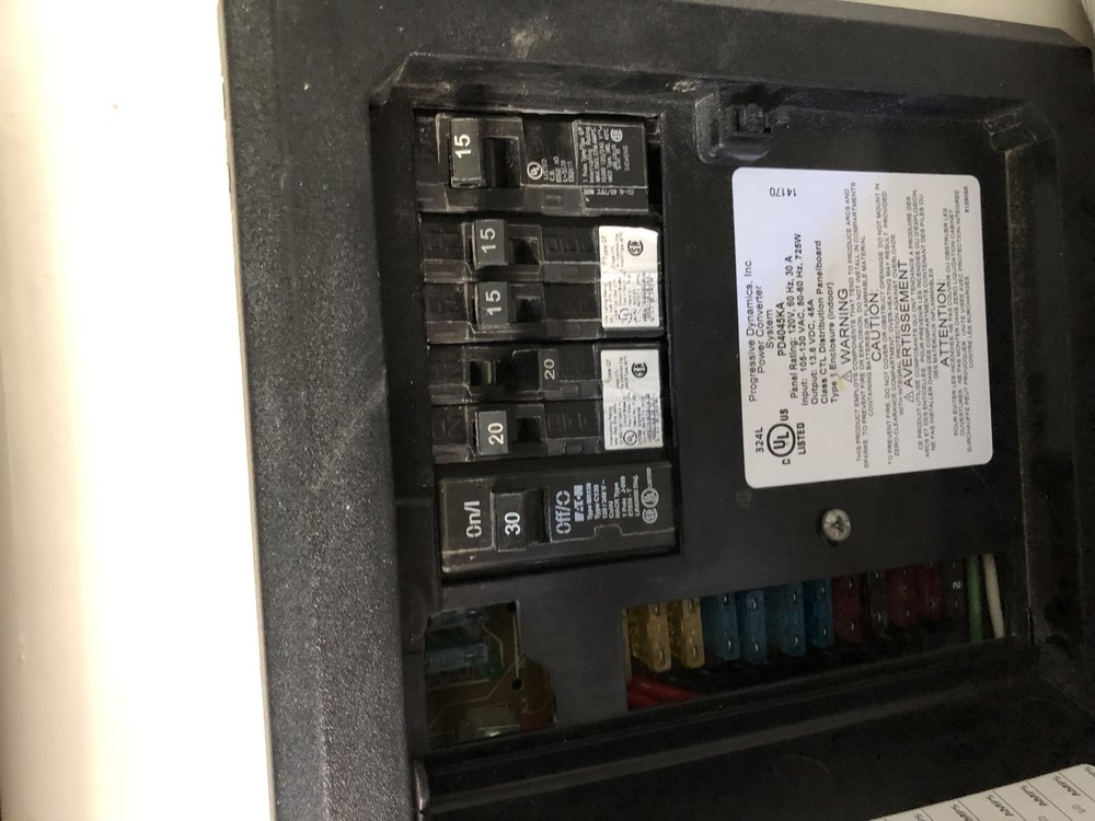

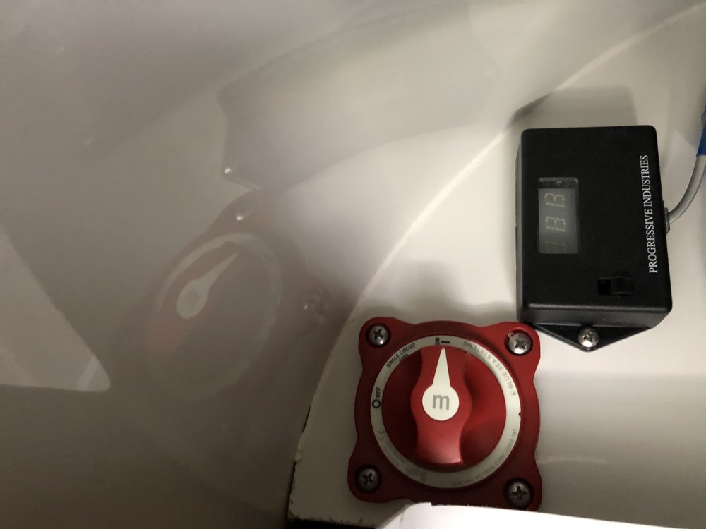

the one breaker is turned off ? Also what is the red knob for and the black box.  Stove is not getting gas but propane port is getting gas. How to manually raise and lower all jacks

the one breaker is turned off ? Check the breaker/fuse label on the inside of the breaker panel door.
Also what is the red knob for and the black box. The red knob looks like a battery shut off.  It probably turns off the supply 12v into the trailer.  The black box is a remote display for the surge protector.

Given the location of the red switch, it could be a cutoff for the solar.  It's a high amp DC switch, so it would either be that or as previously mentioned, a disconnect for the batteries.  I believe that the earlier models had these switches and at some point they stopped putting them in.  I'm guessing that Oliver experimented a bit in where they were located as well.  That, or the previous owner installed it.
