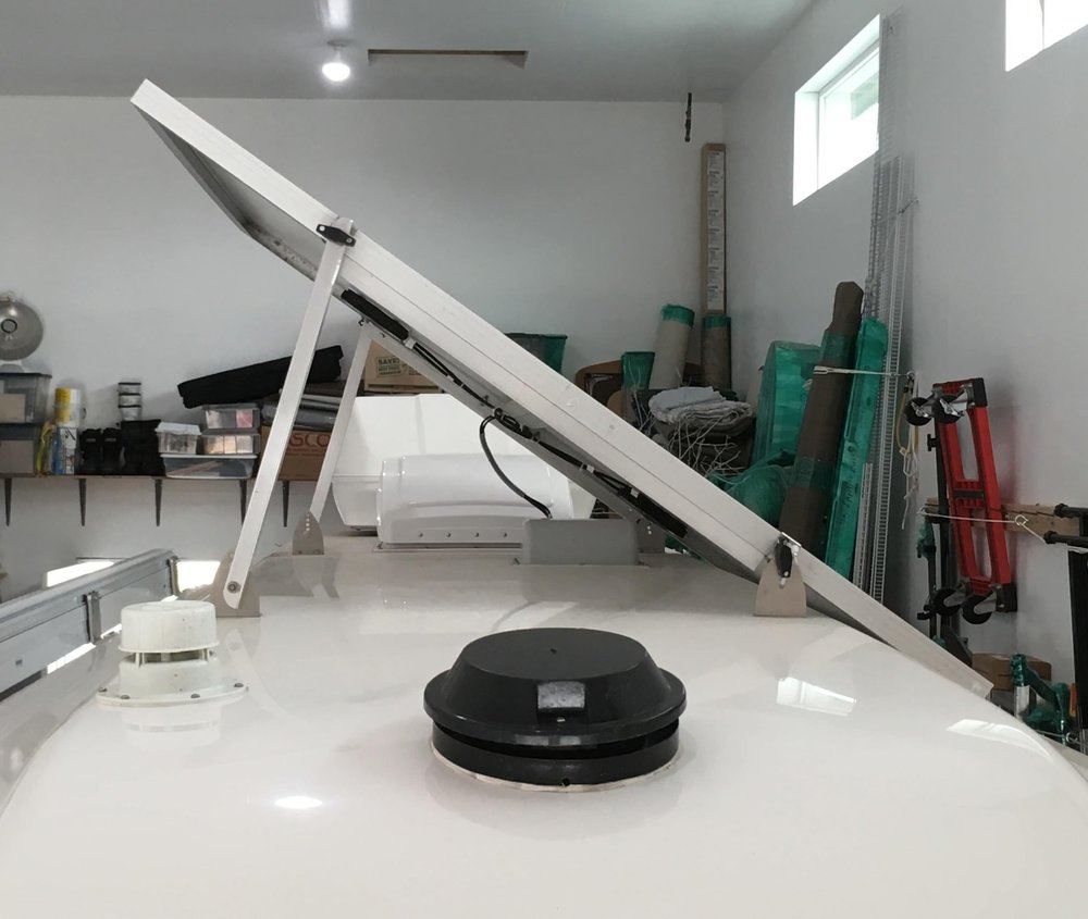

Mike, I have awnings on both sides so they mount the same. Oliver did the mounts for me and I’ll post some photos below. You might call service and see if they’d do the same for you.
Not sure about mounting them at an angle since what you gain one side you’d lose on the other so it would probably be a wash at best. Some of the Ollie solar pioneers mounted their larger panels at an angle like you’re talking about so you might search some of the early posts for photos.
It would be nice to somehow hinge them or attach them with pins so that they can be removed for cleaning. Though as mine are, I can clean under them though it’s a bit of a bother.
The A/C is the only thing to worry about shading the panels but that’s late in the day when you aren’t getting much solar anyway and shading those panels won’t affect the others.

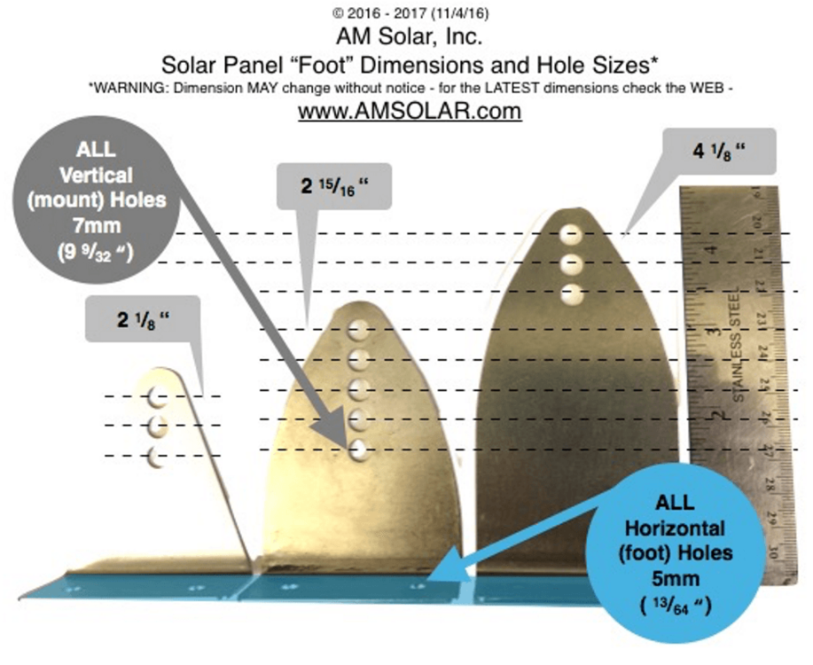

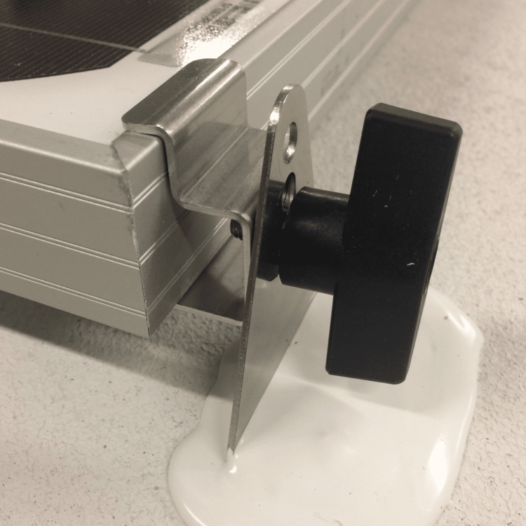

So I was thinking about what @Overlander and @John said regarding cleaning and the fact that I don't have an awning on the curb side. Thought these might work on both sides in the same fashion (tall version at least on passenger side). If I mount them the way AmSolar recommends with VHB tape and sealant I don't even have to drill any holes. The mounts would be on each end and if it worked out properly you could lift up for cleaning and/or tilt when warranted.
https://amsolar.com/rv-mounting-accessories/91m-35mz
Looks like it would work. Of course, it would take a lot of faith to trust VHB tape only. I know it should work - I think half my truck is put together with that stuff - but...still.
I think those brackets would be fine, but personally I would choose 3M 4200FC Marine adhesive/ sealant and large stainless screws to mount them to the roof (fully bed the brackets on a layer of sealant and also cover the screw heads after tightening). The RV (Dicor self leveling?) sealant they show in the second pic is barely acceptable and it requires constant vigilance and occasional renewal when it starts to fail... why not use a forever trouble-free mounting method? Be very aware of the instruction cautions. ....  https://www.3m.com/3M/en_US/company-us/all-3m-products/~/3M-Marine-Adhesive-Sealant-Fast-Cure-4200FC/?N=5002385+3291170224&rt=rud
Drill the knobs and secure them closed with nylon wire ties, they will loosen, just like the ones on your main panel. Good luck and post pics.

The people at AmSolar have been very nice and helpful. Ended up purchasing everything through them. Plan to do the install when we get back from the Smoky’s. Pulled this from their website...
“ Roof Attachment
Fiberglass roofs – We have been using a type of 3M double-sided tape on our mounts since the mid 1990’s, and we have never lost a panel.  As long as the tape is properly installed on a clean surface at the correct temperature, it will hold.  As an added level of protection, we use a layer of Dicor self-leveling sealant around the entire perimeter of the mount, and cover the screw holes/heads as well.  The sealant protects the tape and any potential roof penetrations from water intrusion and decay.”
So I am going to give it a try and will post pics later. Thanks for everyone’s input.
