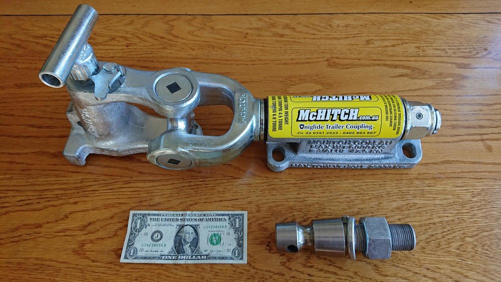

The hitch, as advertised, is from McHitch in Australia.  It's one of their automatic hitches in the 4.5 tonne (of the metric sort) version.  The jack is an XO 750, also from Australia.  You have to buy the hitch directly from their factory, but you can find the jack here in the US.  The hitch was $750 shipped; the jack, $250.  (The hitch price may have been Australian dollars - I can't tell from their invoice.)
To attach the hitch to the Ollie's tongue, you'll have to have an adapter made, like this:
The hitch bolts into the adapter and the adapter bolts into the same two holes on the tongue as the Bulldog, making them interchangeable.  The female portion of the hitch will mount directly to any ball mount. IMG_2075.thumb.jpg.b2aada4c5bfb0808d173ff41dd6db7aa.jpg
The jack also requires a bit of work.  The bolt spacing on the jack's mounting plate actually aligns quite well with the Ollie's tongue, but if you mount it directly to the frame, then the wheel just doesn't quite clear when folded:
And there's no room to scoot the jack forward.  You can fold it back the other way, but then the wheel is far enough forward to hit the truck in a tight turn -
So you have to make some spacers, or if the guys in service are still as unbelievably nice as they were when mine was being built, maybe they'll make some for you.  The ones they made for me are cut from 1" aluminum:
So that's what we're talking about and how it attached to the trailer, but people are probably thinking - What again?  Why did you spend money on this?
The hitch, first: a multi axis hitch allows much greater articulation between the truck and trailer when going off road.  Dips and twists in the road that would otherwise bind up a standard ball hitch are no problem with a multi axis hitch.  There's also zero possibility of the trailer coming loose from the truck, thanks to the safety pin.  The typical problem with these hitches, however, is that most designs are very difficult to align, and as such are commonly only used on small trailers that can be manipulated into place by hand.  The McHitch fixes that problem by being largely self aligning.  All you do is line up the hitch laterally when backing up to the trailer, then adjust the trailer height to match the truck's, then back into the hitch and it locks itself in place.  The McHitch has two locking mechanisms: the first is the lever bar that drops into the groove on the main pin.  That both holds the pin and lets you know that it's attached.  Then you slide in standard locking pin a safety.  Here's a video of how it works:
It really works as advertised, and I actually enjoy hooking up and unhooking because it's so dead simple and quick.
The u-joint on the hitch is from a Land Cruiser, so it's easy to source should it ever start to wear out.  Maintenance is just greasing the u-joint once a year and keeping the locking bar greased so that it moves freely.  I was a bit worried when I greased the u-joint that the pin would droop, making it difficult to hook up.  But so far the u-joint has maintained it's stiffness.  And it gets so little wear relative to what it was designed to do that it may never loosen up that much.  You can get a WD attachment for the hitch if you want - I don't have it, and so can't comment on how easy or difficult it would be to attach to the Ollie's frame.  There's also a keyed lock for the safety pin.  The caps on the u-joint mounts are magnetic, so I use the top one to hold a little Nitecore LA10 flashlight/lantern when hooking up in low light -
The XO jack serves three purposes.  First is that it absorbs the bump from when you back into the McHitch.  The Ollie's jack isn't designed to take that kind of force, so over time, either the jack or its mount are likely to get damaged.  And of course if you were to bump the trailer particularly hard, then you might just destroy the jack or its mount in one go.
The second purpose for the jack is that it provides an easy way to line up the trailer vertically with the truck, which I'll explain later.
And the final purpose is what it was designed to do - allow you to recover the trailer if it's stuck, or maneuver the trailer while not attached to the truck.  The jack is very stout, and strong enough to support the trailer while being winched.  I haven't yet gotten the trailer stuck enough to use it like this.  (I've gotten it stuck once, but was able to use traction mats on the truck to get both it and the trailer back to dry land.)  But I have used it to maneuver the trailer around in a tight campsite, and it works perfectly in that situation.  Here's a video of the XO jack in action:
Obviously, you want to use extreme caution when using the jack in that way.  It doesn't take much of a slope for the trailer to get away from you.  Likewise, you need to use caution if you use the jack while hooking up or unhooking your trailer.  I leave the safety chains attached until I've fully unhooked the truck from the trailer and placed the weight of the tongue onto Oliver's jack.
The bonus to using that method is that the XO jack remains set to the truck's height, ready to be hooked up again.   When it's time to hook back up, you just lower the tailer down until the XO jack is taking the weight, and you're all set to hook up.  In cases where you have to lower the trailer's tongue to level, then I first raise the tongue, then swing the jack forward or lift it using the height adjustment pins, and then lower the trailer down to level.  Hooking it back up would then be the opposite of that.

I have a new McHitch 6 tonne, with vertical pin, sitting right here waiting for my new HQ19 to arrive so I can install it.
If you can snap a photo of it, I'd like to see it.  When I bought mine, I asked about the 6 tonne, and Joe told me that it was exactly the same as the 4.5 tonne, except had a larger shank, which he included.  And the documentation I got with the hitch said that it was a 4.5 or 6 tonne model, depending on the shank used.  The hitch itself is stamped 4.5 tonne.
But the photo on their website for the 6 tonne is clearly a different hitch.
So I'm curious which one you got.  Not that it really matters, since @10,000lbs, the 4.5 tonne hitch is more than enough.
If you can snap a photo of it, I’d like to see it. When I bought mine, I asked about the 6 tonne, and Joe told me that it was exactly the same as the 4.5 tonne, except had a larger shank, which he included. And the documentation I got with the hitch said that it was a 4.5 or 6 tonne model, depending on the shank used. The hitch itself is stamped 4.5 tonne.
So I’m curious which one you got. Not that it really matters, since @10,000lbs, the 4.5 tonne hitch is more than enough.
The 6 tonne and the 4.5 tonne are significantly different.  When I was deciding on which one to get, I didn't see the self aligning 6 tonne.  A closer look recently, and your explanation makes the self-aligning design look very convenient.
The 6 tonne uses a 10 ton truck U joint that is quite large and it has a much larger shaft going through the bracket.  I'm not clear what the rating means, in other words, how much safety margin is there beyond the rating? And how much tongue weight is each one designed for?
My HQ weighs about 6,300 lbs dry and is rated at 10,000 GVW.  Each tonne is 2,200 lbs, so the 6 tonne is rated for a trailer of  13,200 lbs. More than enough. But the 4.5 tonne is rated at 9,900 lbs.  I expect my HQ will never weigh more than 7,500 lbs.
A WDH adds another factor.  I don't plan to use one and the rated tongue weight of the HQ is lighter than my Oliver's measured tongue weight or 560-570 lbs.  I think I'd prefer the 6 tonne hitch with a WDH, but without it, it's a toss-up.
Looking at the stock articulating hitch that comes with the HQ, it looks weak compared to the 4.5 tonne and I don't like the design.  That is why I'm changing it.
Reading the information on the McHitch site revealed that they took the 3.5 tonne model and made it into a 4.5 tonne by using better steel.  That's it.  No dimensional changes.  The plug pieces are all the same across the board, except the shank size jumps from 7/8" to 1 1/4".  Both the 4.5 and the 6 have the same bolt pattern on the tongue
Bottom line:  I'm thinking of using the 6 tonne "drop on" I bought, on another trailer and getting a "self aligning" 6 tonne for the HQ.  The basic design and stresses involved, plus the ease of use, favor the self aligning one.  Another factor is that the "drop on" might interfere with the tailgate when aligned properly with the very high tongue on the HQ.
Initially, I liked the drop on because the towing load was not being applied to the safety pin, as it is in the self aligning design.  This seems like a high stress area and a point of wear.  But it is rated to handle that and the ease of use is a nice factor.
Given all of that, what do you think?
Here's a picture:
John
