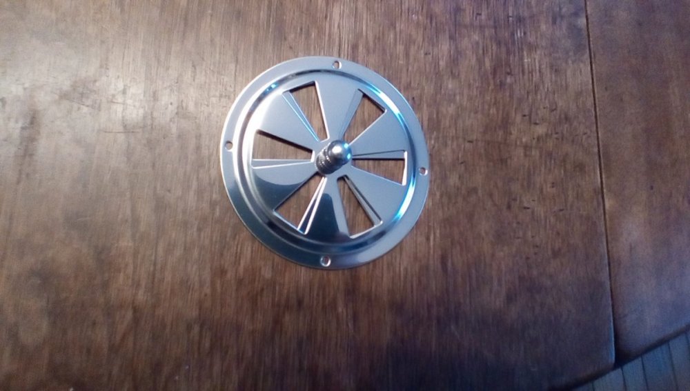

I am going to install a vent high up to the left of the bathroom door. It was a Fall project, but Winter decided to visit. If you have ever had the bathroom fan going, and closed the door, you have heard it struggle to get enough air. By the same token, it must be hard for heated air to get in there, through the heating system, with the door closed or the vent closed (restricted). The hope is with freer flowing air there will be less noise from the furnace system.
I like your vent solution, Mainiac.
