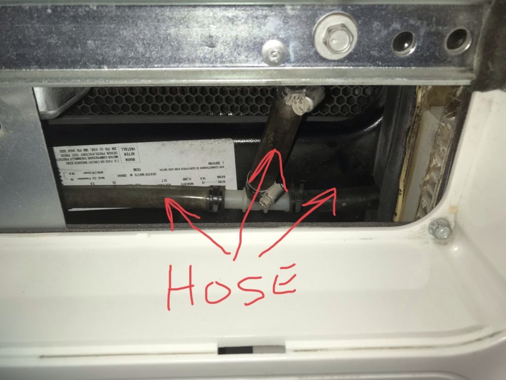

Moderators mossemi Posted June 12, 2020 Moderators Posted June 12, 2020 (edited) Yes it does Nan. Look under the back street side corner and there should be a weep hole cover and then the hose. Mine has about an inch or so protruding out of the hull. I have never cleaned the drain tube, but you can try very short burst of water from a garden hose into the drain hose from the bottom. And you can remove the return air filter grate and access the upper portion of the hose as shown in the picture. FYI, although you can’t see it in the picture, the hose drains to the upper right, behind the big bolt head. Mossey Edited June 12, 2020 by mossemi Typo 1 1 Mike and Krunch Lutz, FL 2017 LEII #193 “the dog house”

Moderators mossemi Posted June 12, 2020 Moderators Posted June 12, 2020 I am sorry if my comments are confusing. The weep hole cover does not have anything to do with the AC drain hose/pipe. I mentioned it as a location reference point. If you open the basement door and look at the back wall you should see a white or translucent hose/pipe running vertically about where the inside of the tail light fixture would be. That is the AC drain and you can pull the floor mat back and may need to remove that section of the floor to see the exit hole. Mossey 1 Mike and Krunch Lutz, FL 2017 LEII #193 “the dog house”
