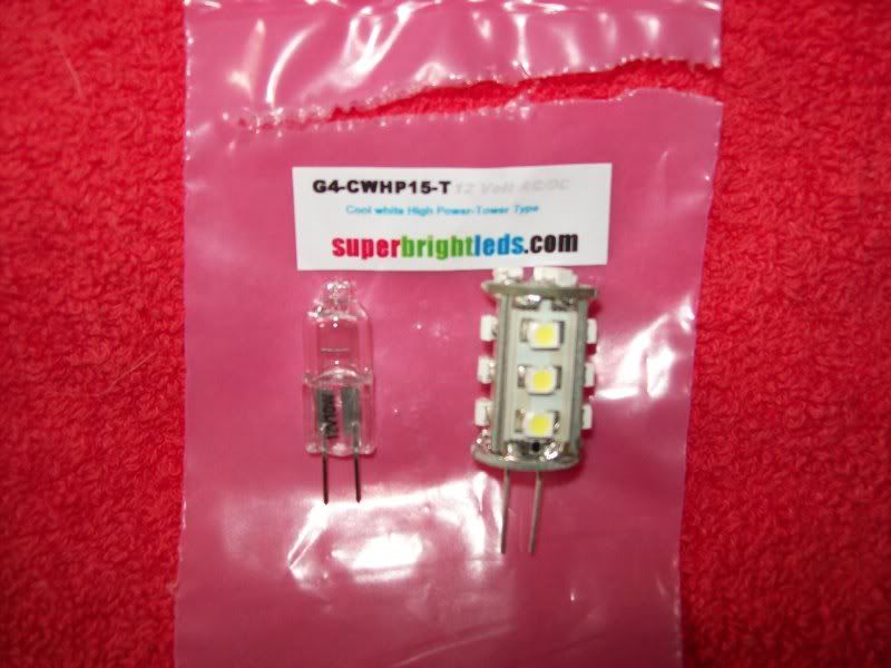

While at the Lake Greeson Catfish Camp earlier this week, Cajun Birdman, Aubrey, showed us his LED conversion reading lights. They were plenty bright at 75 lumens, and the variable intensity seemed more than adequate. We got the part number and the web URL from him and placed a order that day.
Though we are still at the Lake, we picked up the LED's when we went to feed the critters at the house.
Here is a short video that will give a look at the variable intensity. There are fifteen LED's on the replacement, and they are a bit higher. They don't seem to be available on eBay yet.
Click the link to view the Youtube video:

Here is a photo showing the web address, the part number and a side by side comparison of the G4 base bulb to the 15 LED replacement.
Share this post
Link to post
Share on other sites

I just installed the LED replacement for our reading lights. You don't get the ablility to dim nearly as much as the holagens, but love the light and the abscence of radiant heat. Wih these lights now LED our trailer is 99% LED lights. I replaced all the pucks, plus the exterior lights and even two of the bulbs in the third brake light. The one in the center is still a standard only because the LED's don't illuminate the entire lens as well has the standard bulb.
