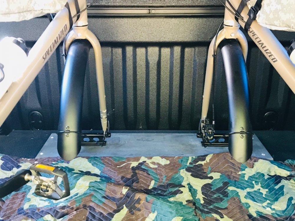

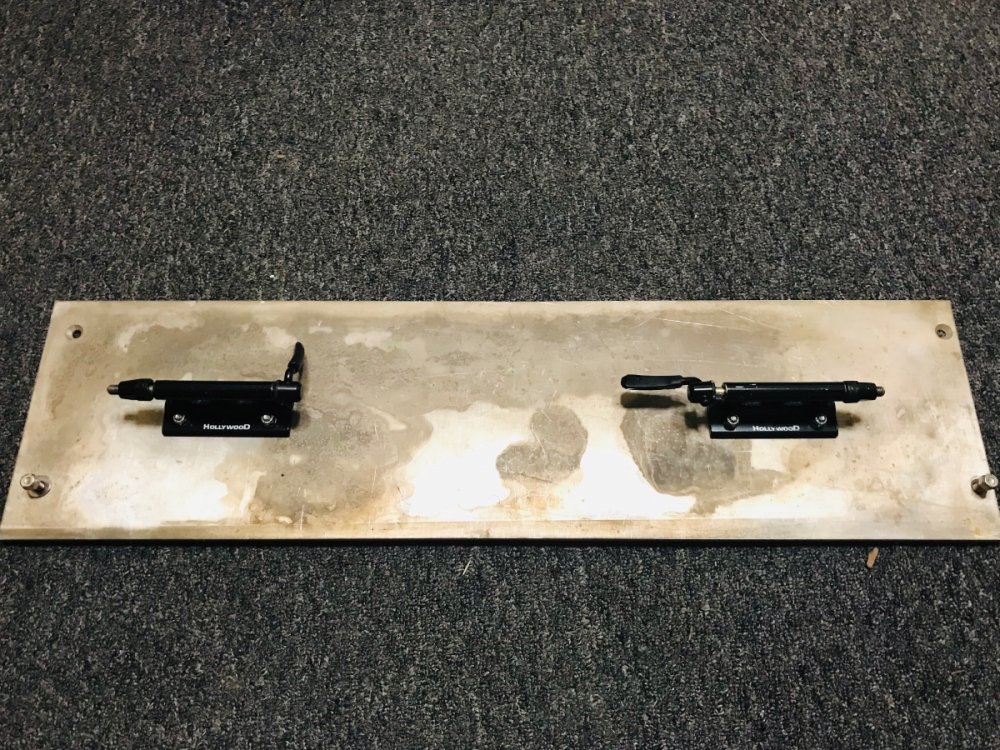

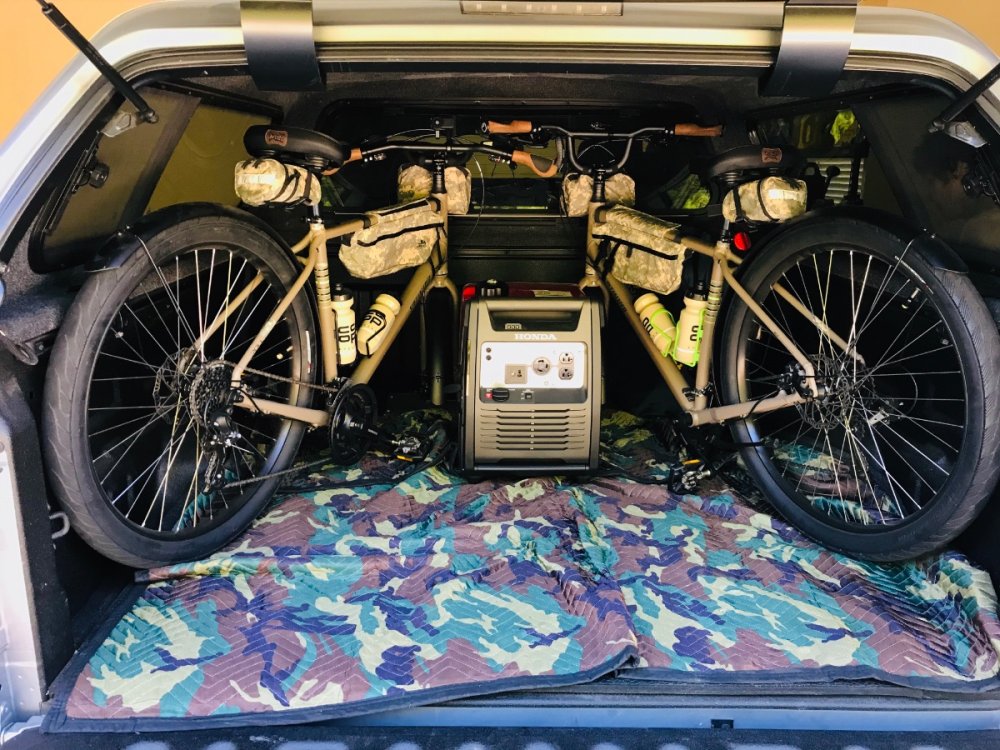

With an 8’ bed on your tow vehicle I would think it sure would be much easier to just use a extremely stable aluminum plate fork mount (pictured) and you would still have more than enough room for plenty of gear. I was able to carry all our gear in the short bed of our former TV with this configuration. Do you have a topper or camper shell on your F 350? With the new SD Tremor we will have more than enough room for cargo with a 6 3/4 bed and ARE topper and actually room to spare.
The Pros I can think of - bikes are clean and out of the weather, secure bicycles, and you can just leave your bicycles In the bed and then take them with you when you want to ride and enjoy explore a local rail trail or town or park. Not unload off the Ollie or rack and reload them into your TV bed to take them somewhere...more unnecessary work IMO.
Another plus is you won’t have to take the “bike rack” off the Ollie and add it to your TV. Just leave them inside the truck bed/topper until your ready to ride. It takes me maybe 8 min to remove two bicycles and remount the front wheels, not at all difficult. If your carrying cargo to fill an 8’ bed of a super duty you maybe want to rethink/reconfigure how much your carrying. In the attached pics I have loaded a Tundra bed with a Honda Handi generator,  adult XL and L bicycles, a Yeti Tundra cooler, 2 chairs, exterior pvc carpet, small table, Weber Q1200 and other misc camp set up gear. Not a whole lot of room to spare, but adequate.

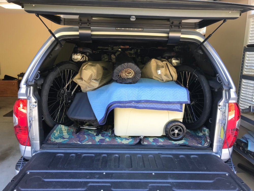

The camper shell works out great for the bikes.  I like the looks of Patriot's system, but I'm lazy so I just leave the front tires on and lean the bikes to get them through the back door.  Once in the shell they can stand up straight and I just use tie down straps to secure them there.  I have a hitch bike rack that I've used over the years when my truck bed was full and we still wanted our bikes - but I don't like that much because the bikes were always filthy after a trip - including fine dust and dirt in the chains, etc.  I like them inside for sure.
I've only had to take my shell off maybe a half a dozen times in the 14 years I've had it.  I have an easy system where I can take it off and put it on by myself - takes about 30 minutes for each.  I use a pair of 2' x 4's suspended from my garage ceiling by ratcheting straps.  I slide the boards under my topper and then ratchet it up off the truck and drive off.  Even so, I think if I had to take it off a lot more often I'd think twice about it too.  I see why you might be hesitating to get the bigger top...  not quite as easy to work with as the tonneau covers.
