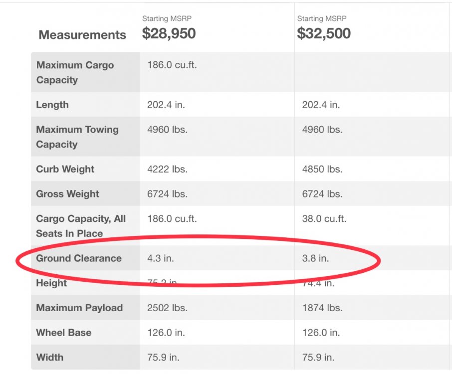

John E Davies Posted October 3, 2020 Posted October 3, 2020 (edited) Your payload is actually pretty adequate, for the small Ollie and one person, especially with the two rear seats removed. Try this.... drive your van to some places off -pavement that you think you might want to visit with your future trailer. I am pretty sure the van simply won’t get there, much less with a trailer on the back. Your city van has a pretty long wheelbase and with such low clearance it will drag something important. Research Breakover Angle Have you looked underneath? What is the low point? I had a 2007 RAV4 which is just a rebodied Corolla sedan. It had 6” clearance. Toyota unwisely ran the exhaust system in a sharp loop under the rear suspension, instead of over it.... that trucklet was hopeless on even the most gentle of uneven terrain. Their new Adventure model got a 1/2 inch “lift” by fitting taller tires plus lots of plastic cladding. I haven’t looked to see if they moved the exhaust.... where I am getting is, a car based TV is simply the wrong choice for where you want to “adventure”... You should get a truck. Otherwise you will damage stuff, get stuck, have to deal with the heartbreak of getting towed and paying to fix what you broke. A pickup or tall SUV means lots less stress to the TV and WAY less stress to you. Which is the most important factor. Your Metris is remarkably similar to the Ford Flex. Neither has nearly enough clearance in the middle, even though the Flex has 2 more inches.... if you scrape a simple concrete parking barrier with the front air dam, imagine how that will work when things get tougher... John Davies Spokane WA Edited October 3, 2020 by John E Davies SOLD 07/23 "Mouse": 2017 Legacy Elite II Two Beds, Hull Number 218, See my HOW TO threads: Tow Vehicle: 2013 Land Cruiser 200, 32” LT tires, airbags, Safari snorkel, Maggiolina Grand Tour 360 Carbon RTT.

Mch Posted October 3, 2020 Author Posted October 3, 2020 Well... damn excellent points across the board I do believe under the van does not have low parts but I will take a closer look for sure. I want to do a lot out West— hit National Parks etc. possibly an eventual drive to Alaska which now seems quite out of the question for Metris I’m sure. wow... a breakdown in the wrong location could be very complicated. I think I’ll start with Metris for some local o camping I plan to do before a long trip and upgrade once I have a clue what I’ll want. I’m assuming there’s already a thread for recommended used TVs out there. Many thanks for the insight!
