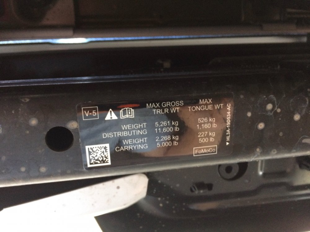

Moderators topgun2 Posted December 2, 2020 Moderators Share Posted December 2, 2020 Yes you will need the Andersen since Ford requires one anytime you tow anything that has a hitch weight of 500 pounds and over. There is probably a sticker on your hitch assembly - look under the rear of the hitch. Certainly with the "max tow package" your F-150 can tow without a weight distribution hitch and I've never heard of a Oliver swaying. However, the Andersen will lessen "porpoising" (the bouncing caused by things like bridge bumps on Interstates and may improve handling in the event of emergency maneuvers. And, since Ford requires it, you subject yourself to legal issues in the event of an accident if you don't use it. Bill 1 2023 Ford F150 Lariat 3.5EB FX4 Max Towing, Max Payload, 2016 Oliver Elite II - Hull #117 "Twist" Near Asheville, NC Link to comment Share on other sites More sharing options...

Hokieman Posted December 2, 2020 Share Posted December 2, 2020 Agree with Bill. I’ve got a 2019 F150, scheduled for pickup after you. Attached is a photo of the sticker on the bottom of my receiver. Also a link to an article about the legal requirements. In the unfortunate event of a crash, insurance companies are not responsible to pay if OEM specifications are not followed. http://www.trucktrend.com/how-to/expert-advice/1703-tow-ratings-and-the-law-discussing-limits-of-trailer-size/ 1 “Ramble” - 2021 Legacy Elite II #797; 2020 Ford F-250 Link to comment Share on other sites More sharing options...
