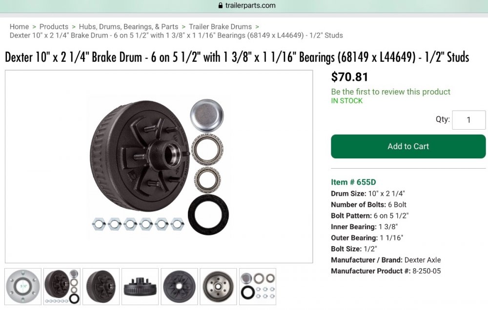

I need to rebuild one axle before I head up to Alaska in the Fall, I already did the other one due to a seal leak (and I swapped the brakes for the much more reliable manual adjust type). I would love to install disk brakes but that is not going to happen for a while. I blew my Ollie Ca$h Re$erve already over the winter, big time. 😥 I need to order a pair of manual adjust brake assemblies and 2 hub assemblies. I found these.
And these:
They ship FREE and the cost is a whole $100 less than the same exact OEM parts from eTrailer.com. Any other suggestions, or is this a winner? FYI I will install really good Timken bearings, races and seals, and use really good grease.

John, I rebuilt my axles this past November and purchased all of the parts from Textrail. The facility that I happened to order from is in Cookeville Tennessee. Complete hub/drum assemblies including bearings were something like 45 +/-dollars each. Complete brake assemblies ready to mount were about the same 45 +/- dollars each for the self adjusting type. The manual adjustment type is less. My complete rebuild of four complete brake assemblies, four complete drum/hub/bearing/seals assemblies including shipping to my door was around $500. Hope this helps
Side note: These parts were all genuine Dexter not an off brand.
Edited by mountainoliver

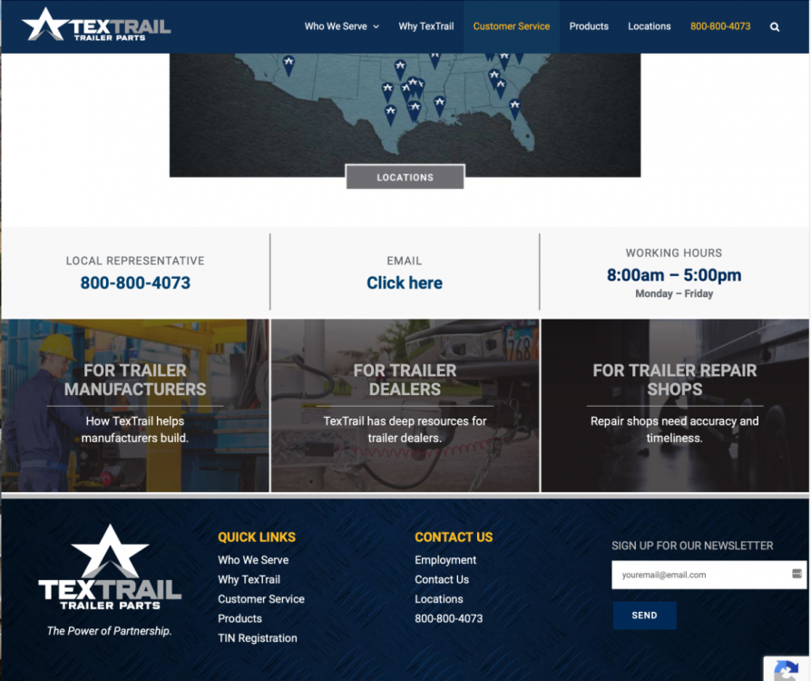

Is there a retail website? The only one I found is for manufacturers, dealers and repair shops. I would love to order at wholesale, but I have no affiliation with a shop. The closest Textrail dealer is near Boise, almost 300 miles away.
Thanks,

The facility that I contacted is over 400 miles from my home. I first contacted the Dexter representative that had been at one of the Oliver rallies, he suggested that I call this particular distribution facility as it would be closest to me and just talk to the sales department. I know of another owner who called this facility after I did and also ordered the same parts for the same costs. I would call your closest distributor and get a price quote. Maybe the difference was me ordering four sets of everything. I tried to pm you and a note  came up that you weren’t receiving pm’s. If we can get that fixed, when we get home from our trip I’ll send all the information that I have.
