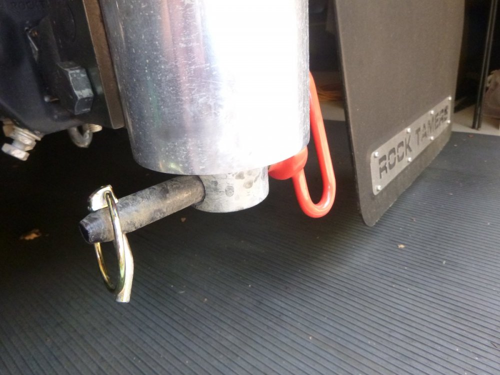

Here is a "Nice Tip" I got during the Oliver Rally in Alabama, which I think will make life a little easier.
I don't remember the guy's name, but I think it is a great Idea, thanks!
Basically, it involves replacing the original 5/8 inch Silver-Pin/Light Duty Spring Clip with the Red-Pin/Heavier Duty Spring Clip. IMHO, there are several benefits, 1. The Pin has a Handle (Red) which makes installing and removing the Pin much easier. I also elected to get a 1/4 inch Spring Clip which is much heavier than the Stock Clip, and therefore is harder to come out accidentally. 2. The 5/8 inch Pin has a Tapered Tip so it can aid in centering the Pin into the hole. 3. The Pin (p/n 269028) is available at Tractor Supply for only $4.99, the Spring Clip (p/n 268616) for $2.99.
Finally, I put a light coat of Vaseline on the Pin and in the corresponding holes in the Hitch to make inserting the Pin a little easier, it won't stain your cloths either.

p.s.  note the "keeper pin" on the hitch pin - it has a slight bend at the bottom which helps to prevent it from coming out.  I don't think that you can purchase them like this as I bent this myself using a vise and a two pound hammer.
I've got the same Locking Pin'Ring set up, but prefer the Heavy Duty 1/4 Spring Clip. I think it is harder to accidentally fall out.
