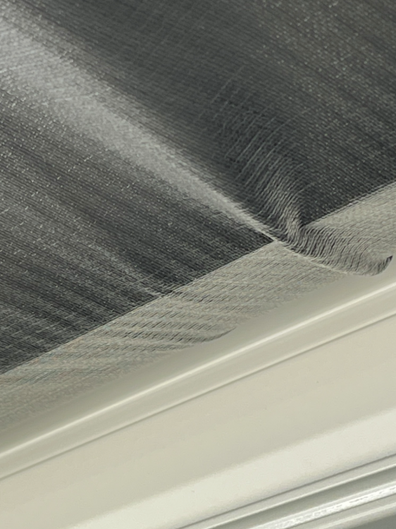

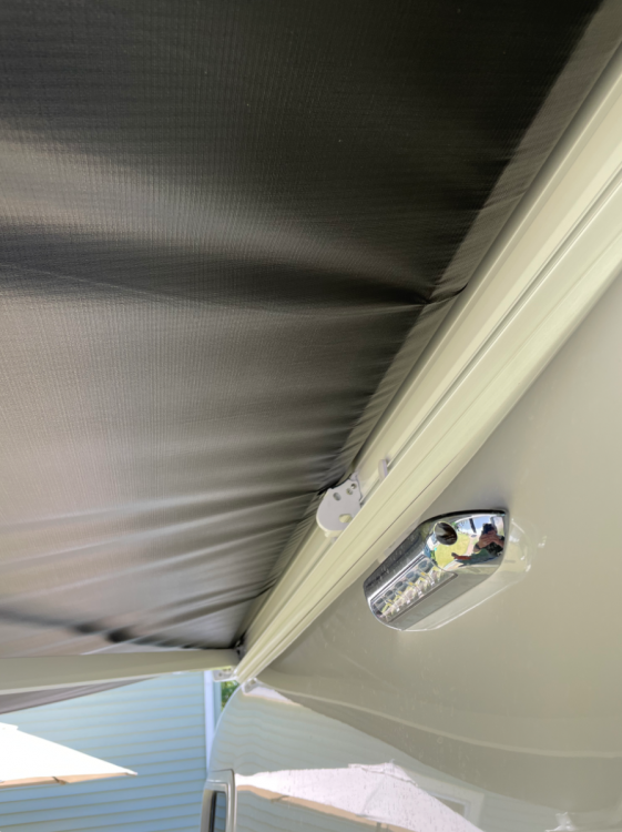

LongStride Posted June 17, 2021 Posted June 17, 2021 (edited) Is it commonplace for RV awning fabric to crease like this when they roll up? My guess is yes, but being a newbie I am unsure. Edited June 17, 2021 by Overland Fixed photos. Mike and Yasuko 2021 Legacy Elite Hull #820
Overland Posted June 17, 2021 Posted June 17, 2021 FYI, fixed the photos for you. I can't say that mine has ever done that, but I have a different awning (Carefree) and your fabric doesn't look as stiff as mine.
LongStride Posted June 17, 2021 Author Posted June 17, 2021 Thank you for your response. I have the new Girard and the fabric is relatively thin and very flexible. When fully extended the wrinkles disappear. I am just curious to know if other new owners are experiencing the same thing. Mike and Yasuko 2021 Legacy Elite Hull #820

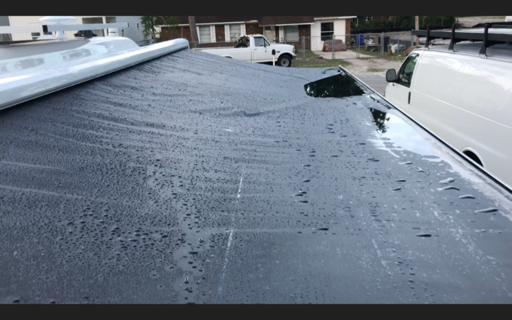

georgelewisray Posted June 18, 2021 Posted June 18, 2021 Awning Wrinkles: Suggest contact Girard :: " May I please speak to someone in technical support" No good reason to have such wrinkles . . . . fabric was not pulled tight when installed on/in the roller. To try and understand what's up . . . See excerpt below from pp43 of manual for our Girard GG750 , which is the cheaper of the 2021 Oliver awnings. Note that the fabric on the GG750 is apparently different from the fabric on the fancier model. Different Awning Issue: Our fabric is bagging and because of the water ponding it so far seems nearly unusable in any rain at all unless extended fully so as to better drain, which is scary with out a method to secure/support in case of wind gusts. It was my fondest hope that the awning could be used in the rain when extended about 3 to 4 feet of the 7 ft total extension but even with such a modest extension it creates heavy ponds that stretch the fabric and when it is rolled in the pond dumps right at the front door. I need to call Girard 'tech support' myself and have my expectations calibrated. ********************************************* Awnings: 949-259-4000 . 800-382-8442 The Girard Group 1361 Calle Avanzado San Clemente, CA 92673 ********************************************* Manual for GG750 Girard : pp43 C. INSTALLING THE NEW FABRIC IMPORTANT: REPLACEMENT FABRICS ARE ROLLED AND FOLDED FOR SHIPMENT. THE SEAMS MUST FACE DOWNWARDS AS THE FABRIC IS INSTALLED. THERE IS A SMALL WHITE POLY (POLYESTER) ROPE INSERTED IN THE FABRIC THAT WILL SLIDE INTO THE LEAD RAIL. The old fabric's trim insert will need to be removed from the roller tube, it is held on by clear tape along the length of the tube and black duct tape on each end. Take note of how the trim insert sits in the channel of the tube as the new fabric trim insert will need to be inserted correctly and then taped in the same fashion as the existing insert was attached. With the new fabric attached to the tube, roll up the fabric as even and tight as you can in the correct direction. (The fabric should roll from the bottom of the tube when the awning is extending) Slide the tube with the motor and fabric assembly back into the case of the awning as it came out. Confirm the non motor side of the roller tube is correctly in the bushing that is mounted on the non motor side endplate. 3. Repeat steps 1-10 of motor installation section B. ********************************************* 1 'There is so much good in the worst of us, and so much bad in the best of us,it doesn't behoove any of us to speak evil of the rest of us' > 2021 OTT EII , TAB Teardrop has good home after 10,000 miles of pleasant learning <
Moderators SeaDawg Posted June 18, 2021 Moderators Posted June 18, 2021 I talked about this, in another thread. Rv awnings are principally designed only for shade, not rain. The old school manual awnings can handle some light to moderate rain, but even those stretch over time. We stretched ours, an older dometic made by fiamma, manual awning, using it in the rain. . I take full responsibility. We replaced it three or four years ago. Because the manual awnings can achieve more pitch to spill the water, we still use ours in light to moderate rain. I know it may suffer the same stretch as the old one. And, I'll live with the consequences if/when it does . I wouldn't do that with an electric awning. The rvs we deliver to Alaska have electric awnings. We Always roll it in if it rains . 2 2008 Ram 1500 4 × 4 2008 Oliver Elite, Hull #12 Florida and Western North Carolina, or wherever the truck goes.... 400 watts solar. DC compressor fridge. No inverter. 2 x 105 ah agm batteries . Life is good.
Overland Posted June 18, 2021 Posted June 18, 2021 I think it largely comes down to the fabric. I can’t say enough good things about the Recaril fabric that we special ordered for our Carefree awning, as it has far exceeded our expectations. It stays taut and doesn’t pool water in even heavy rains and we don’t even have to slope it to the side for it to do so. So far it’s shown no sign of fading or stretch. It’s unlike the sunbrella fabrics that I’ve had experience with, in that has the look and feel of a very stiff, tightly woven canvas. 2

LongStride Posted June 18, 2021 Author Posted June 18, 2021 georgelewisray, thanks for the detailed info on the GG750. I think the problem is with the fabric. It was partly sunny with scattered clouds on delivery day when we deployed our awning. Did not notice any wrinkles or creases then. The issue appeared yesterday under hot blistering sun. The fabric is black and I believe it sagged from the heat causing slack when rolling it back up. Cool out this morning with cloud cover (thunderstorms last night). I deployed the awning and now that the fabric is cool, when I retracted it the creasing was minimal. Much much better than when it was hot. Given that the primary function of the product is a sunshade, it seems that a fabric that does not sag under its own weight when it get hot may have been a better choice. Minor annoyance that is of no urgency, but I will investigate fabric options. 1 Mike and Yasuko 2021 Legacy Elite Hull #820

georgelewisray Posted June 18, 2021 Posted June 18, 2021 WRINKLE UIPDATE :: (1) We have similar wrinkles when rolling up after full awning extension in hot sun. Hot Sun and dark thin vinyl coated fabric >> wrinkles . . . . Who Knew ??? and so it seems I was wrong about it being an installation tensioning issue. (2) Fabric: The dark brown fairly thin seeming vinyl coated fabric used on our Girard GG750 is nothing like the Sunbrella by Raven Mills that I have been around constantly over many years of sailboat deliveries. I am encouraged to hear about more suitable/heavier fabrics and at some point we may upgrade to end up with a truly useable awning. Oliver in this case is just following industry common practice so in my mind, in this case they are off the hook and I will not grumble in their direction. I do wonder about ZipDee awning as a possible superior option. Airstream has stuck with ZipDee for decades and decades. 'There is so much good in the worst of us, and so much bad in the best of us,it doesn't behoove any of us to speak evil of the rest of us' > 2021 OTT EII , TAB Teardrop has good home after 10,000 miles of pleasant learning <
LongStride Posted June 18, 2021 Author Posted June 18, 2021 According to Girard's website the GG750 is offered with a vinyl coated fabric or with a woven polyester made by O'Bravia. I have inquired Girard to see if Sunbrella is available as a replacement fabric for the GG750 since they list it in their homepage dropdown menu under fabrics. I will post their response after they get back to me. The wrinkles and creases when retracted in the hot sun do not detract from the awnings performance as a sunshade, and I don't think that it should be of concern to someone looking to purchase an Oliver. However, it would be nice if the O'Bravia fabric were an option on the build list. Although not quite the caliber of Sunbrella or Recacril, I would imagine that it performs much better than the vinyl. If the vinyl causes a functional issue or begins to look unsightly I will replace it with 100% acrylic. Until then, I will continue to enjoy my awning (wrinkles and all) now that I know that it is not an isolated issue specific to my awning alone. Mike and Yasuko 2021 Legacy Elite Hull #820
