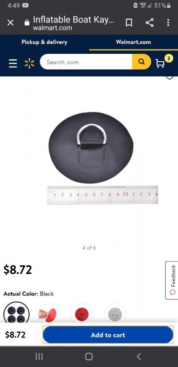

Maybe you could try some self-adhesive d-ring patches, made for kayaks and inflatables, and a short length of parachute cord, or stiff shock cord? One on the bottom of the door, one on the side or bottom of the fridge to make a short retaining cord.
I  think your bubble on the front could be off a bit. (Ours often is.) Sounds like you may be a bit low in front, if the door swings so rapidly toward the entry. A few inches lift on the nose keeps you well within 6 degrees, btw. We do this, too, as others do. We often lift it a tiny bit on the road side, as well. It's all about what makes you (and the fridge) comfortable. The road/port side is where our heads are, sleeping.
I'll look in to these..I know how crazy expensive the parts are for Dometic.  Having a stretchy bungey between these might just work!
