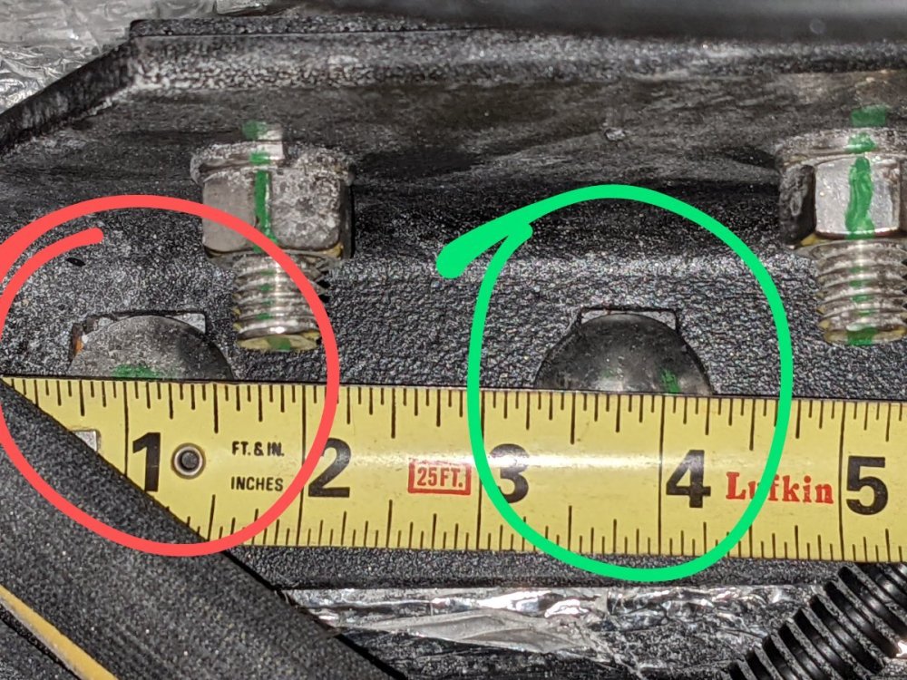

@Corvus, yes, the same situation. I was able to stop the creaking at home by adjusting the aluminum "collar" under the trailer. Pretty proud of myself. Then we moved to a campground... Right back to creaking again. 😑 It does sound like rubbing on the fiberglass hull to me. Complicating matters: the rectangular hole in the mounting bracket under the bed was cut too large. (These appear to be cut by hand!)  As a result, the head of the carriage bolt "strips out" in the hole, so I can't torque that nut to the required 43 ft lb. When I get above 28 ft lb on that nut the carriage bolt turns in the bracket hole. 913275736_PXL_20220727_2107327772.thumb.jpg.2caff73ec3c0404659eb57cf54674d19.jpg

Stripped carriage bolts ….. darn it! Drill or grind the heads off, completely. Drive the shanks down and out the bottom with a brass drift. Replace them with hex head bolts and thick washers. Perhaps an hour’s labor IF you have good access up top. Oliver should definitely cover the repair! They are stainless, not that hard to drill, as you discovered when the square heads rounded off. (I have snapped a seized 1/2” bumper bolt into pieces with a regular breaker bar, to wasn’t TOO difficult.)
Hand cut square holes? That seems overly primitive for a factory, but these are special jacks I think, so that bracket defect probably is the jack manufacturer’s fault.

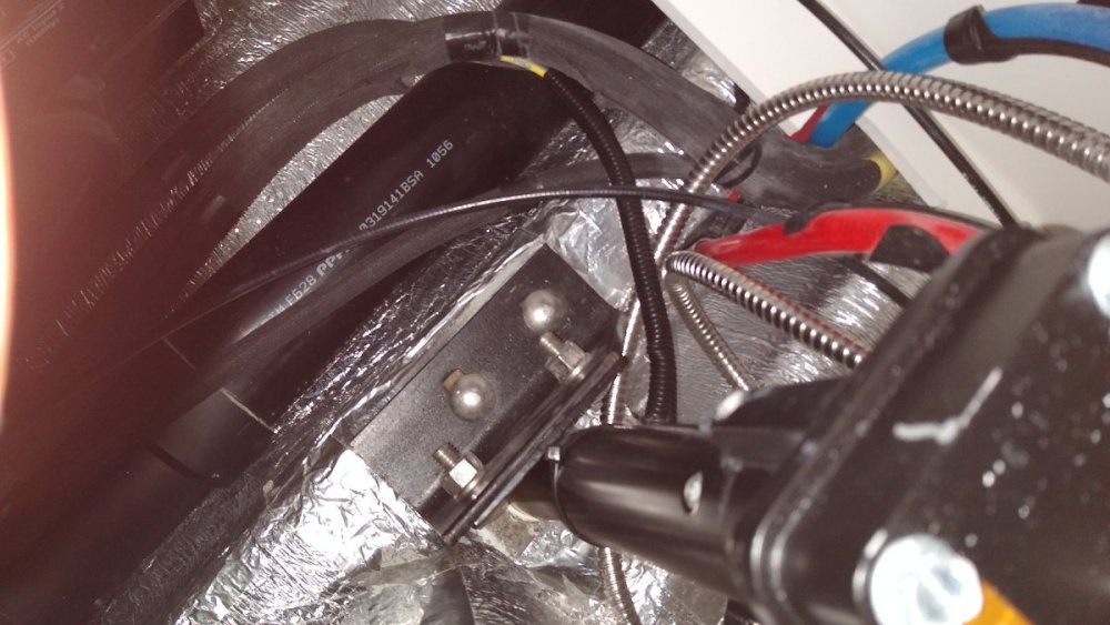

Yikes, sorry to hear that. I can't check mine at the moment but the photo I took shows the holes are oversized. It also looks like my bracket may have shifted which may be the issue. I'll look into this closer first so thanks for posting this information.
Edit: Oh rats! John just pointed out this is a photo of my street side bracket, the creaking is on the curb side. I'll leave it since it does give an idea of how large the hole is.

Corvus, this is just a FYI, it is not a big deal:
Your silver shower hose loops around the dump cable. If you want to gain another foot or two of extension, reroute it so that all of the hose is on the same side, that way the cable won’t stop it prematurely. You will need to unscrew the hose at one end. That is kind of a weird setup, the hose just flops around among all the other parts. I have been trying to think of a way to retain it, a net bag for example…. for water drainage; any ideas?

Thanks John, I'll check it to make sure I didn't leave it that way. I experimented with a longer hose at one time so that was probably me not the factory. Something about that image was off but I guess I was too focused on the bracket to realize it's the street side bracket, the creaking is on the curb side.
The longer hose did not work out well for me. No good ideas yet on how to manage the hose with this system. I was hoping someone would find an upgrade for the outdoor water system and post a how-to about it.
